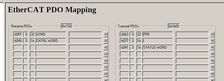

hello,
I am struggling around setup a ethercat driver for working in CSP. I found some commands which are different then others in this topic. Is it my .xml code right please?
Have anybody idea of red rectangles in the picture please? Other stuff is clear to me.
Regards foxington
