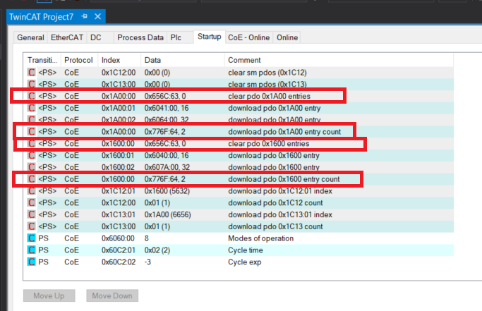

11 Nov 2025 18:01 #338199
by ruediger123
Replied by ruediger123 on topic Ethercat HAL driver
- Hakan
- Posts: 1317
- Thank you received: 454
11 Nov 2025 18:30 #338205
by Hakan
Replied by Hakan on topic Ethercat HAL driver
The array data types are not implemented in linuxcnc-ethercat.
Not 100% sure about IgH Ethercat master.
