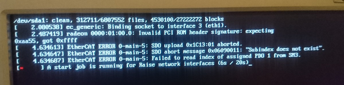

22 Feb 2020 18:59 #158228
by jirkam
Replied by jirkam on topic Ethercat HAL driver
Hi
Maybe the problem is here?
- Posts: 21890
- Thank you received: 7463
22 Feb 2020 19:53 #158230
Replied by tommylight on topic Ethercat HAL driver
The first error is regarding an AMD Radeon graphic card, most probably a flashed card used for mining.
The last error is most probably due to an invalid entry in the /etc/fstab, usually searching for a partition that was there during install and now missing. A quick fix for that would be to edit the /etc/fstab and omit all the lines under the main partition line, save and reboot.
