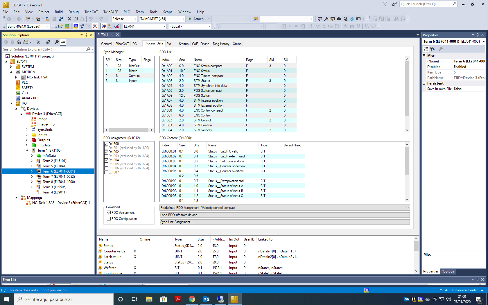

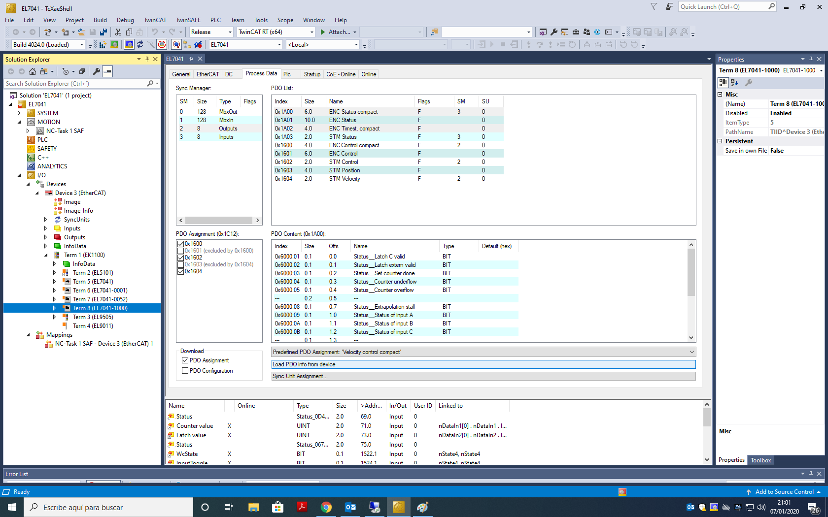

Chimeno,
Thanks for adding the brake chopper... super awesome. I was looking at these for the future.
I have a request as you are verse in re-working the code. Can you add the EL7041-0000. I cannot get it to work, I have tried changing my XML with:
EL7041-1000
EL7041-0000
EL7041-
EL7041
but none of those work. I can see the terminal in C-command when doing a "# ethercat slaves" , but when you try to start LinuxCNC it gives the error screen with this in the debug:
lcec_conf: ERROR: Invalid slave type EL7041-0000
lcec_conf: ERROR: Parse error at line 6: parsing aborted
I know my HAL and INI should be fine in LNC as I have other Beckhoff setup's that work, just can't get this setup to work with the EL7041-0000. So I figured you might be able to get this terminal working also as you have fixed the code for several of the other terminals in the past.
Thanks,
Robert

- chimeno
- Posts: 295
- Thank you received: 125
07 Jan 2020 19:19 - 07 Jan 2020 20:05 #154237
by chimeno
Replied by chimeno on topic Ethercat HAL driver
Hi Corbett,
Thank you very much for everything, just try to have a good time fun and share it with you, many times it is difficult to program things without having much knowledge, for the chopper module if you use it you will have to load the configuration file for the work stress levels.
For the question you have about this error lcec_conf: ERROR: Analysis error on line 6: aborted analysis, it is simply that you should have a misspelling in the configuration .xml file, can you check if it is like this?
if you want you can publish your .xml file and we take a look
Ideally, configure EL7041 using TWINCAT3
if you can add the EL7041-0000, no problem
The EL7041-0001 and EL7041-1000 have the same generic PDO pre-defined, it should work without problems.
Greeting
Chimeno
<slave idx = "1" type = "EL7041-1000" name = "EL7041" />if you want you can publish your .xml file and we take a look
Greeting
Chimeno
Last edit: 07 Jan 2020 20:05 by chimeno. Reason: more information
