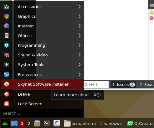

I use this version after it was released:
sourceforge.net/projects/linux-11-pro/
It has a "skynet software installer" in the system menu. This will install additional software like lcnc, ethercat etc.
It uses this mirror:
github.com/grotius-cnc/Linux-Pro/releases/tag/1.0.0
If you look inside the deb package for pre-install or post-install files (scripts), you can see how it's installed.
github.com/grotius-cnc/Linux-Pro/release...inuxcnc-ethercat.deb
** works just as OS installation and after run script to afterinstall the ethercat but it was just with "generic" drivers supported...
If you are using iso's from grotius, check the crontab -e to change the generic driver in something else.
# In terminal : $ crontab -e
@reboot echo MASTER0_DEVICE="$(cat /sys/class/net/enp0s25/address)" DEVICE_MODULES=generic > /etc/sysconfig/ethercat
# Slow down the process so above line is done before the restart.
@reboot /opt/ethercat/script/init.d/ethercat start
@reboot /opt/ethercat/script/init.d/ethercat stop
@reboot /opt/ethercat/script/init.d/ethercat restart

Hi Foxington,
1. I will install linux from your hybrid iso... => sourceforge.net/projects/linux-11-pro/fi...nux-Pro.iso/download
2. after I hit install ethercat installer from desktop => In the menu click on : skynet software installer
This will take a while.
3. then in terminal will run => # crontab -e ( # is as superuser "sudo" , $ is user)
Crontab is just a tiny program that is active during pc startup. I used it to start up the ethercat bus. And it set's the mac adress
at boot time. Nothing can really go wrong here. If there is a fault it will pass without you notice it.
Lets tear this down :@reboot echo MASTER0_DEVICE="$(cat /sys/class/net/enp16s0/address)" DEVICE_MODULES=8139too > /etc/sysconfig/ethercat
A specific crontab command:
@reboot
This will give you the mac adress in return, you can also replace it with another command as long it returns the mac adres :
For example, you can write a tiny script:
echo MASTER0_DEVICE="$(givemymac.sh)"
Your driver, generic, or something else like :
This ">" will overwrite everything at the destiny. ">>" is for append.
The reason i mentioned you the crontab -e. Is that if you want to change the generic driver in something else, you have to
know something is done at boot time.
