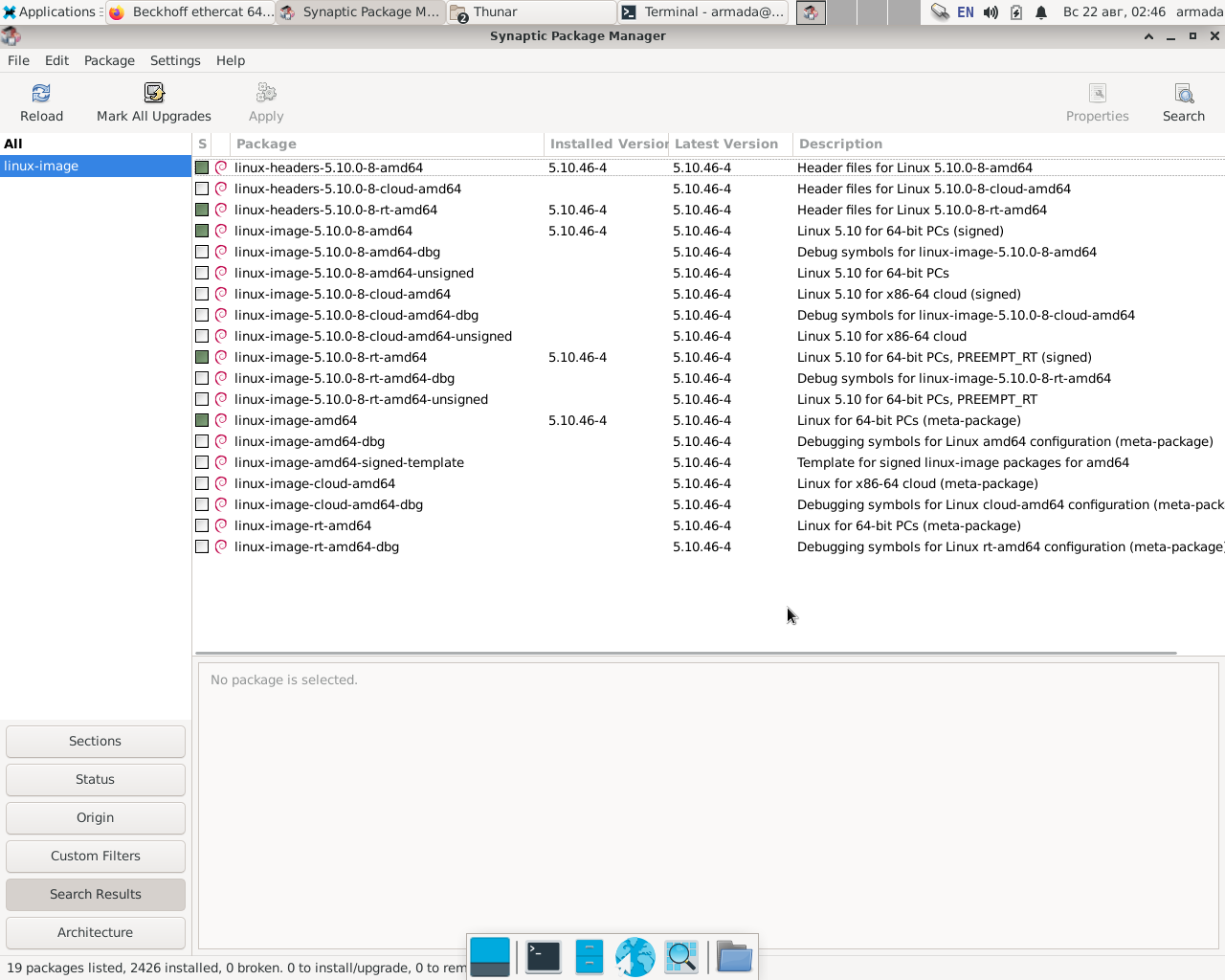

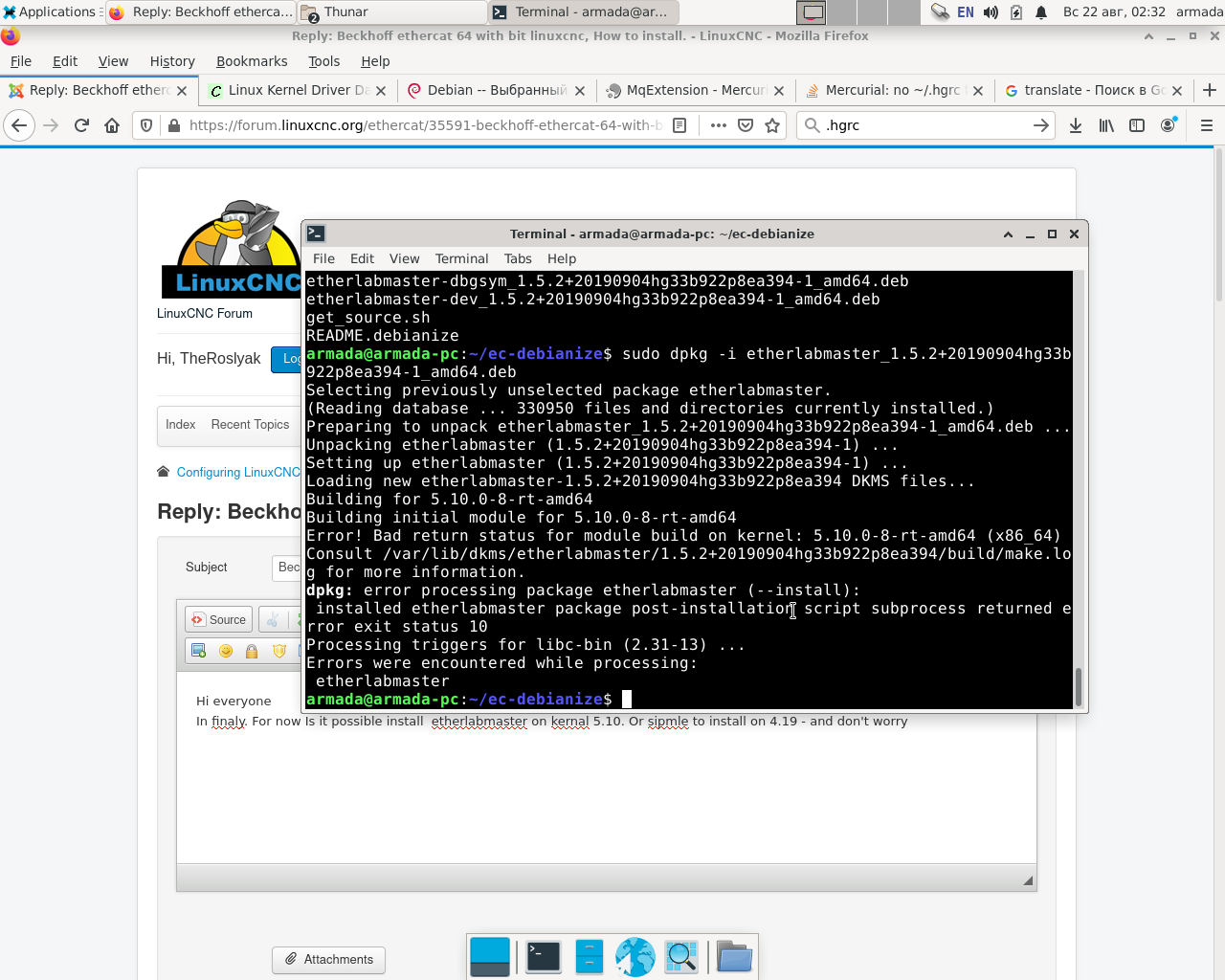

Hi everyone
In finally. For now Is it possible install etherlabmaster on kernel 5.10? Or simple to install on 4.19 - and don't worry?
- Grotius
- Posts: 2419
- Thank you received: 2349
21 Aug 2021 18:39 #218356
by Grotius
Replied by Grotius on topic Beckhoff ethercat 64 with bit linuxcnc, How to install.
Did you install the kernel headers?
- TheRoslyak
- Posts: 238
- Thank you received: 37
21 Aug 2021 18:48 #218358
by TheRoslyak
Replied by TheRoslyak on topic Beckhoff ethercat 64 with bit linuxcnc, How to install.
of course yes

21 Aug 2021 18:48 - 21 Aug 2021 18:53 #218359
by Grotius
I think you have the wrong headers. I run the same kernel. I install by hand:
packages.debian.org/bullseye/kernel/linu...s-5.10.0-8-common-rt
packages.debian.org/bullseye/kernel/linu...rs-5.10.0-8-rt-amd64
packages.debian.org/bullseye/linux-compiler-gcc-10-x86
packages.debian.org/bullseye/linux-kbuild-5.10

21 Aug 2021 19:00 - 21 Aug 2021 19:34 #218361
by TheRoslyak
I install same package. Only by synaptic.
I honestly did not see in how to installed ec-debianize. I always use guide on 4 page of this topic Install and all is working.

21 Aug 2021 19:41 #218367
by Grotius
Some time ago there was a little change for the ethercat-master install process.
On this page there are recent install's to find.
github.com/grotius-cnc/Linux-Pro/release.../ethercat-master.deb
Tested on : sourceforge.net/projects/linux-11-pro/ kernel : Linux debian 5.10.0-5-rt-amd64
