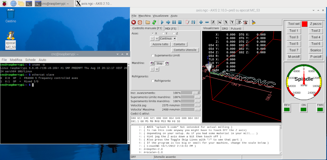

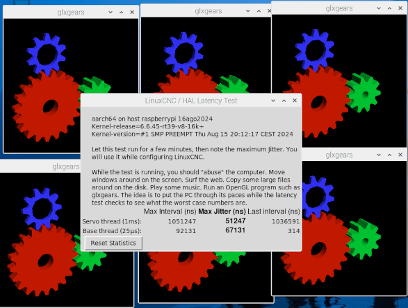

16 Aug 2024 09:49 #307904
by jjdege
Replied by jjdege on topic Ethercat installation from repositories - how to step by step

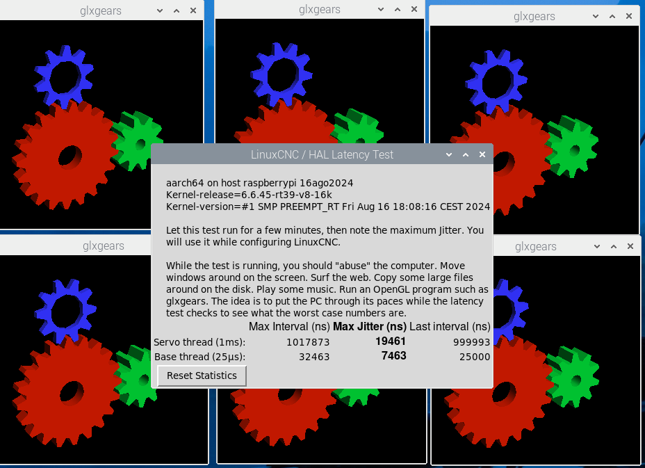

Hi
after installing the official LinuxCNC ISO for Raspberry Pi 5
I realized that the screen resolution is not good,
it is not manageable and there is no audio,
it will surely be fixed.
so I tried installing LinuxCNC + EtherCAT on native Raspberry OS
I installed kernel 6.6.45-rt39-v8-16k+ with inspiration from here
for EtherCAT drivers I entered the keys for the repositories from here
and followed Rod's guide here here
Everything works
latency, maybe a little high
I was wondering if it depends on the kernel and if it is possible to modify it in some way
many Thanks
Everything works
many Thanks

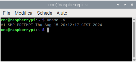

- Posts: 12156
- Thank you received: 4149
16 Aug 2024 10:41 #307906
Replied by rodw on topic Ethercat installation from repositories - how to step by step
what does uname -v report?
Seems you don;'t have a RT kernel
The following user(s) said Thank You: jjdege
- jjdege
- Posts: 129
- Thank you received: 38

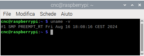

16 Aug 2024 12:30 - 16 Aug 2024 12:32 #307912
by jjdege
Last edit: 16 Aug 2024 12:32 by jjdege.

16 Aug 2024 13:34 - 16 Aug 2024 13:39 #307916
by elovalvo
If you want instructions to create a PREEMPT_RT for Raspberry Pi 5 with native Raspberry OS you can see at this link
forum.linuxcnc.org/9-installing-linuxcnc...pi-5?start=40#303696
or use the ready-made image you find here
forum.linuxcnc.org/9-installing-linuxcnc...pi-5?start=40#303752
Then follow the procedures already described for Ethercat drivers
Replied by elovalvo on topic Ethercat installation from repositories - how to step by step
hi
here is the report with uname -v
no RT, yet it works, something went wrong
which kernel is working?
Last edit: 16 Aug 2024 13:39 by elovalvo.
- Posts: 21986
- Thank you received: 7486
16 Aug 2024 15:47 #307934
Replied by tommylight on topic Ethercat installation from repositories - how to step by step
Latency is OK, so the kernel should work just fine.
No idea if it works for EtherCAT though, although in general should work if the same headers are used.

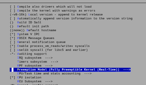

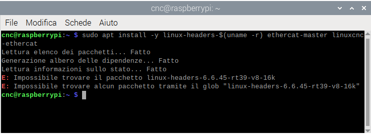

- Posts: 129
16 Aug 2024 18:55 #307956
by jjdege
Thanks so much!
in the meantime
i tried to understand what went wrong and i found the reason,
i skipped a step in menuconfig
with that step the compilation of the RT kernel was successful
the latency is now very ok
unlike the installation of the EtherCAT packages that gives me an error
i don't know what it depends on, maybe we need to wait for Etherlab to update the repositories
in the meantime
- Posts: 21986
16 Aug 2024 23:02 #307971
Try installing those one by one.
