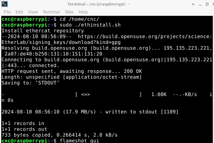

Hello,
Is it possible to install ethernet for raspbery pi? Are the iso files up to date ?
- Posts: 12178
- Thank you received: 4155
08 Aug 2024 14:37 #307276
Replied by rodw on topic Ethercat installation from repositories - how to step by step
The Raspberry pi images do not include the Ethercat repositories but enabling some commented out code should enable it according to feedback from etherlabmaster
Try running a script something like this
#!/bin/bash
# Install companion repositories. NOTE: QTPYVCP does not support the raspberry pi.
echo "Install ethercat repository"
mkdir -p /usr/local/share/keyrings/
wget -O- https://build.opensuse.org/projects/science:EtherLab/signing_keys/download?kind=gpg | gpg --dearmor | dd of=/etc/apt/trusted.gpg.d/science_EtherLab.gpg
tee -a /etc/apt/sources.list.d/ighvh.sources > /dev/null <<EOT
Types: deb
Signed-By: /etc/apt/trusted.gpg.d/science_EtherLab.gpg
Suites: ./
URIs: http://download.opensuse.org/repositories/science:/EtherLab/Debian_12/
EOT

08 Aug 2024 14:49 #307277
yes tested it works on my chromebook so it should work on any device Ethercat supports. Shame it does not have an Ethernet port
copy text to a file. call it ethinstall.sh and make it executable:
chmod +x ethinstall.sh
./ethinstall.sh
The following user(s) said Thank You: Moutomation, Macwolf

- Shemmers
- Visitor
10 Aug 2024 05:15 - 10 Aug 2024 05:15 #307410
by Shemmers
Replied by Shemmers on topic Ethercat installation from repositories - how to step by step
Hi Rodw, Thanks for all the incredible work so far on EtherCAT. I'm diving into both LinuxCNC and EtherCAT right now and excited by the possibilities.
I ran into the same issues as discussed. I tried your script on the Rpi 5 and it seemed to connect to their servers but it only seems to have grabbed 733 bytes. I may try some of the other methods mentioned previously.
___
System: Raspberry pi 5 + Leadshine EL8 EtherCAT drives
LinuxCNC level: first timer
Linux level: noob noob
___
Last edit: 10 Aug 2024 05:15 by Shemmers.
- Posts: 12178
10 Aug 2024 14:47 #307434
The script just adds the Ethercat repositories/
Just folllw the steps in post 1 to install Ethercat.
