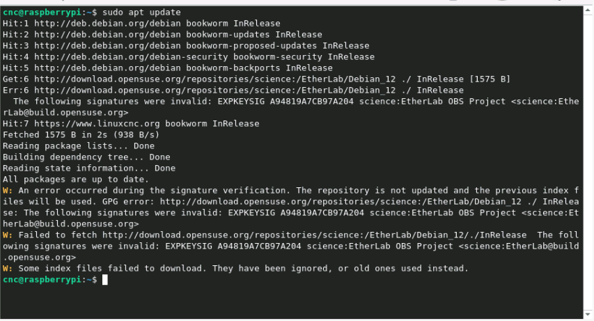

- seyad
- Posts: 23
22 Aug 2024 10:14 #308379
by seyad
Replied by seyad on topic Ethercat installation from repositories - how to step by step

24 Aug 2024 14:26 - 24 Aug 2024 15:39 #308537
by Sandro
Replied by Sandro on topic Ethercat installation from repositories - how to step by step
Hello everyone
I am getting the same error with a new install of LCNC 2.9.3 on amd64. (Also affects my 2.9.2 install)
sudo apt update
W: An error occurred during the signature verification. The repository is not updated and the previous index files will be used. GPG error: download.opensuse.org/repositories/science:/EtherLab/Debian_12 ./ InRelease: The following signatures were invalid: EXPKEYSIG A94819A7CB97A204 science:EtherLab OBS Project
W: Failed to fetch download.opensuse.org/repositories/scien...ebian_12/./InRelease The following signatures were invalid: EXPKEYSIG A94819A7CB97A204 science:EtherLab OBS Project
W: Some index files failed to download. They have been ignored, or old ones used instead.
sudo apt install linuxcnc-ethercat
[code]E: Failed to fetch download.opensuse.org/repositories/scien...0bca-1%2b3.1_all.deb 404 Not Found [IP: 195.135.223.226 80]
E: Failed to fetch download.opensuse.org/repositories/scien...ca-1%2b3.1_amd64.deb 404 Not Found [IP: 195.135.223.226 80]
E: Unable to fetch some archives, maybe run apt-get update or try with --fix-missing?
Etherlab repository not valid anymore? Any ideas?
Edit: I have found rods image here which works:
drive.google.com/file/d/1gEQzgHsj_LjHiGB...k1Z/view?usp=sharing[/url
sudo apt update
Last edit: 24 Aug 2024 15:39 by Sandro.
