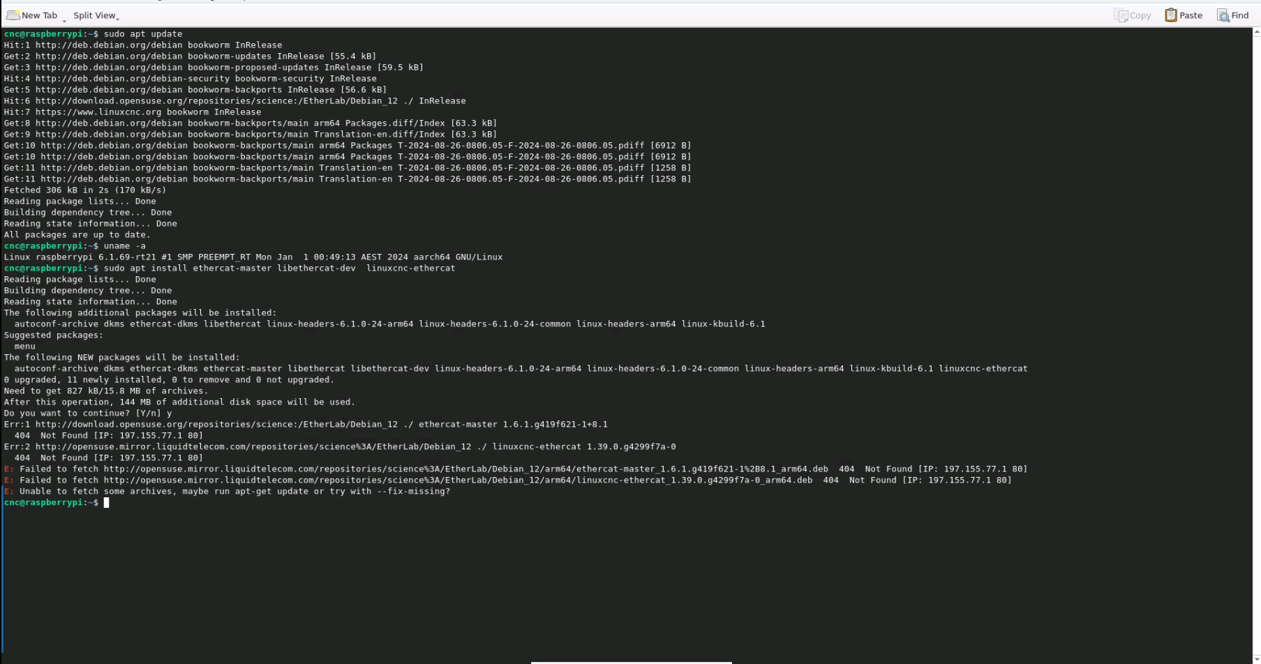

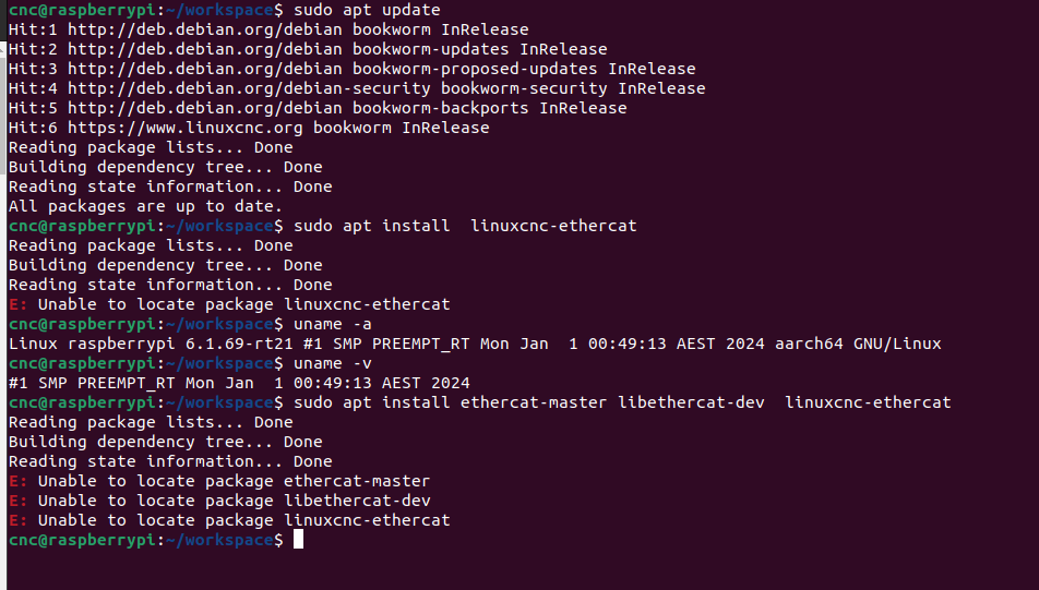

- seyad
- Posts: 23
26 Aug 2024 00:49 #308661
by seyad
Replied by seyad on topic Ethercat installation from repositories - how to step by step
- Posts: 12178
- Thank you received: 4155
26 Aug 2024 01:12 #308666
Replied by rodw on topic Ethercat installation from repositories - how to step by step
try this script
forum.linuxcnc.org/ethercat/45336-etherc...tep?start=250#307276

- seyad
- Posts: 23
26 Aug 2024 04:40 - 26 Aug 2024 05:57 #308684
by seyad
Last edit: 26 Aug 2024 05:57 by seyad.
- Posts: 12178
27 Aug 2024 03:31 #308779
Looks like ARM is not supported in their repo; You will need to compile from source

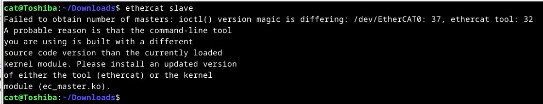

06 Sep 2024 12:35 #309514
by COFHAL
Replied by COFHAL on topic Ethercat installation from repositories - how to step by step
I have a question: I have already installed ethecat and linuxcnc-ethercat. With the command sudo systemctl status ethercat.service I see that the service is running. With the command ethercat master I try to see which master is configured and I get the error: Failed to obtain number of masters: ioctl() version magic is differing: /dev/EtherCAT0: 37, ethercat tool: 30
The question is: do I necessarily have to have a device connected that supports ETHERCAT to confirm that I have everything installed correctly, or why does this error appear and how to solve it?
