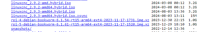

05 Aug 2024 16:46 - 05 Aug 2024 16:48 #307014
by AndyDM01
Replied by AndyDM01 on topic Ethercat installation from repositories - how to step by step
first ever trying to post something
after 12-13 times during my payed hours trying to install this i took home the shitty chinese computer and tried another 6-7 times... doesn't work
something it broken in the install

Posting mutliple times with the same question/issue does not help, nor does giving no info on what or where or how it is failing.after 12-13 times during my payed hours trying to install this i took home the shitty chinese computer and tried another 6-7 times... doesn't work
- Posts: 12166
- Thank you received: 4152
05 Aug 2024 21:52 #307035
Replied by rodw on topic Ethercat installation from repositories - how to step by step
The ISO has changed so you may have the broken one. Fixed in the last couple of days.
Download the iso from the downloads page and reinstall that.
It is tested and working.
