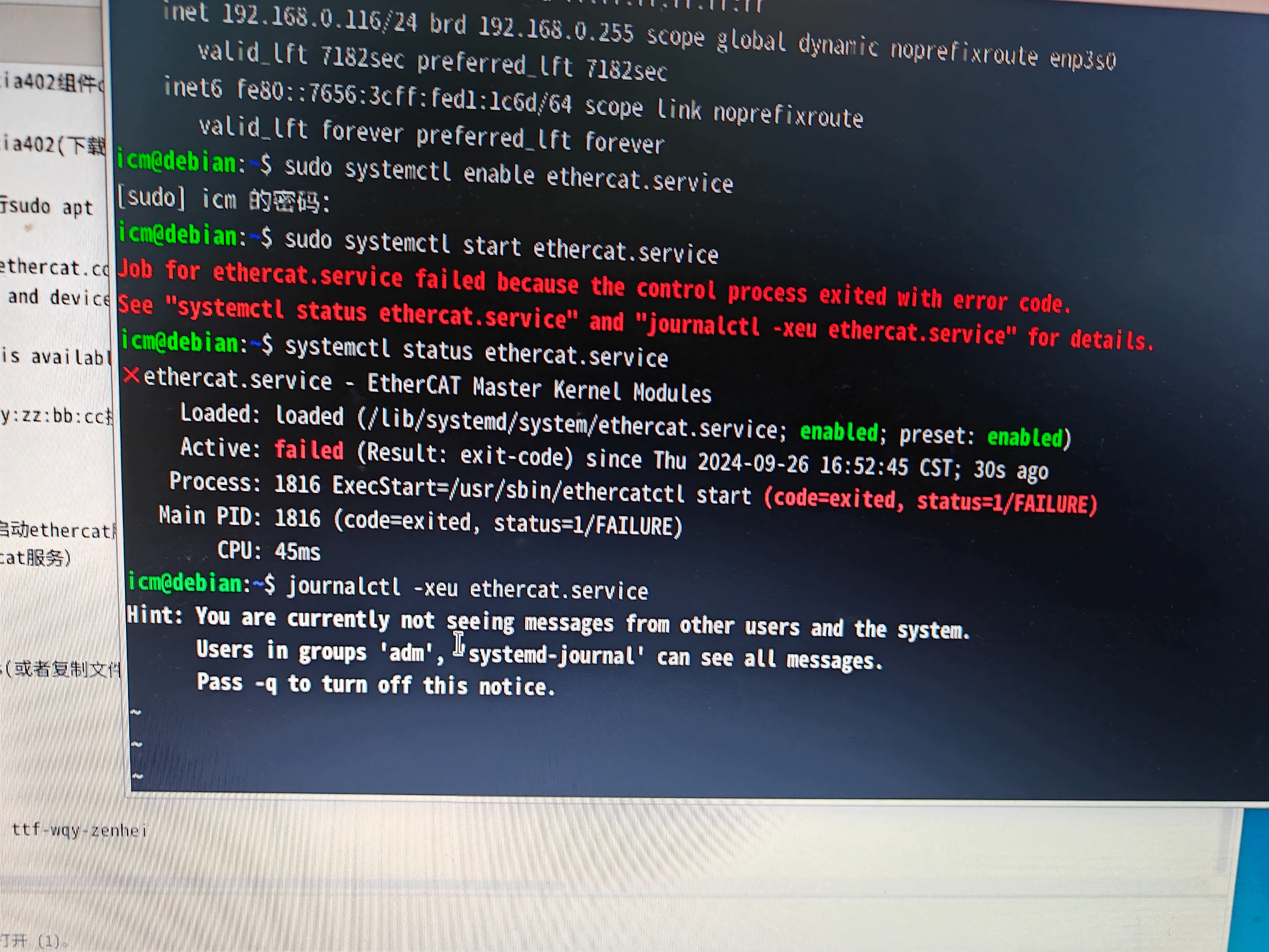

hello on my raspberry 5 come this Status
ethercat.service - EtherCAT Master Kernel Modules
Loaded: loaded (/etc/systemd/system/ethercat.service; enabled; preset: enabled)
Active: inactive (dead)
raspberrypi systemd[1]: Dependency failed for ethercat.service - EtherCAT Master Kernel Modules.
aspberrypi systemd[1]: ethercat.service: Job ethercat.service/start failed with result 'dependency'.
thank you
thank you

Figured it is time to update my outdated (but still working) instructions for my customers and to switch to Bookworm and a newer version of LinuxCNC, so I'm now running the LinuxCNC 2.9.3 Debian 12 Bookworm PREEMPT-RT ISO.
Next is installing EtherCAT so I started this step by step instruction but get stuck in the beginning.
edmuser@edmpc:~$ sudo apt update
[sudo] password for edmuser:
Hit:1 security.debian.org/debian-security bookworm-security InRelease
Hit:2 deb.debian.org/debian bookworm InRelease
Hit:3 deb.debian.org/debian bookworm-updates InRelease
Hit:4 repository.qtpyvcp.com/apt develop InRelease
Get:5 download.opensuse.org/repositories/science:/EtherLab/Debian_12 ./ InRelease [1,575 B]
Err:5 download.opensuse.org/repositories/science:/EtherLab/Debian_12 ./ InRelease
The following signatures were invalid: EXPKEYSIG A94819A7CB97A204 science:EtherLab OBS Project <science:EtherLab@build.opensuse.org>
Hit:6 www.linuxcnc.org bookworm InRelease
Fetched 1,575 B in 1s (1,603 B/s)
Reading package lists... Done
Building dependency tree... Done
Reading state information... Done
93 packages can be upgraded. Run 'apt list --upgradable' to see them.
W: An error occurred during the signature verification. The repository is not updated and the previous index files will be used. GPG error: download.opensuse.org/repositories/science:/EtherLab/Debian_12 ./ InRelease: The following signatures were invalid: EXPKEYSIG A94819A7CB97A204 science:EtherLab OBS Project
W: Failed to fetch download.opensuse.org/repositories/scien...ebian_12/./InRelease The following signatures were invalid: EXPKEYSIG A94819A7CB97A204 science:EtherLab OBS Project
W: Some index files failed to download. They have been ignored, or old ones used instead.

12 Oct 2024 05:48 #311856
Replied by rodw on topic Ethercat installation from repositories - how to step by step
There is another sticky to fix the expired security key
forum.linuxcnc.org/ethercat/53785-instal...repositories?start=0

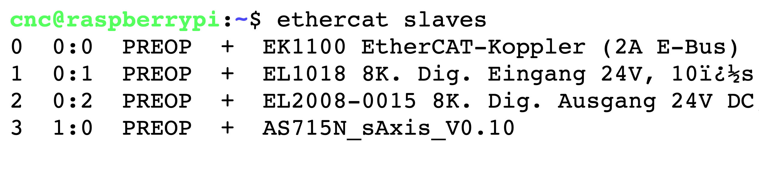

Since I am new to the topic of Ethercat, here is another question. I have now installed a servo( As715N) in my test series, but what is it written as in the ethercat-conf.xml
<master idx="0" appTimePeriod="1000000" refClockSyncCycles="-1">
<slave idx="1" type="EK1100"/>
<slave idx="2" type="EL1008"/>
<slave idx="3" type="EL2008"/>
<slave idx="4" type="AS715N"/>
is that right?
