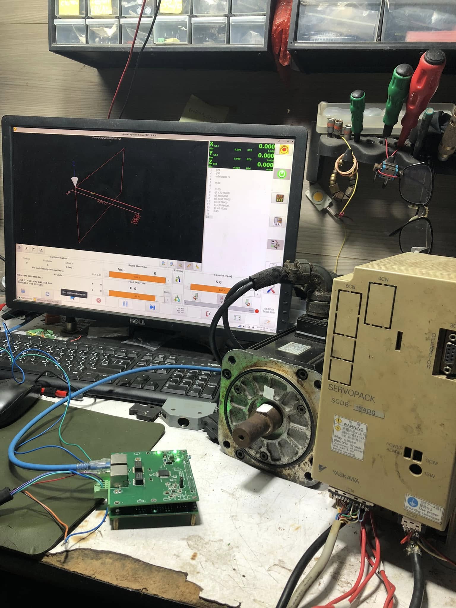

01 Dec 2024 10:42 - 01 Dec 2024 11:09 #315720 by SOLD
Replied by SOLD on topic AX58100
@Hakan Thanks for creating and sharing, I got the AX58100 working again. It's a very good project to share and learn. I've learned a lot from this project. It's a good starting point to learn how to create and use Ethereum by myself. There are some contents related to STM32 MCU, suitable for those who have no background. It works on VSCode, very beginner-friendly. I will update my board again.

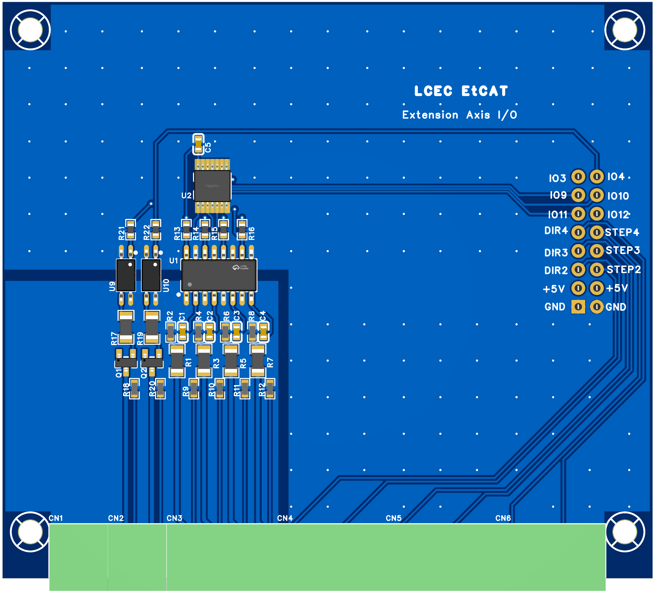

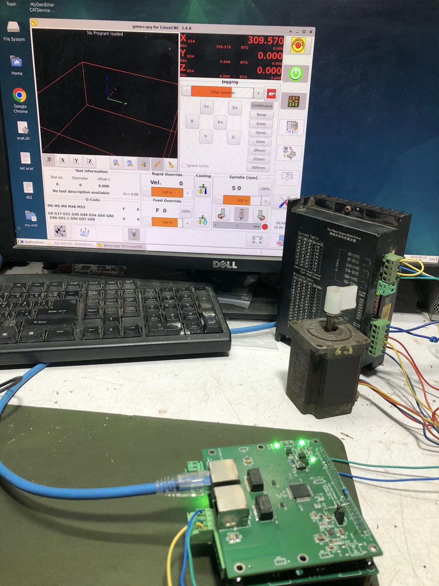

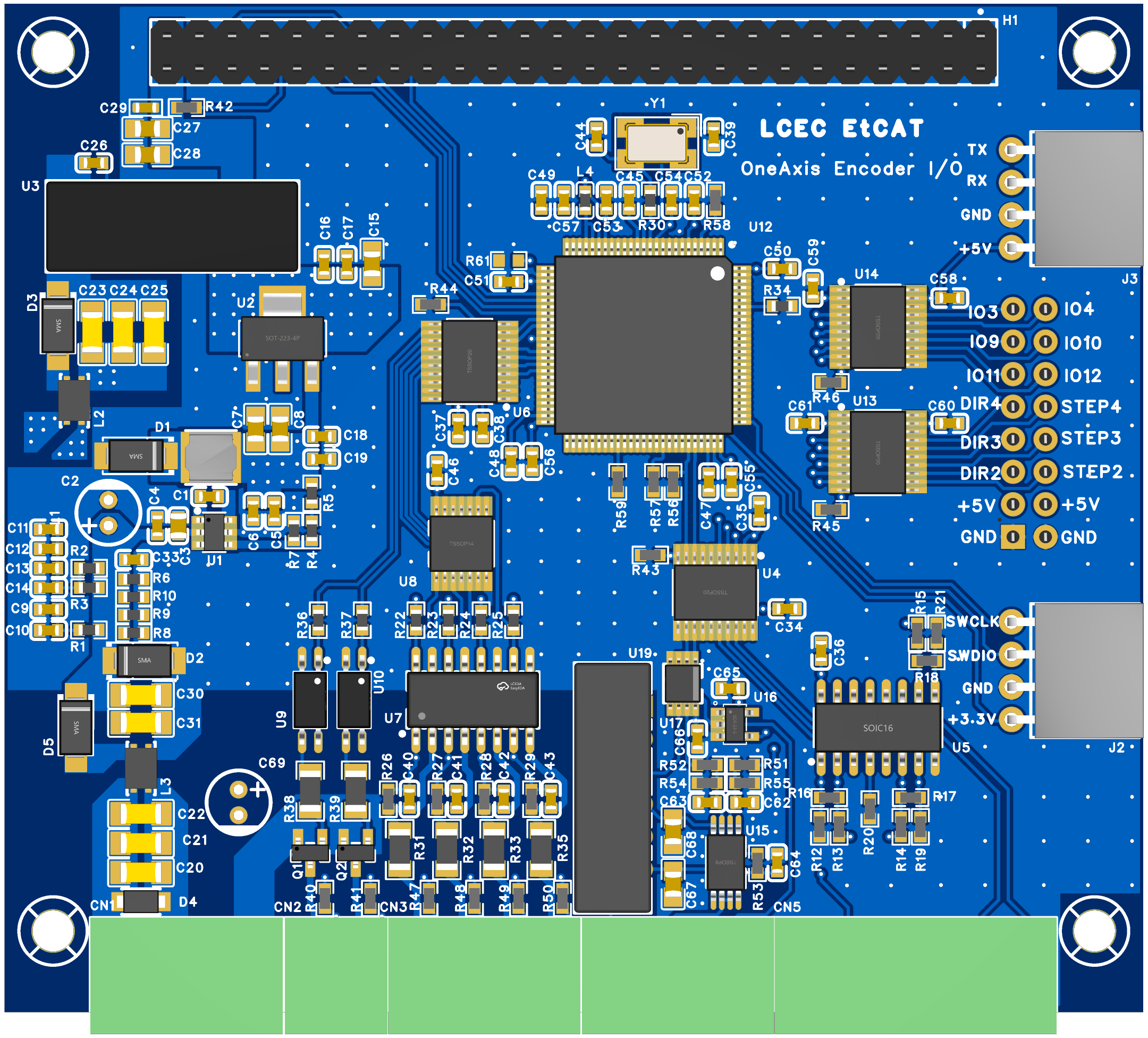

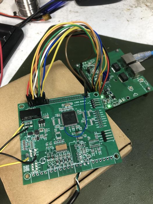

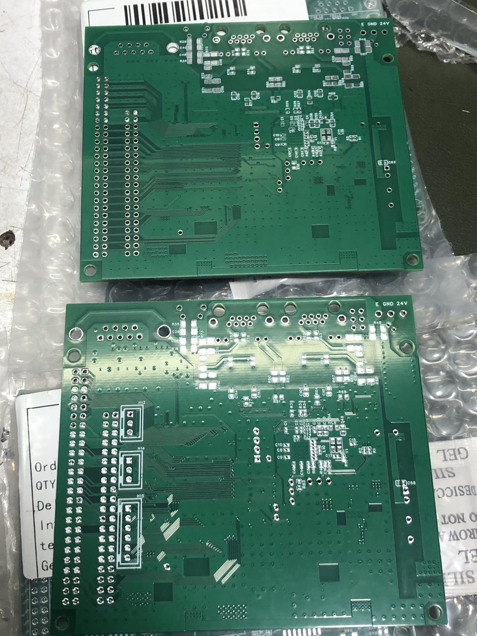

01 Dec 2024 10:59 #315721 by SOLD
This is the AX58100 SPI to STM32F407VGT6 connection test board with Axis and IO expansion board.
I haven't made it into 1PCB yet due to the price constraints of PCB size exceeding 100X100mm.
I'm adding the DAC Op-amp circuit and waiting for the test. Encoder connection.

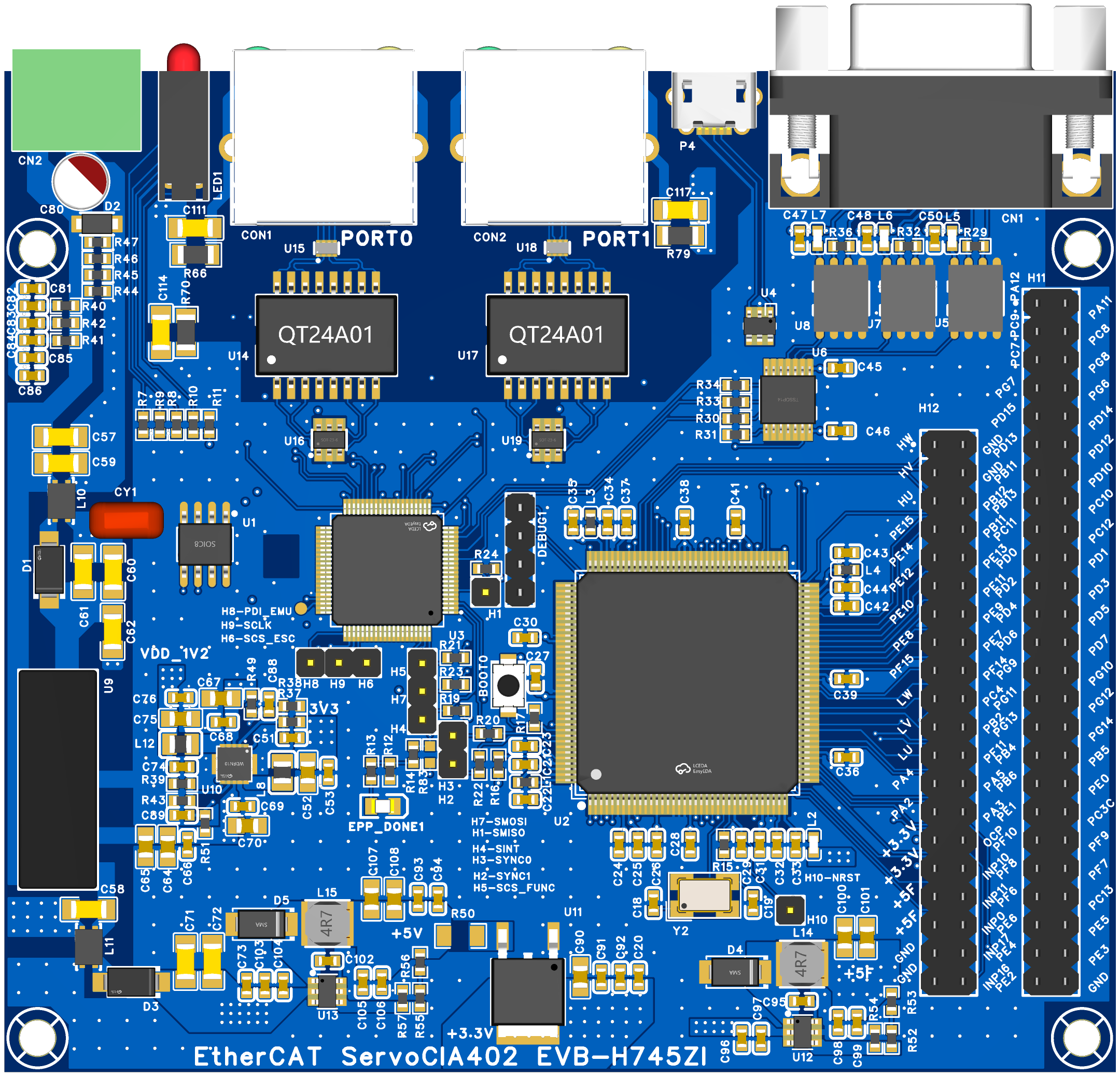

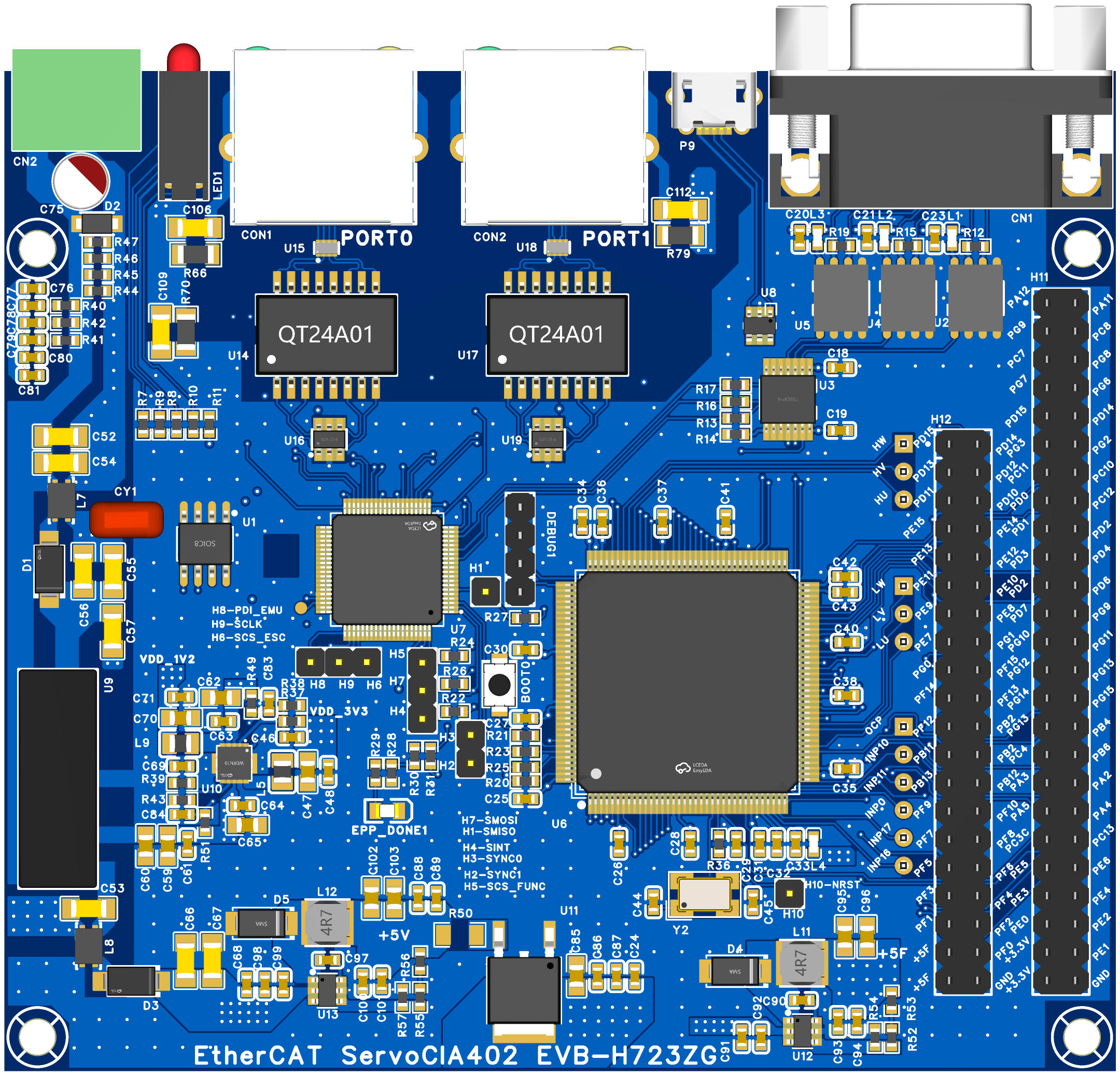

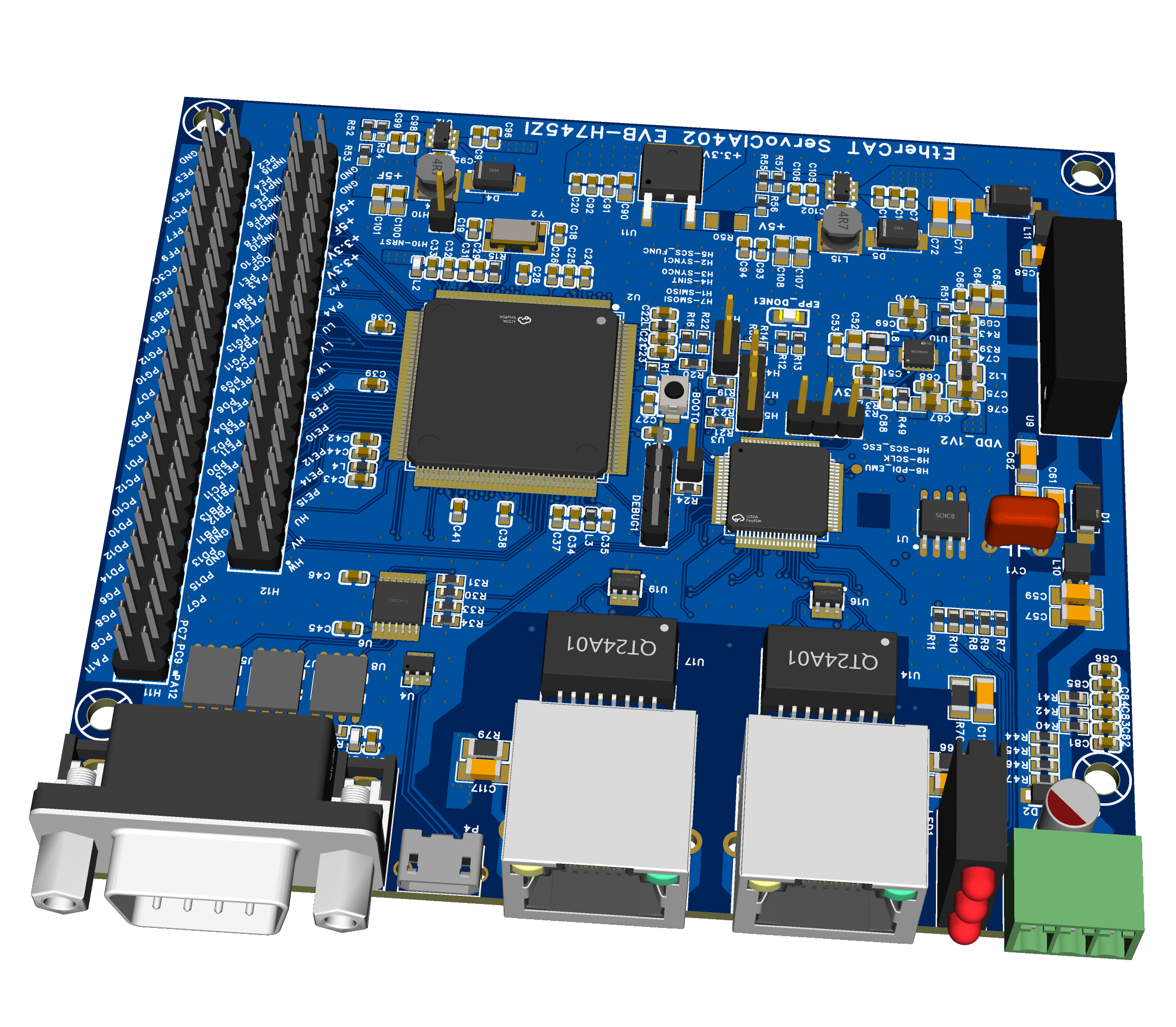

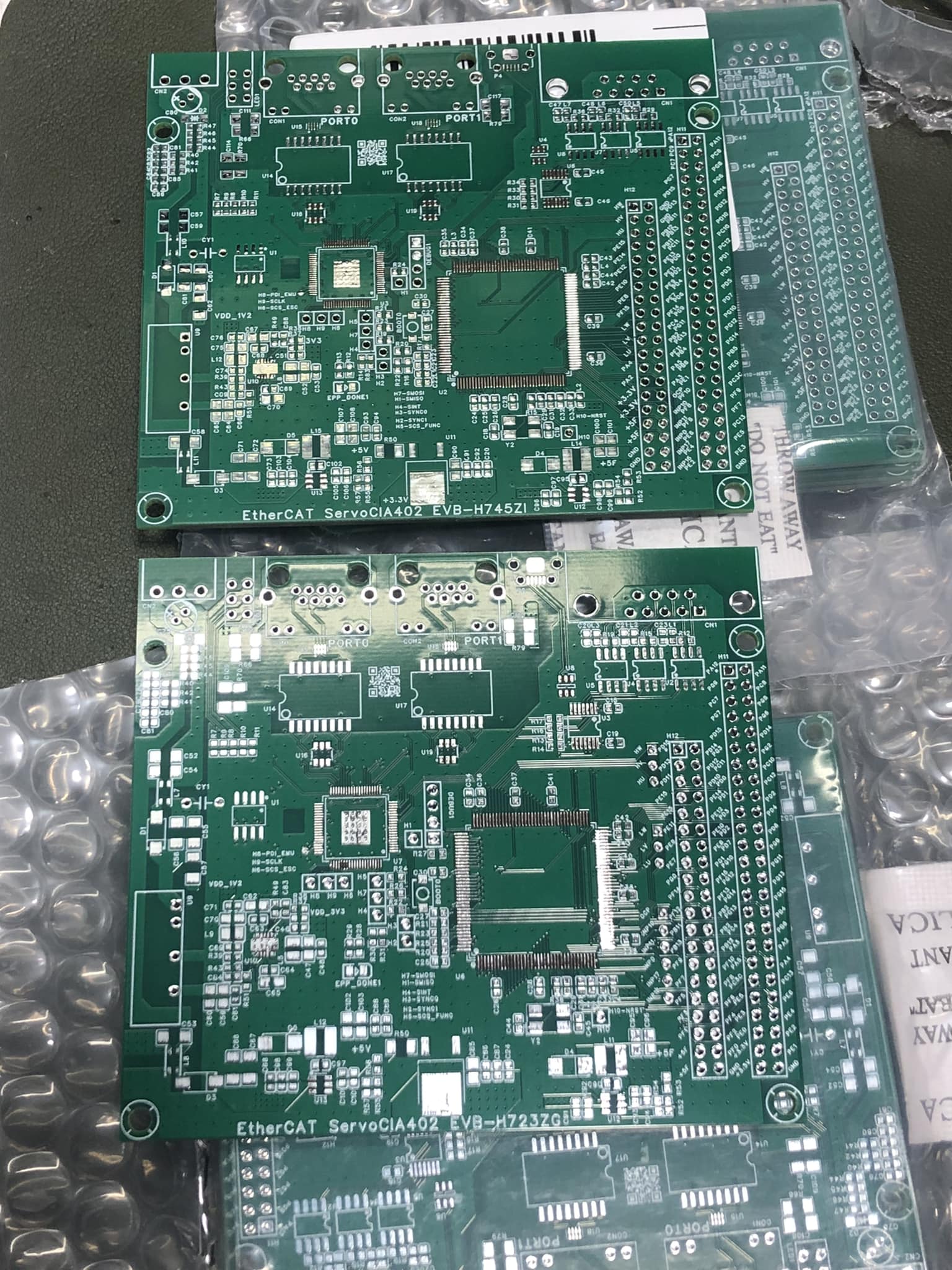

01 Dec 2024 11:41 #315725 by SOLD
I just received a new PCB that I designed based on an AXIS sample project. It is a CIA402 test board.
According to the AXIS manual, it uses an STM32H745, which has 2 cores, both H7 and H4, and is expensive. I saw that all the configuration examples only use the H4 core, so I designed another STM32H723 as an alternative. It has a single core, the H7. It costs almost the same as the F407, which is much cheaper than the H745.
When I finish building the PCB, I hope to compile the files successfully with the knowledge I have gained from Hakan.
