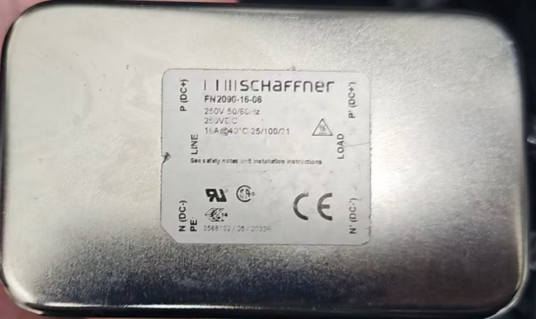

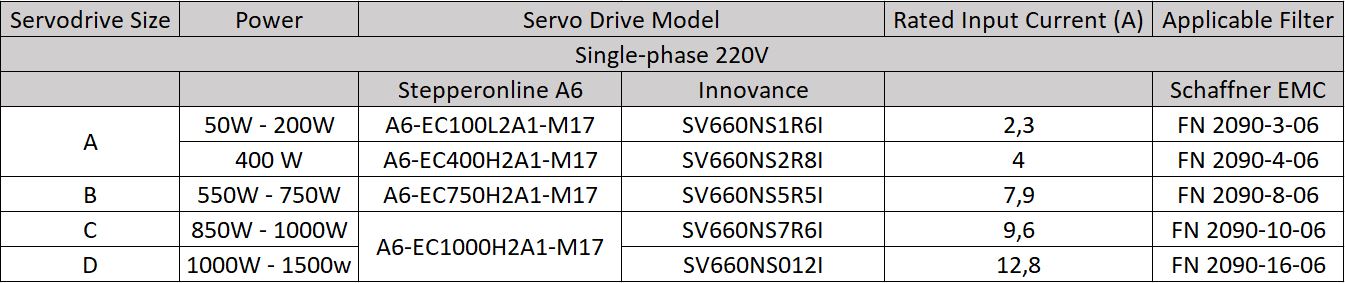

What did you use for noise filters on the servos?
I can't find any information anywhere.
- Posts: 22003
- Thank you received: 7488
23 Jan 2026 21:48 #341800
Replied by tommylight on topic StepperOnline A6 Servo
Ferrite beads on the motor wires near the drive are usually a must, and having an LC filter on the mains side never hurts.
The following user(s) said Thank You: andrax

Hi, I have now made some changes and am not experiencing any more problems for the time being.
1. I had Ethercat running on two network cards.
I have now combined them into one card and made sure that it has an Intel chip.
2. I have made the following changes in ethercat.xml:
appTimePeriod="1000000" >>> appTimePeriod="2000000"
sync0Shift=“25000” >>> sync0Shift="50000"
Since then, the errors have disappeared and the servos are ready immediately.
3. I have attached ferrite cores to the Ethercat cables.
The ferrite cores for the servos have been ordered.
