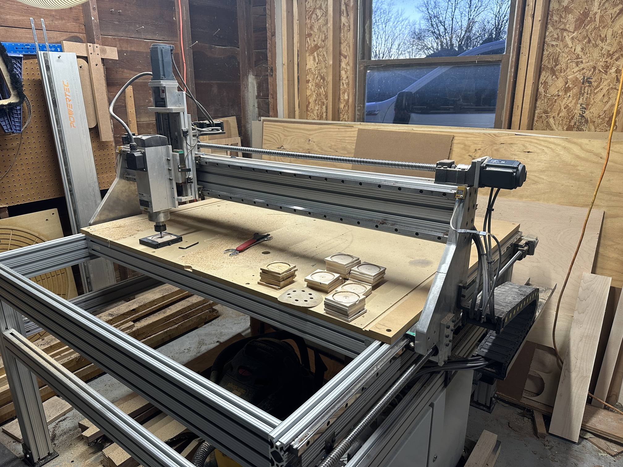

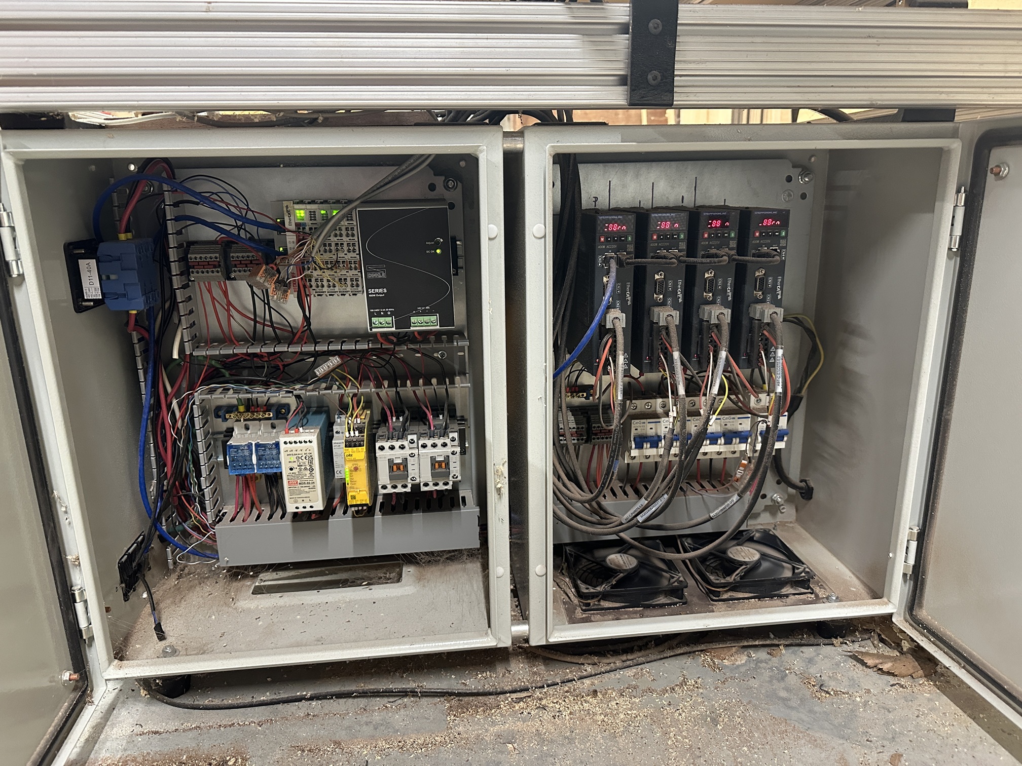

11 Jan 2026 01:14 #341256
by dschultz
Replied by dschultz on topic StepperOnline A6 Servo
It's been almost a year since I originally started this thread and thought it might be of interest to give a status update on my machine.It's been humming along without issue powered by the A6 400watt AC ethercat servos.It is a 4x4 size router direct driven with ballscrews on all axis (XYYZ). I highly recommend the A6 servos for simple set-ups. Mine is not a demanding setup but for the cost, in my opinion they are an unbeatable value. Thank-you to those that gave me pointers when I was making the transition from step drive to ethercat!
