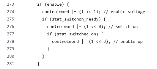

Well, I think it follows the state diagram up to the point of operation
But for sure it isn't perfect. I have noticed multiple homing components around even if I don't use it myself.
Can you add support for PV (Profile Velocity) while you are at it? I made a quick fix for that.
PV is suitable for spindle mode.
You should be able to transition states manually, in halshow for example, using controlword and check statusword.
Maybe that can give a clue to why it seems so grumpy.

Its just a snippet of code and not the whole picture.
But I wouldn't switch state before statusword says the drive has switched state.
It would be in some pending_switch_state perhaps.

Yes, I need to check it all. I did see previously that cia402 was not waiting for confirmation of homing or something so will watch for that....

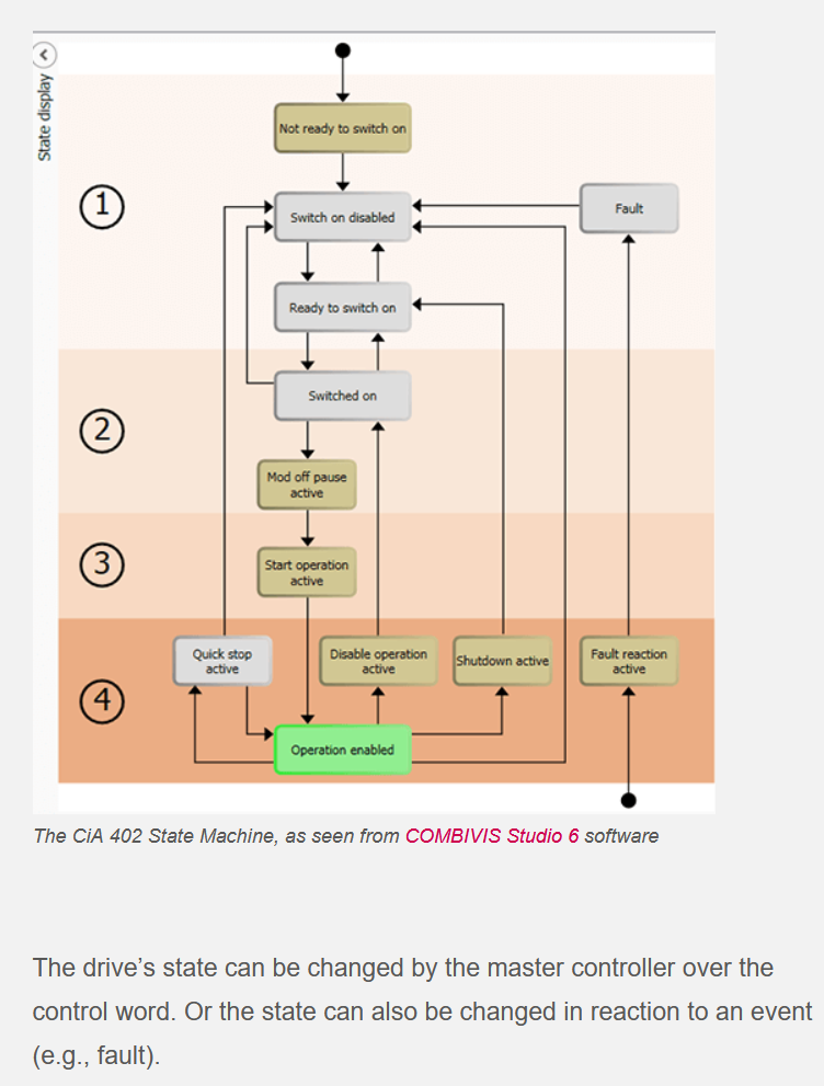

Do you think it is even possible to make a general homing component?
The drives I have seen have numerous different homing options.
Will all of them work?
The cia402 component has no easy task.
The device runs the cia 402 state machine and the cia402 component has to figure out what state it is in.
From that, rebuild the control word to match what you want it to do next.
You can't let the cia402 component be the master of the state machine, the device is.
I don't know much about how homing is supposed to work,
otherwise I could try to help more.

The issue with the original code was it was developed with a machine that homes to index so it does not work cleanly with home to sensor. The real problem is that during device homing, Linuxcnc throws following errors because it has not commanded movement. What generally needs to happen is the position feedback is synced with commanded position so Linuxcnc is happy. This is why most working solutions also provide their own cia402.comp
Yes, I think homing can be standardized for cia402 devices and the new home comp is there now to support that. So much of homing.c becomes irrelavent with device homing so the homecomp allows control of what is needed. I've had a couple of goes at it. The first was obsoleted by a rewrite of the homecomp paradigm.
The cia402 state machine is actually very simple. very linear with the exception of error and safety steps to prior states. The flowchart here is a good resource
www.kebamerica.com/blog/comprehensive-gu...a-402-drive-profile/
Anyway, back on task. It occurred to me that I had included some standard PDO's that are not reported by Ethercat pdos. I will revisit that.

The point I wanted to make about cia402 state machine was that the device decides the state,
the cia402 component can only react and ask for a change of state.
The cia402 component really only uses two states, disabled and op enabled, controlled by the enable pin.
Either transition to and stay in disabled mode, or transition to and stay in op enabled mode.
When in op enabled state, you can switch between the different operation modes. Anyway.
