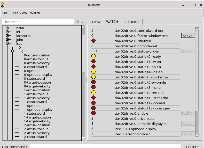

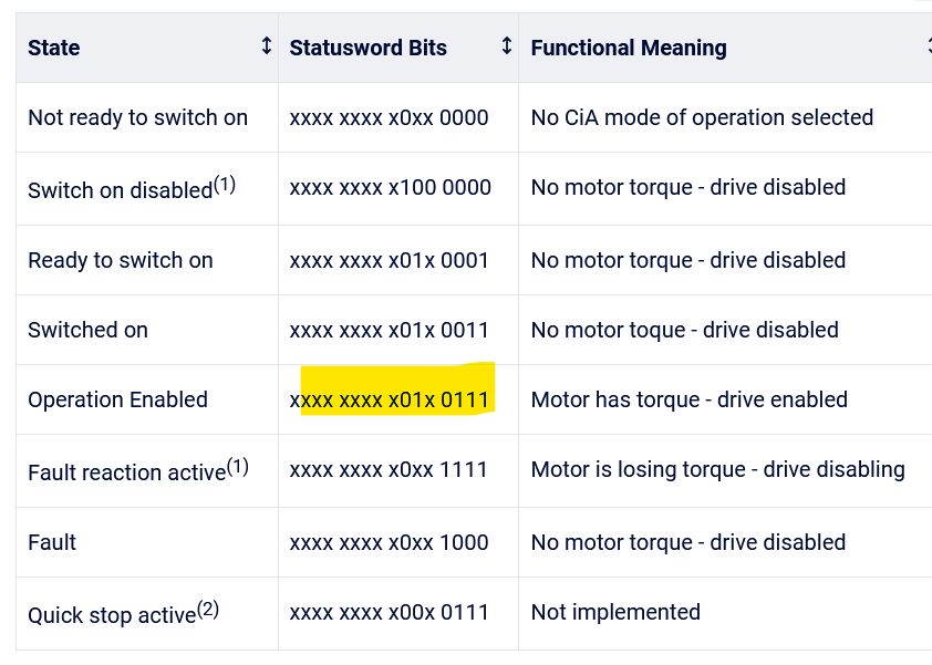

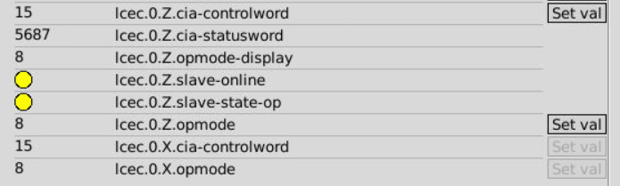

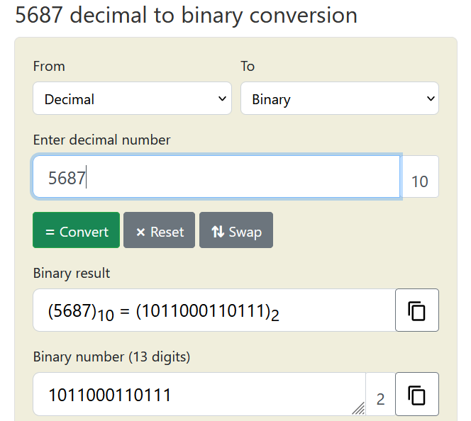

Here is a litttle exercise.
Comment out all connections to lcec for the say fourth drive. No cia involved, only lcec.
Start linuxcnc and then start halshow.
First set lcec.0.x.4-opmode to 8.
Then step by step enter 6, 7 and 15 as 4-controlword (or 4-cia-controlword).
Watch how 4-statusword changes for every number entered.
Use a dec-to-bin converted to decode statusword.
Some of the statusword combinations are belwow
Probably especially valuable to compare the drive that works with one that doesn't.

Funny, I was just looking too. There is only one lcec slave showing
So if I go back and rework all the cia402 joints to point to the correct variable/pdo for that one slave, it might work!
XML and dump of PDO's is attached

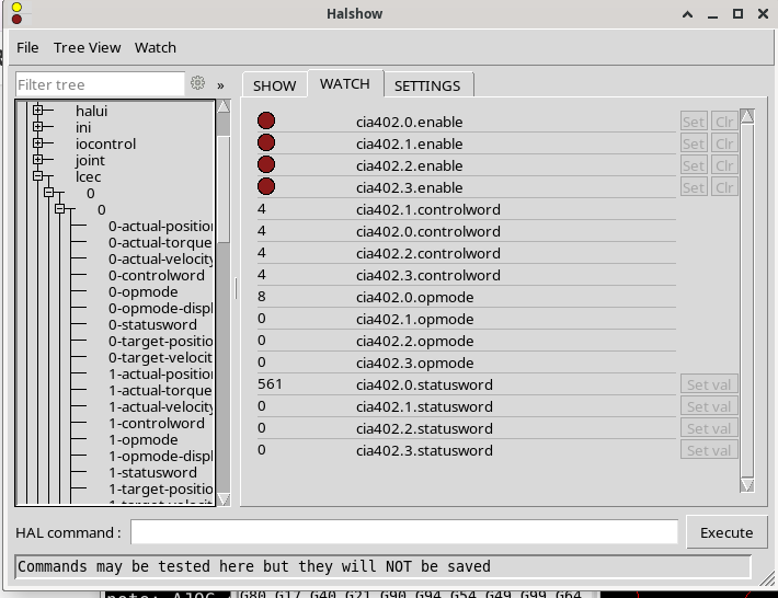

Replied by rodw on topic Lichuan 4 axis stepper need help-
Well, that's disappointing! Thats exactly what I have done.
And all of my statuswords 1-3 are zero.
If you can see any obvious errors in the XML, let me know
