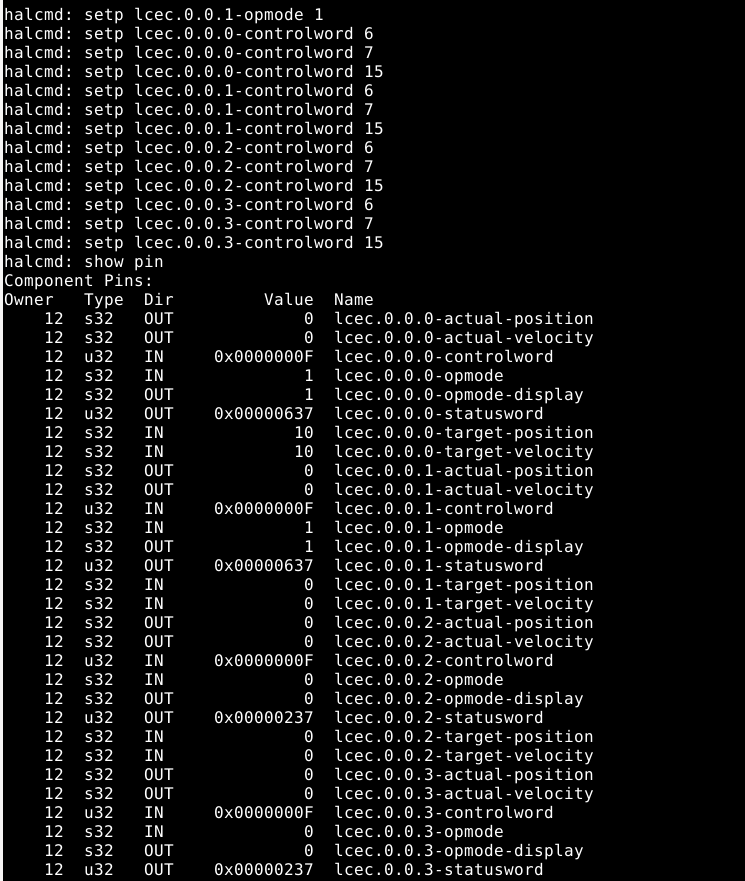

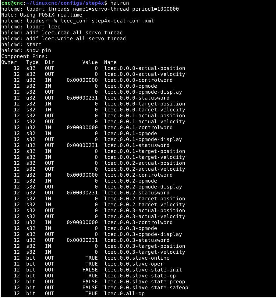

05 Feb 2026 07:23 - 05 Feb 2026 07:25 #342449
by NWE
Replied by NWE on topic Lichuan 4 axis stepper need help-
My order showed up today!
I tried a minimal hal test in the terminal. I can power up each of the 4 motors, I set control word 6, 7, 15, each motor's shaft locks when I reach 15. But I didn't get anything to move yet. Not even the first motor. I didn't try the cia402 yet.
For my ethercat-conf.xml I directly copied from rodw's post above. The only thing I changed on it was the filename.
Last edit: 05 Feb 2026 07:25 by NWE.

NWE, with controlword at 15 set op-mode to 8 (csp) and try to move again.
Don't move a lot at once, it can overwhelm the drive. Linuxcnc moves just a tiny distance every servo cycle.
Should see it on position feedback.

- NWE
- Posts: 271
- Thank you received: 84
05 Feb 2026 07:46 #342454
by NWE
This is looking better. Now I need to tape flag those motor shafts so I can see if they moved like my terminal claimed. Wait, keyboard's wireless, it CAN reach from my desk to my workbench...
