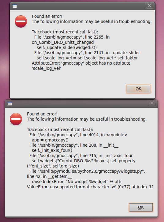

Hello all. I seem to have gotten an error after some updates that I can't track down, here are the 2 error sceens I get when trying to open. I have made no changes to the python file in these areas.

Hi Johnny
What did you edit or change and what release are you on?

That's the odd thing. 2 weeks ago I had everything working (On 2.6.4-Sim) and was about to move on to HAL file edits to my actual hal files at my machine. Fired up my virual machine yesterday morning after not having worked on anything for 2 weeks, did normal udates, ended up on 2.6.5-Sim) then got those errors when attempting to open my GUI. No files were changed in that time. I reverted back to 2.6.4 and still get the errors. I was just trying to see if it was an isoloated problem, and it must be. Thanks for the reply. I'll just start troublehsooting.
