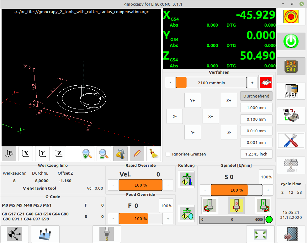

Hi , I would like to add a clock showing the cycle run in gmocappy.
any sugestions? I add this to the postgui hal file , and the pins works just fine. What I need it to add it at the top of the current gnocappy clock , just under the user tab.

please find attached a modified glade file. I added three labels:
gmoccapy.lbl_hours
gmoccapy.lbl_minutes
gmoccapy.lbl_seconds
Is this what you looked for?
This glade file will require you to use the latest 2.8 branch from rip environment. Please update to the latest 2,8 release, and than replace the gmoccapy glade file with the attached one.
place it in linuxcnc-dev/src/emc/usr_intf/gmoccapy and replace the one from the rip environment.
do a make and try if that is what you want.

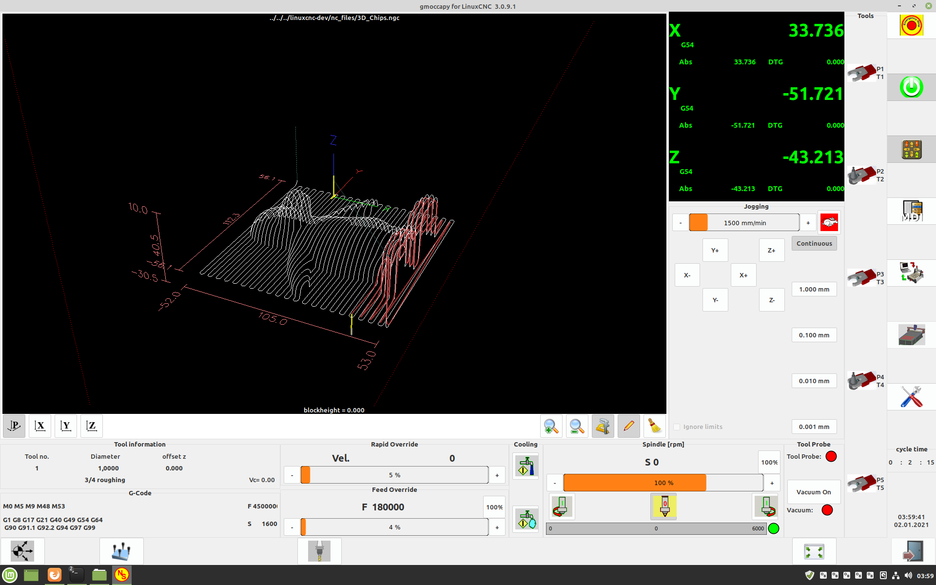

01 Jan 2021 09:03 - 01 Jan 2021 09:03 #193710
by pippin88
Replied by pippin88 on topic gmocappy clock
Norbert - I like this. Can it be made standard in gmocappy please?
