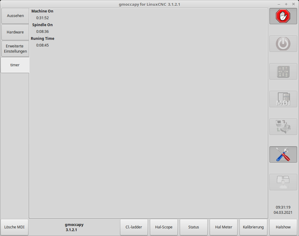

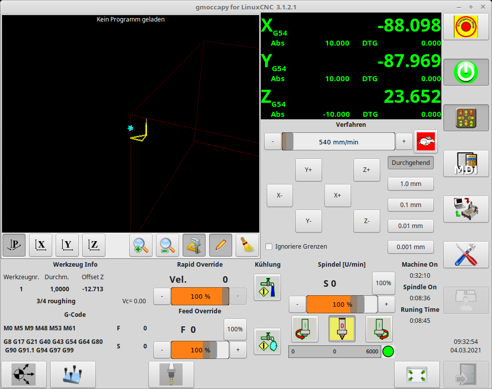

I made a glade panel to be embedded in gmoccapy showing
Total run time
Spindle time
Cycle time
I will post this asap, may be I can add to that panel also the part counter.
All values are saved in a file and restored after loading the panel again.

- newbynobi
- Posts: 1931
- Thank you received: 394
04 Mar 2021 02:49 - 04 Mar 2021 02:51 #201002
by newbynobi
Replied by newbynobi on topic gmocappy clock
So here are my glade panel, embeded in gmoccapy
First one is embedded in box_custom_4 and second one on the settings page, undocumented location
To use this, you need to download the attached files
timer.glade
timer.py
timer.hal
and place them in your config dir.
Then in your INI File in [DISPLAY] section add:
or:
depending on the locatiopn you want the panel.
As I have been ask to add also a part counter, I will do that asap, meaning it will take some time.
Norbert
P.S. Hope nobody sees the new sliders with touch screen support, as I am still testing on them
timer.glade
timer.py
timer.hal
EMBED_TAB_NAME = timer
EMBED_TAB_LOCATION = box_custom_4
EMBED_TAB_COMMAND = gladevcp -x {XID} -u timer.py -H timer.hal timer.gladeor:
EMBED_TAB_LOCATION = ntb_setup
EMBED_TAB_COMMAND = gladevcp -x {XID} -u timer.py -H timer.hal timer.gladedepending on the locatiopn you want the panel.
Norbert
Last edit: 04 Mar 2021 02:51 by newbynobi.
