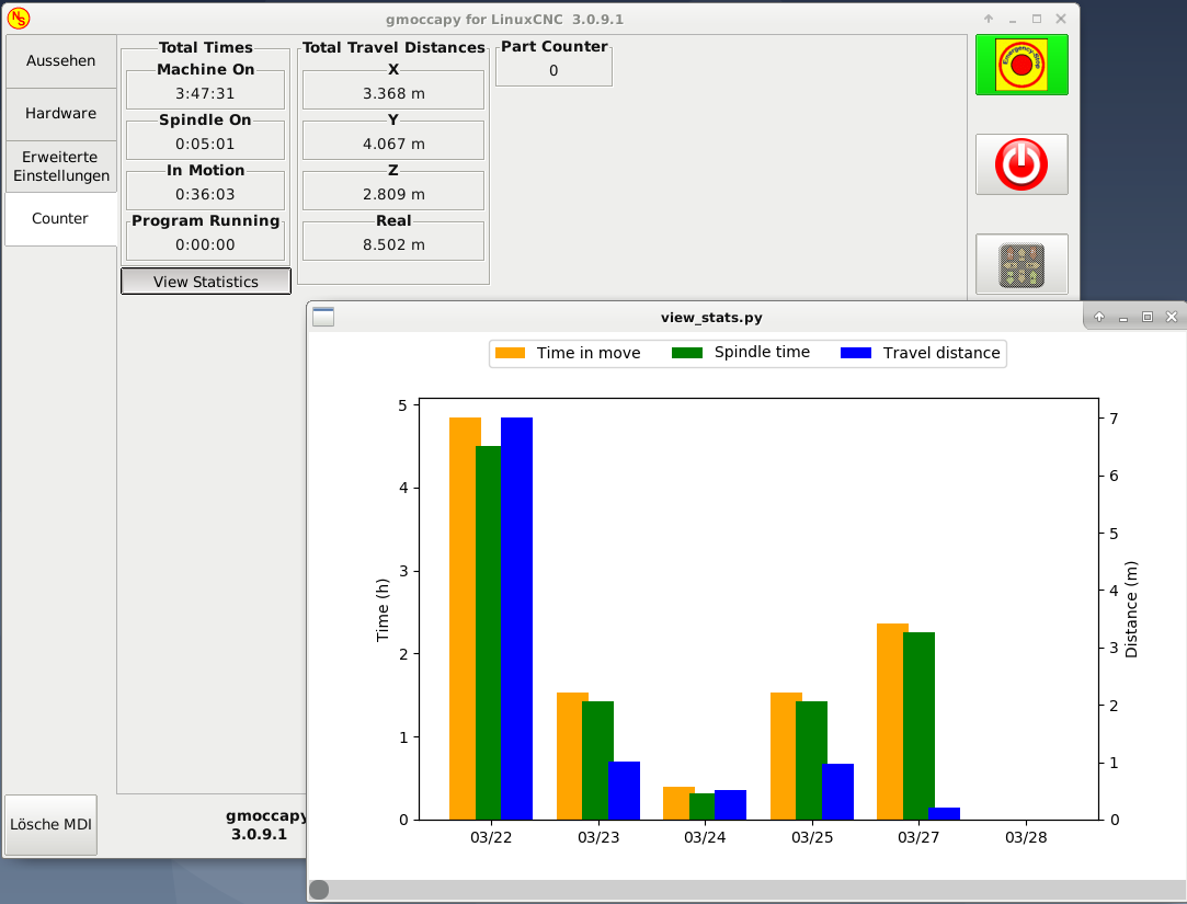

27 Mar 2021 10:32 - 28 Mar 2021 13:33 #203809
by HansU
Replied by HansU on topic gmocappy clock
I played a little bit around and added some functionality for statistics.It saves now the "Time in move", the "Spindle Time" and the "Travel distance" for each day in a file.
I added a button to view the statistics because I didn't managed it to get it integrated in the VCP. Therefore I need to import gi and when I do this it says the following even if i replace the import of these statics modules. Maybe it is caused by one of the further imports, I don't know.But having the display separately has the advantage that the user doesn't have to install the needed python module and the needed package. If someone like this feature, I can post this.
PS: @Norbert:
Some updates in github.com/LinuxCNC/linuxcnc/pull/1029 ;-)
module 'counter' skipped - import error: When using gi.repository you must not import static modules like "gobject". Please change all occurrences of "import gobject" to "from gi.repository import GObject". See: https://bugzilla.gnome.org/show_bug.cgi?id=709183PS: @Norbert:

28 Mar 2021 15:47 #203945
by newbynobi
Replied by newbynobi on topic gmocappy clock
Hans, could you please post the code,.
GI pepository tells me python3 and glatevcp needs python 2 imports, could that be the reason?
Norbert
Norbert

31 Mar 2021 02:24 #204181
by HansU
No that's not the point. I even call the graphics window by python 2.
If you want to have it embedded, you can test with the minimal_plot.py
However, having it in a separate window has the advantage that you can use the window from the matplotlib that has zooming and moving already integrated.
The following user(s) said Thank You: Ritterchen
