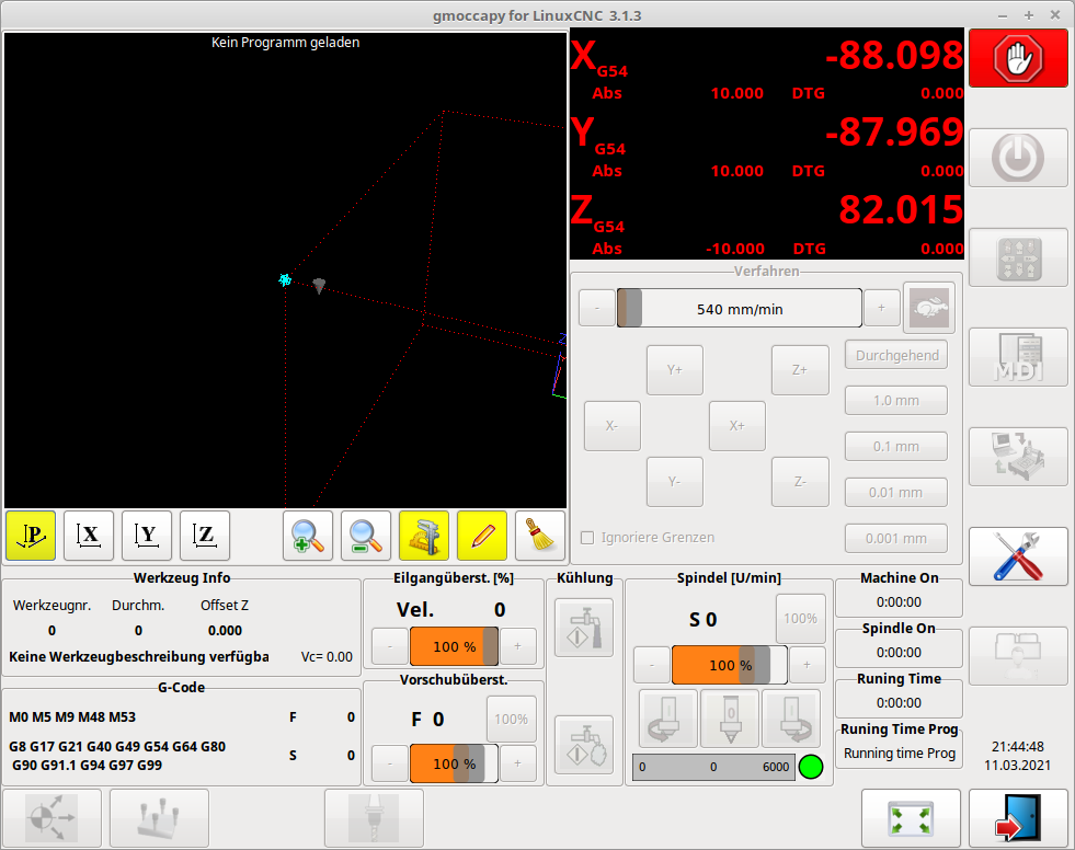

Yes I want to add the function when the display is working.
The indentation is fine and it's editied on a linux system.
And I only added 3 lines. Maybe I have missed something?
The output of LinuxCNC is
where timer_v2.hal is essentially your last hal file (I attached it again to have the same base)
If I skip the hal file withthen the tab is shown at least (of course with no function)

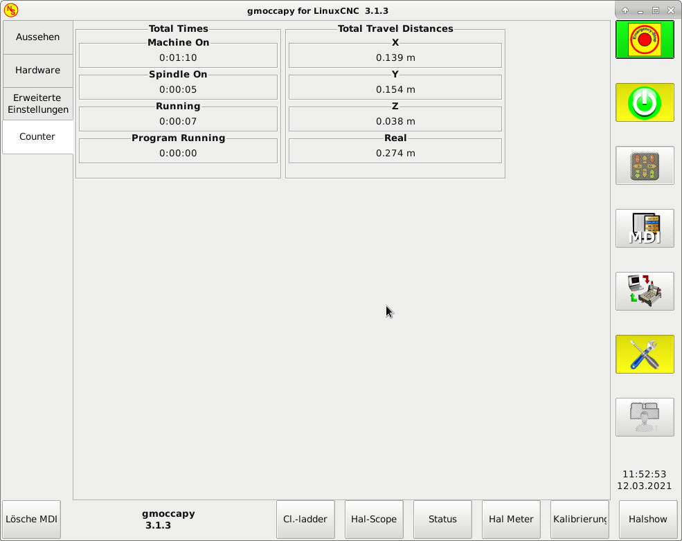

I added the travel distances to Norberts VCP:
and renamed it to counter as it does now more than time based counting.
But pay attention on if you already used the abs or integ HAL component in another hal file.
Only the columns are a bit strechted since a added a vbox around. Without the vbox was that correct (see counter_b.glade)
The calculation of the real travel distance was easier than my first approach when using the pin "motion.current-vel".
If someone has a better name for "Real" please tell me. I didn't want to use "Total" because it doesn't simply adds the travel distances of X, Y and Z.
The Program Running Time makes no sense in this location as you can only get there when the program is stopped. In this case the counter will be resetted and you will always see a zero. I let it in if someone wants it at another location.

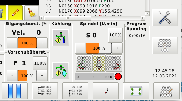

Therefore a added a separate VCP for the current program running to be displayed at the main screen like this:
I added it in the INI file in this way:
I'll add the files for the programtimer in another post because of the file number limitation.
