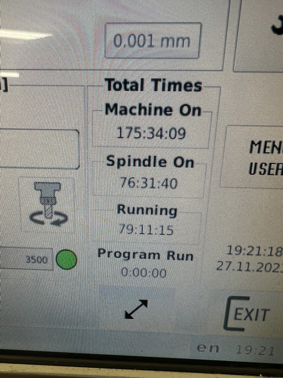

What widget do you have in mind? There are several in this thread...completely by chance there is no timer version for 2.9? Moved from 2.8 and now does not work. It's very sad...

Did you convert it using an online converter?

I tried online, but it didn't work out. Widget appears, but there are no values in the fields

Ok I thought you have posted the python3 version, but you only used the new icon theme for LinuxCNC 2.8, so I was a bit irritated.

Excuse me for upsetting you, my english is too bad. On the contrary, I asked for the help of the community. I converted vers probe screen for 2.9 and now I'm testing, but I can't beat the timer.Ok I thought you have posted the python3 version, but you only used the new icon theme for LinuxCNC 2.8, so I was a bit irritated.

I did a quick conversion for usage with LinuxCNC 2.9 (Python 3).
But only a very quick one - the setting of the theme is not converted yet
EMBED_TAB_NAME = counter
EMBED_TAB_COMMAND = gladevcp -x {XID} -u counter.py counter.glade
EMBED_TAB_LOCATION =box_custom_4

thank you so much, works!

Does this work with linuxcnc v2.9.3 ? I am trying to add this timer.But the panel is not created. After starting the program, linuxcnc creates the necessary file to store the times . am i doing something wrong or are there new files for this version

Start LinuxCNC from terminal and watch for the output, you might see errors.
