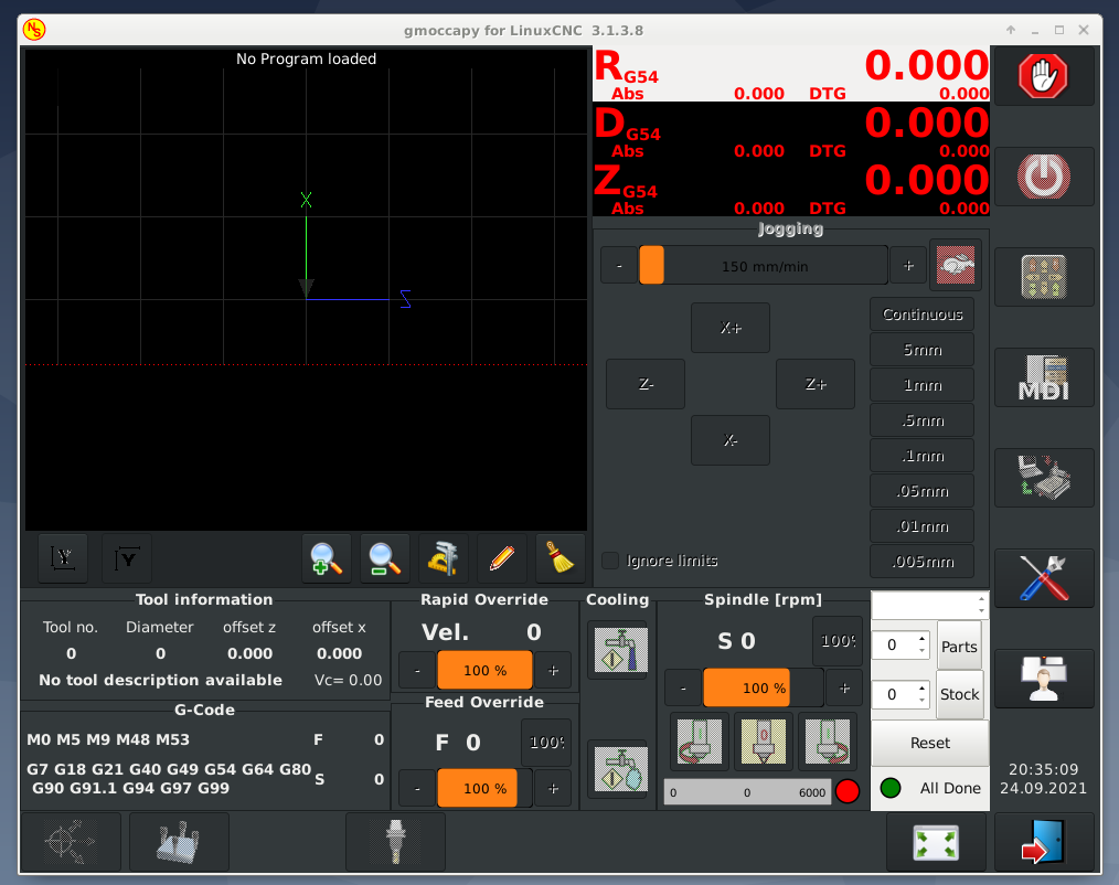

24 Sep 2021 10:24 - 25 Sep 2021 07:58 #221502
by virencq
Replied by virencq on topic gmocappy clock
The working Job Counter.
in .ini file put
EMBED_TAB_NAME = counter
EMBED_TAB_COMMAND = gladevcp -x {XID} -H counter.hal counter.glade
EMBED_TAB_LOCATION =box_custom_4
- Set the no of Jobs to be produced by entering numbers besides Parts button. Click over it to sent to classicladder.
- if we do have yesterday's produced parts, put them in besides Stock button field and validate.
- Now we start producing parts. As soon as we reach our last part. we have glowing LED All Done, Along with machine stop.
- Reset button for Stock value zero
- I would also like Parts counter to be dark
in .ini file put
Last edit: 25 Sep 2021 07:58 by virencq.
- newbynobi
- Posts: 1931
- Thank you received: 394
05 Oct 2021 00:12 #222244
by newbynobi
Replied by newbynobi on topic gmocappy clock
you will need a counter.py file, just to set the used theme.
You may look in original timers files.
Norbert
Norbert
- virencq
- Posts: 89
- Thank you received: 5
06 Oct 2021 23:23 - 07 Oct 2021 08:07 #222426
by virencq
Thanks,
Theme issue resolved by keeping identical theme for system as well as Linuxcnc.
Last edit: 07 Oct 2021 08:07 by virencq.
