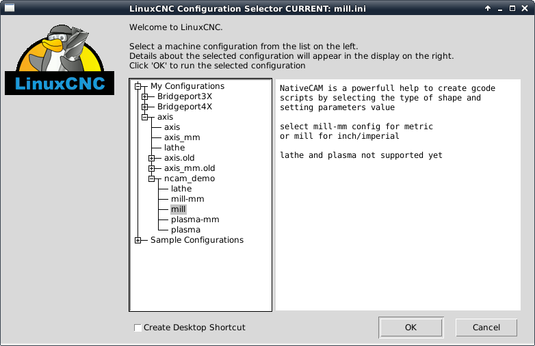

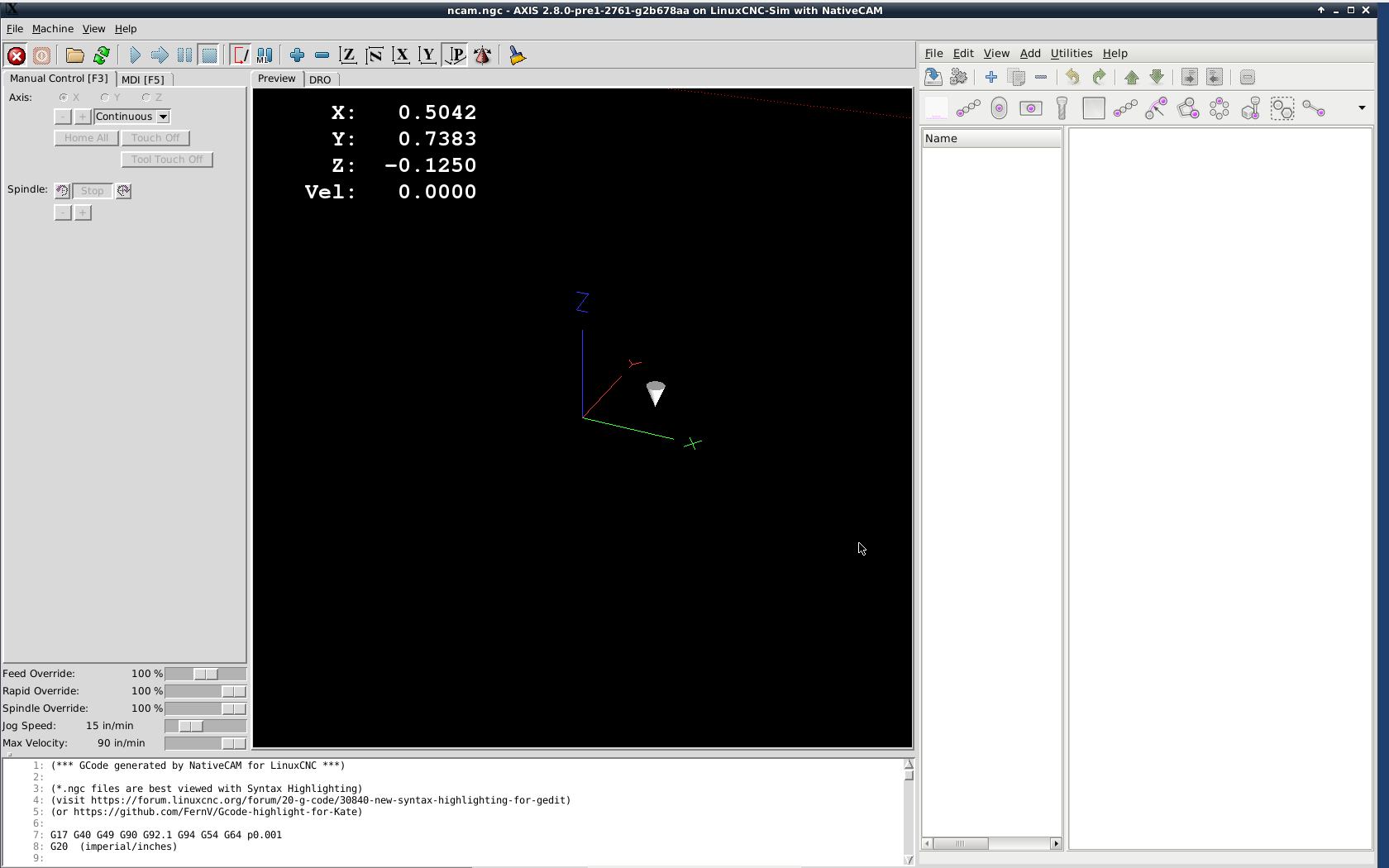

Well, the next step of your instructions resulted in a error yet success also.
Here is the terminal window
bridgeport@Bridgeport:~/NativeCAM$
bridgeport@Bridgeport:~/NativeCAM$ linuxcnc configs/sim/axis/ncam_demo/mill.ini
LINUXCNC - 2.8.0-pre1-2761-g2b678aa
Machine configuration directory is '/home/bridgeport/NativeCAM/configs/sim/axis/ncam_demo'
Machine configuration file is 'mill.ini'
Starting LinuxCNC...
Found file(REL): ./core_sim.hal
./core_sim.hal:28: Pin 'axis.0.motor-pos-cmd' does not exist
/home/bridgeport/linuxcnc_debug.txt
and
/home/bridgeport/linuxcnc_print.txt
as well as in the output of the shell command 'dmesg' and in the terminal
BUT WAIT ! for fun, I tried launching linuxcnc from the gui using the launcher and picking the demo config. IT LAUNCHED !
I am attaching 2 screenshots, one of the launcher window showing the config I used and the other of the axis window with NativeCAM as it launched without error.
and
TIme now to wait for your comments. It appears to me that NativeCAM did not find the config in the place designated by your command line instruction.

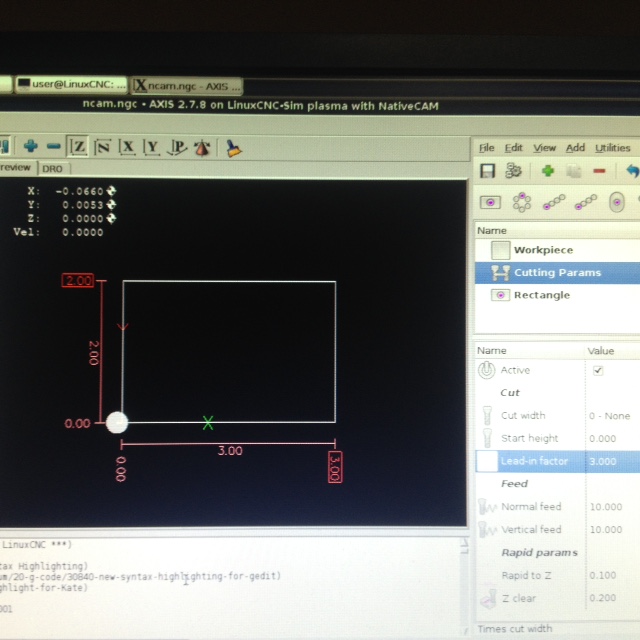

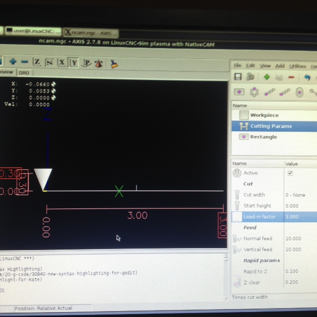

i have installed the new version of nCAM and it run properly, i'm using the plasma setup, however when i crete any shape i do not see any lead in it
here are the screens
is anything mising on the set up?
Thanks..
Thanks..

To George,
It is strange that you have ncam_demo in your launcher ??? I think it had to be putted there in your lcnc distribution which is a pre-release as : 'LINUXCNC - 2.8.0-pre1-2761-g2b678aa' and I believe that is why you have the
'./core_sim.hal:28: Pin 'axis.0.motor-pos-cmd' does not exist' error.
In a terminal type : 'locate ncam.py' to see if there are other copies on your pc
Anyway, you can now familiarize yourself by loading examples and test them.
Do not forget that you have to select the right order
Fern

In 'Cutting params', you have to select a 'cut width' which is defined as a tool
Fern
Replied by FernV on topic Lead in set up
Fern
