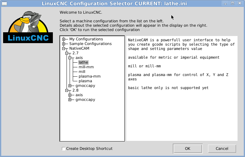

Have you started linuxcnc with this command ?
$ linuxcnc /home/linuxcnc/linuxcnc/configs/test_setup/test_setup.ini
or specify a relative path for the inifile
Fern

28 Sep 2017 14:31 - 28 Sep 2017 14:41 #99552 by FernV
Replied by FernV on topic NativeCAM is Features renamed
/usr/share/linuxcnc/aux_gladevcp/NativeCAM/ncam.py:2442: GtkWarning: IA__gtk_accel_label_set_accel_closure: assertion `gtk_accel_group_from_accel_closure (accel_closure) != NULL' failed
mi = _action.create_menu_item()
Previous warning is from a pygtk bug and only affect some menu accelerators, never pay attention to this
/usr/bin/gladevcp:185: GtkWarning: GtkSpinButton: setting an adjustment with non-zero page size is deprecated
builder.add_from_file(xmlname)
**** probe_screen GETINIINFO ****
Preference file path: /home/alexian79/linuxcnc/configs/mach3bob/mach3bob.pref
Xlib.protocol.request.QueryExtension
/usr/bin/gladevcp:295: GtkWarning: gtk_widget_size_allocate(): attempt to allocate widget with width -5 and height 15
gtk.main()
HAL: ERROR: duplicate component name 'gladevcp'
*** GLADE VCP ERROR: Asking for a HAL component using a name that already exists.
Looks like you are trying to load a new file with gladevcp. I do not think your error to be related to NativeCAM. You could post your inifile.
When testing NativeCAM, you should try the included demos first and make sure everything is fine before integrating with your setup.
Fern

28 Sep 2017 14:39 #99553 by FernV
I have started it by clicking the link I had on the desktop. I thought that's using the updated ini file.
It should but I also recommend you try the demos.
If you still have problems, delete '/home/linuxcnc/linuxcnc/configs/test_setup/test_setup.ini' and rename your backup '/home/linuxcnc/linuxcnc/configs/test_setup/test_setup.ini.bak' to '/home/linuxcnc/linuxcnc/configs/test_setup/test_setup.ini'
then run $ ncam -c lathe -i /home/linuxcnc/linuxcnc/configs/test_setup/test_setup.ini
without the -t option
then try $ linuxcnc /home/linuxcnc/linuxcnc/configs/test_setup/test_setup.ini
It would also be helpful to post the inifiles your try
Fern

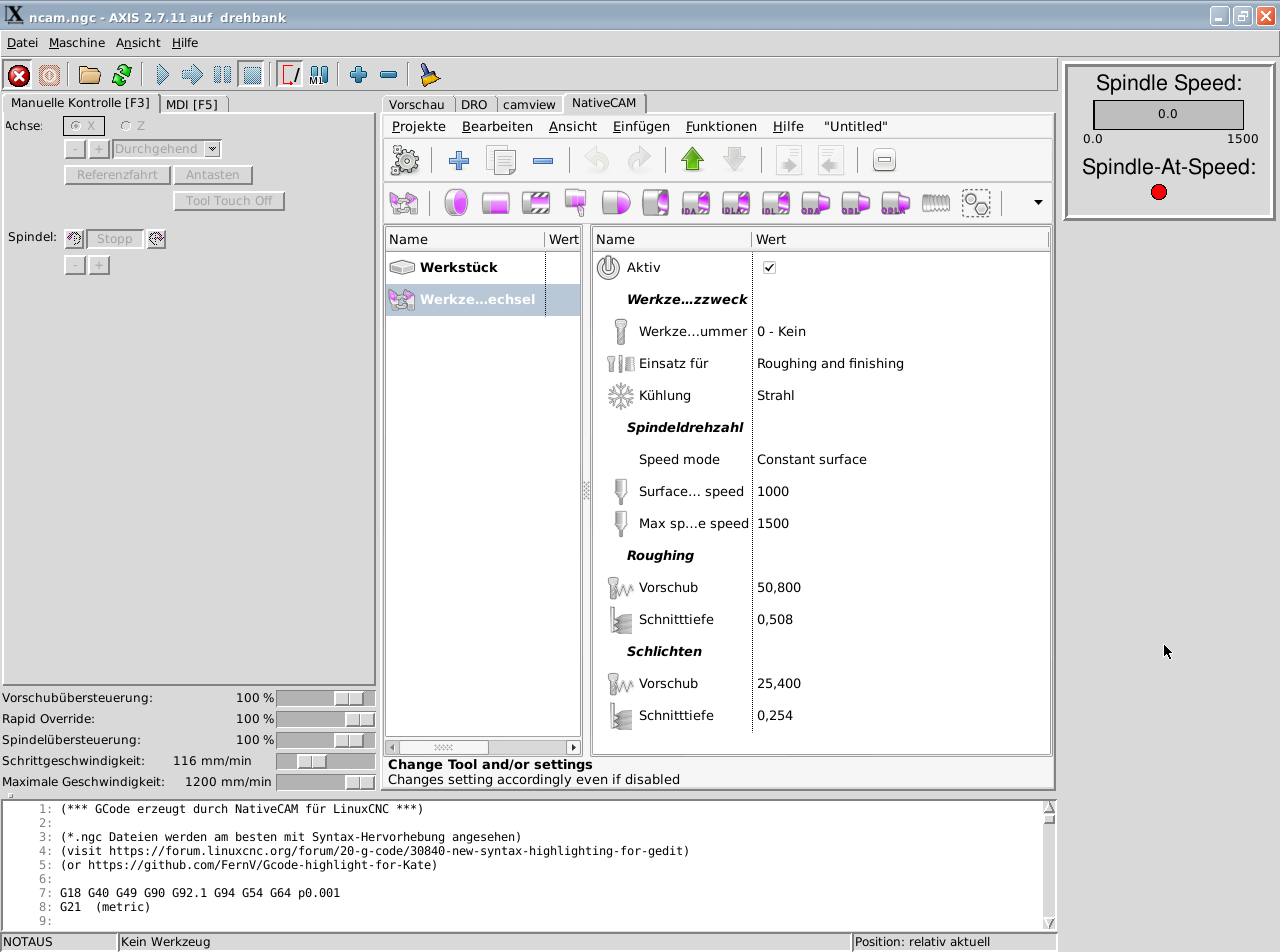

28 Sep 2017 15:57 #99563 by BigDo
Replied by BigDo on topic NativeCAM is Features renamed
more icons :)

28 Sep 2017 16:02 #99564 by FernV
Hi Niko,
These are very nice and will be used for sure. However it should be added to icons.svg and saved with the project. Could you send the svg file or send a pull request on github ?
Regards
Fern
