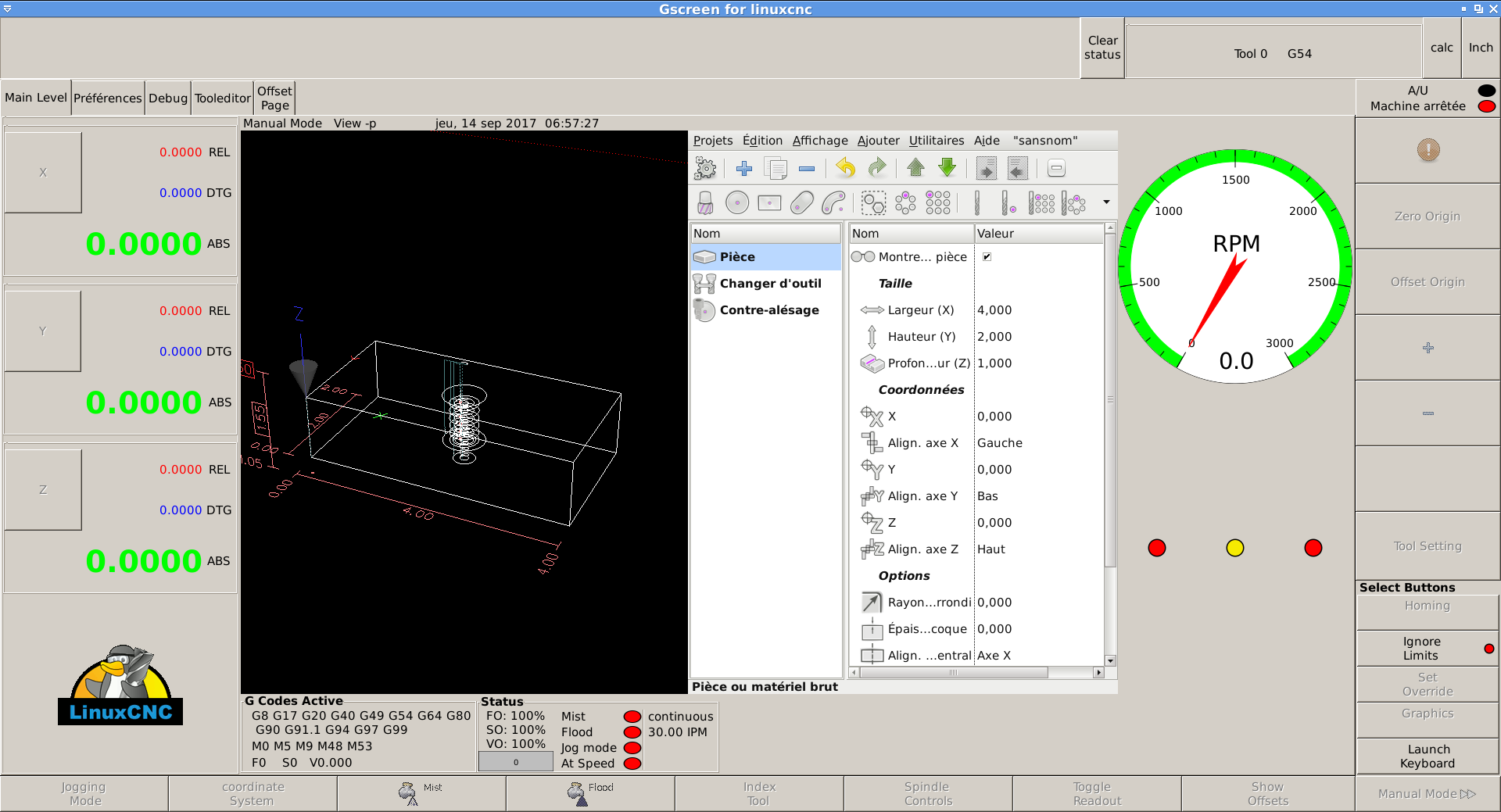

14 Sep 2017 23:03 #98977
by FernV
Something I have not found is a button to 'skip block' with a '/'. This is essential or you will have the cutter going on all the paths. It is not possible to have it safe without this function.
I must also find how to include it in a tab if possible.
Fern

16 Sep 2017 11:38 #99031
by FernV
I found the 'Block Delete' button and next release of NativeCAM will have examples for gscreen.
However I did not find an easy way to include NativeCAM in a new tab. I read that gscreen is for users who want to customize the interface and there are how-to for it, something that can not be done by NativeCAM.
Regards

Real paths:
/home/linuxcnc/linuxcnc/configs/test_setup/ncam/my-stuff
/usr/share/linuxcnc/aux_gladevcp/NativeCAM/lib/lathe
/usr/share/linuxcnc/aux_gladevcp/NativeCAM/lib/utilities
Using default lathe/menu.xml, no lathe/menu-custom.xml found
/usr/bin/ncam:2442: GtkWarning: IA__gtk_accel_label_set_accel_closure: assertion `gtk_accel_group_from_accel_closure (accel_closure) != NULL' failed
mi = _action.create_menu_item()
Previous work not saved as current work
It completed without errors and it opened the stand alone native cam.
I've closed the stand alone native cam, then opened linuxcnc, it started successfully but there's no native cam tab.
What can I do so that I see the nativecam embedded into linuxcnc?
Thanks for your previous responses!
Last edit: 27 Sep 2017 19:31 by vmihalca. Reason: Added more details
