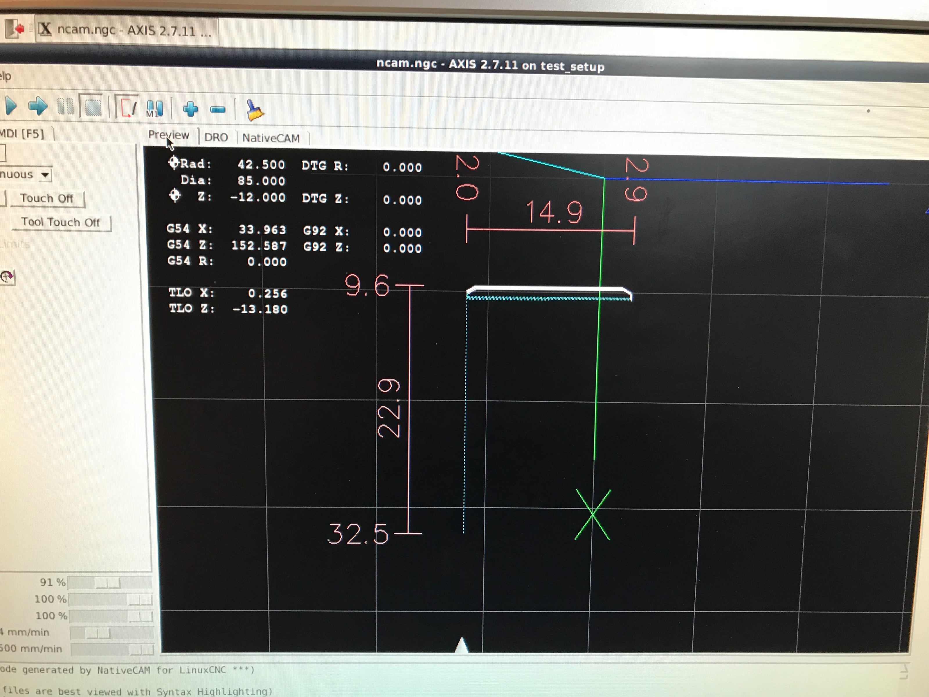

14 Nov 2017 23:19 #101807 by vmihalca
Replied by vmihalca on topic NativeCAM is Features renamed
Hi Fern,
Thanks for the update! I had a look today over it and the tool compensation appears now.
I have a question related to the following images.
What is the x rapid and z rapid supposed to do? I think there’s a naming mistake..at least for X, it seems that when an operation is done, that’s the distance on which the tool wil retract.
If I increase that value from 20 to 30, in the preview screen I will see 3 squares and not two. A square represents 10mm.
The value I set for Z doesn’t seem to have any effect.

15 Nov 2017 15:57 #101847 by FernV
Replied by FernV on topic NativeCAM is Features renamed
...What is the x rapid and z rapid supposed to do? I think there’s a naming mistake..at least for X, it seems that when an operation is done, that’s the distance on which the tool wil retract.
Sorry, I failed on this. Since I set the same values to both, I did not notice the error.
I think 'X rapid' should be the distance it retracts to right to move safely along X axis and 'Z rapid' from diameter/radius of part to be safe along Z axis. Do you have a different point of view on this before I correct this ?
Meanwhile, I think you can invert both values until I publish an update.
Thanks for mentionning it and other issues you notice. And please, ask for any improvements you think would be usefull.

15 Nov 2017 16:18 #101849 by vmihalca
Hi Fern,
I'm a learner too, but I think a suggestive naming would be something like in Fusion 360
Retract distance X/Z
Safe distance X/Z
I'm doing manual tool change and using these I would like to define the safe position on X/Z where I can do the tool change.
Regarding useful features, an useful feature for me was the threading routine where the depth of cut was calculated automatically as the height of the equilateral triangle (for metric). There was a routine I used a while ago, where I just had to specify the starting position on X and then the DOC would be calculated according to that formula based on thread pitch. I think it was called advanced-threading.cfg
Another useful feature for me would be multiple start threading.
My goal would be to not depend on Fusion360 for the usual tasks.
Using nativecam seems much faster. :)
Thanks for your effort and all the great support!

15 Nov 2017 16:50 #101851 by FernV
Retract distance X/Z and Safe distance X/Z
Is retract the distance when doing multipass and safe when completed ?
Usually tool change position is defined in the ini file
This is something I am considering, you can see some kind of preview when toggling 'skip block' command. I think 'Small diameter' could give the option to define automatically or the user defines it himself
I am also trying to find some charts to make a list of standard threads where you would select a size and thread pitch, either metric or SAE.
Can you explain a little more ?
Fern
