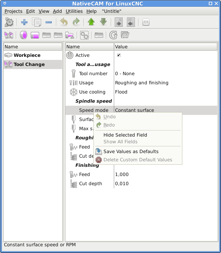

1. I can't set spindle direction. My lathe is manual and I need an M4 code. In the tool_change.cfg, i saw that the spindle dir option is hidden. Can you please make that unhidden? Or tell me how I can edit that file...currently I don't have permissions where its stored after the deb install
2. It doesn't seem to consider the tool offsets. After I homed the machine, I've loaded tool 1 using M6 T1 G43, then I jogged the tool on Z and X and set the ToolTouchOff. After this I jogged away form the part then issues an G0 X0 Z0 and the tool moved into the correct position. After I've tried to run a simple turning using native cam, in the tool change routine, I've selected tool 1, in the Tool Number section. When I hit run, it moves on Z about -40mm from where the zero should be.
If you have time to fix these issues, can you please push an update? I saw that you received some beautiful icons that would be very intuitive.
Thanks! :)
  1. Right click on a parameter in Tool Change
  2. If 'Show All Fields' is grayed, then hide one of the fields
  3. Right click again and select 'Show All Fields'
  4. 'Save as Default Template' or you will have to redo it until I update
I just started testing the subroutines on my lathe and I have some that are OK now. Your issue is probably due to one of the bugs I fixed. I think next week, I will have enough fixes for an update.
Fern
