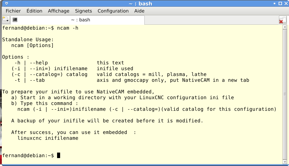

Are you talking a preview for NativeCAM ? If so you must toggle 'Block Delete'
I have made no attempt to make it an LCNC "tab" utility because its window it bigger
Many users like to have it in a new tab but personnaly, I prefer seeing changes immediately and installed it in axis and gmoccapy in the front page (if I can say)
It is easy to install in a tab, for info $ ncam -h
However, if you already have extra tabs, they might be disabled. I will correct this in the next release.

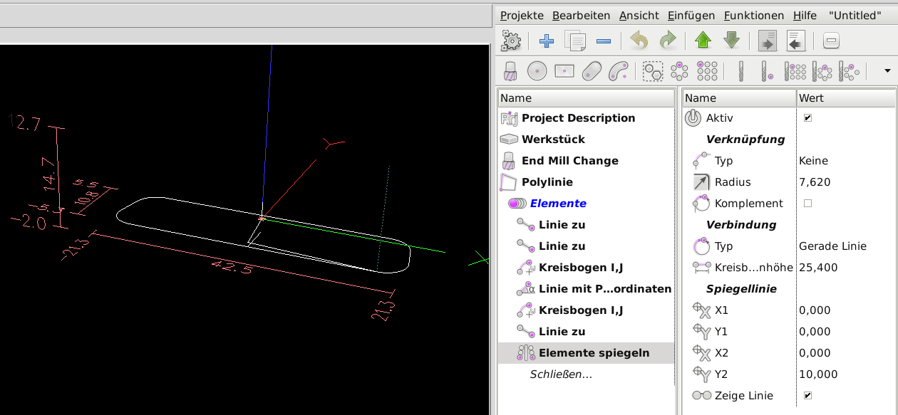

17 Dec 2017 16:33 #103223 by kjacobs
Replied by kjacobs on topic NativeCAM is Features renamed
Hi Fern,
when using polylines for a feature that has an axis symmetry and is slightly more complex, the idea is of course to just draw one half and then use the mirror function with zero offset to complete the feature. When I do that, the polyline is in two parts and will also be milled in two separate milling actions, irrespective of closing or not closing the original polyline. I was expecting that the final result of the mirroring with zero offset would be a single (closed) polyline. Am I doing something wrong or is that by design? I attached an example of a cutout for a D-Sub 25 pin connector.
Apart from that, I finished a new translation to german using the 0.14b version and will send that to you after some more testing. And thanks again for your wonderful work!
Regards,
Karl
File Attachment:
File Name: D-Sub25_ha...ored.xml
File Size:43 KB

17 Dec 2017 19:54 #103237 by FernV
Replied by FernV on topic NativeCAM is Features renamed
...when using polylines for a feature that has an axis symmetry and is slightly more complex, the idea is of course to just draw one half and then use the mirror function with zero offset to complete the feature. When I do that, the polyline is in two parts and will also be milled in two separate milling actions, irrespective of closing or not closing the original polyline. I was expecting that the final result of the mirroring with zero offset would be a single (closed) polyline. Am I doing something wrong or is that by design? I attached an example of a cutout for a D-Sub 25 pin connector.
Hi Karl,
The selected option will create a new entity and must be placed outside a Polyline like you did. In your case what you need is "Elemente spiegeln" (Mirror items) and place it after the elements you want to miror like this image.
I also include the corrected file
