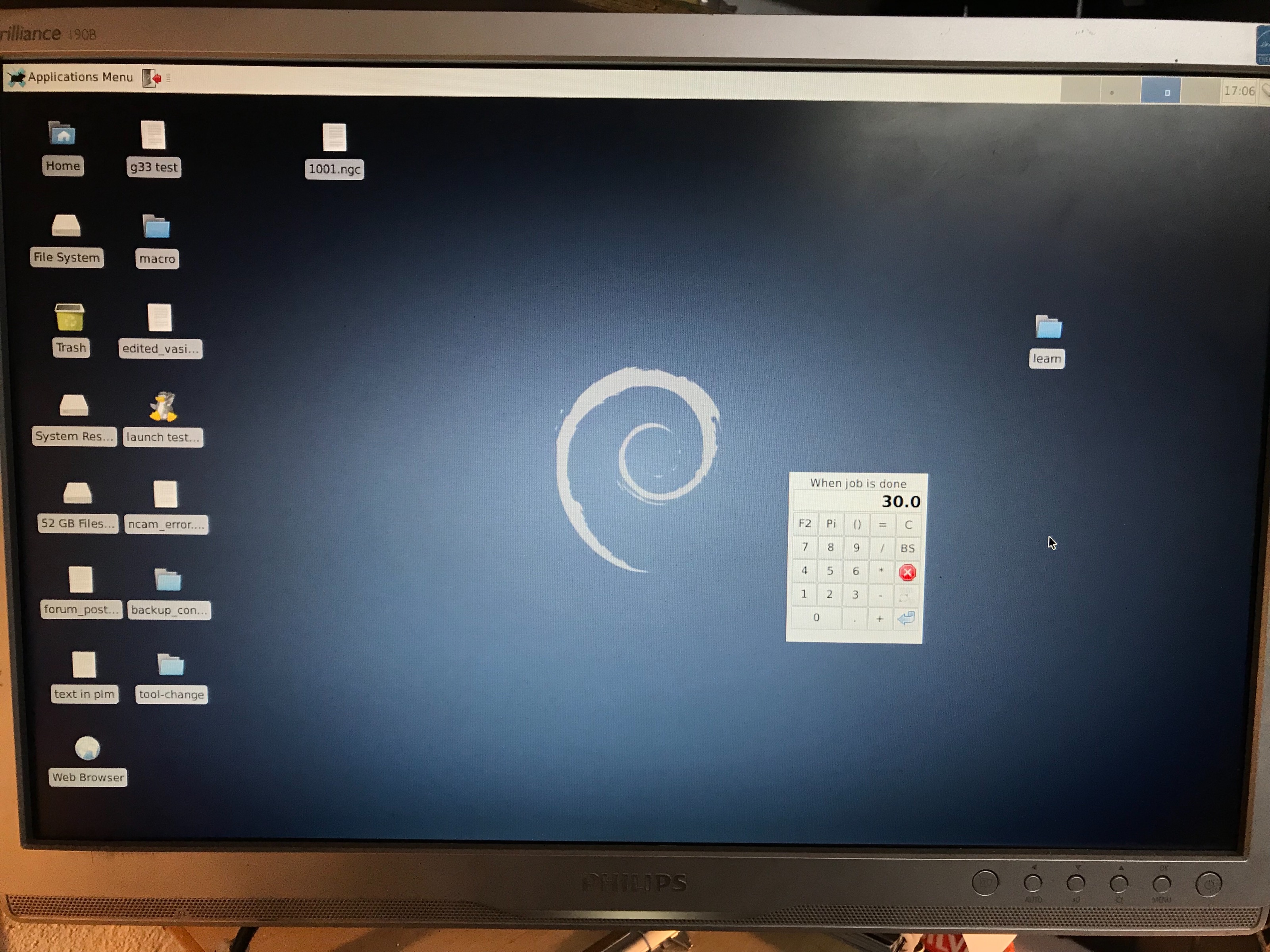

PS. Because you mentioned to report issues.. another issue that I had, was related to that numeric input that shows up when entering a value. I had situations where that popup would not disappear nor allow input. Tried escape, back, delete, click outside..nothing
I don't wanna say smth stupid but if I remember correctly, the last time, I've closed linuxcnc and that popup was still on the screen even if linuxcnc was off.

Hi Fern,
I have some issues with that calculator like popup that I cannot close. There are moments when I have to restart pc in order to get rid of it. Closing linuxcnc is not enough..
You can see in the image below.
I would be grateful for a fix
