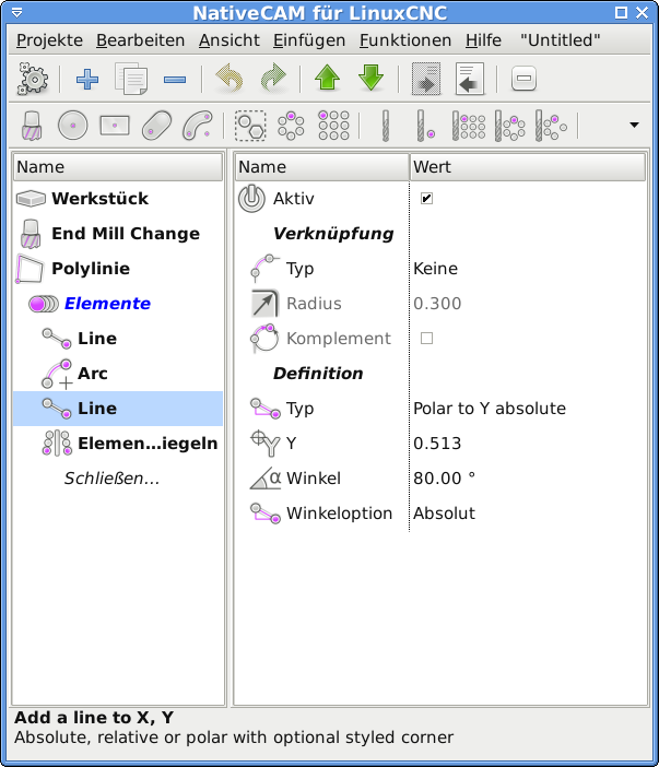

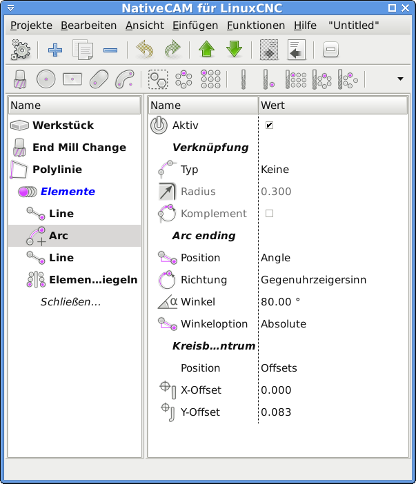

Hi Karl,
I wrote a subroutine to create DSub cut-outs including the mounting holes, either milled or drilled.
Have you noticed an error in the Norcomp table for the front mounted ? The value of F column(11.68) does not match the value of H column(8.81) + 2 * radius(2.11) which is 13.03mm. I hope it did not cause you a problem.
I have new line and arc subroutine for Polyline that make it possible to create a cut-out like this by only dividing E value by 2 and of course adding H + 2* radius. Much more user friendly since there is only 1 line sub and 1 arc sub to chose from.
Fern
Fern

I only needed the back mounted version which seems not to have that error. But it shows the danger of trusting the first google hit...Have you noticed an error in the Norcomp table for the front mounted ?
This new polyline option looks very useful!I have new line and arc subroutine for Polyline
Thank you for putting so much effort into this, this is all very instructive, at least for me. And even showing it in the german version. I could live with the english version which would make it easier for the rest of the planet. I just use the german version to help a friend who is not fluent in english (and to test my german translation, the new version of which I'll be sending to you soon).
Cheers,
Karl
