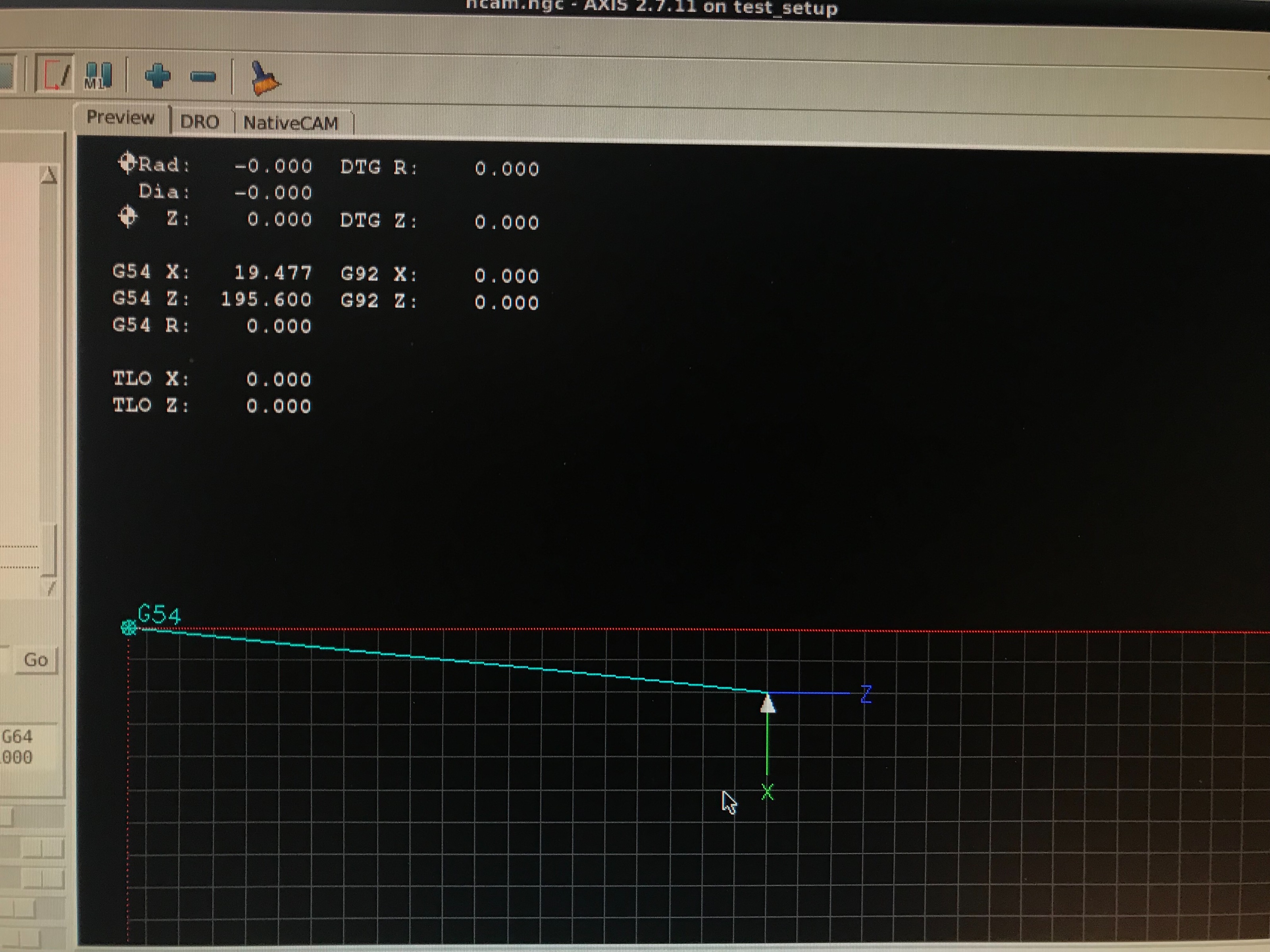

20 Nov 2017 21:33 - 20 Nov 2017 21:35 #102108 by vmihalca
Replied by vmihalca on topic NativeCAM is Features renamed
It seems to work, I hope I correctly understood what you explained, I will come back later with further questions if I’ll notice smth doesn’t work as expected.
In the image below, i have tool 1 loaded and executed g0 x0 z0.
Can you please explain me like to a stupid guy, :) what DTG R, DTG Z, G92 X and G92 Z do represent.
PS: I think I've polluted the NativeCam thread with these kind of questions...so if anyone can move these to another thread.. :)

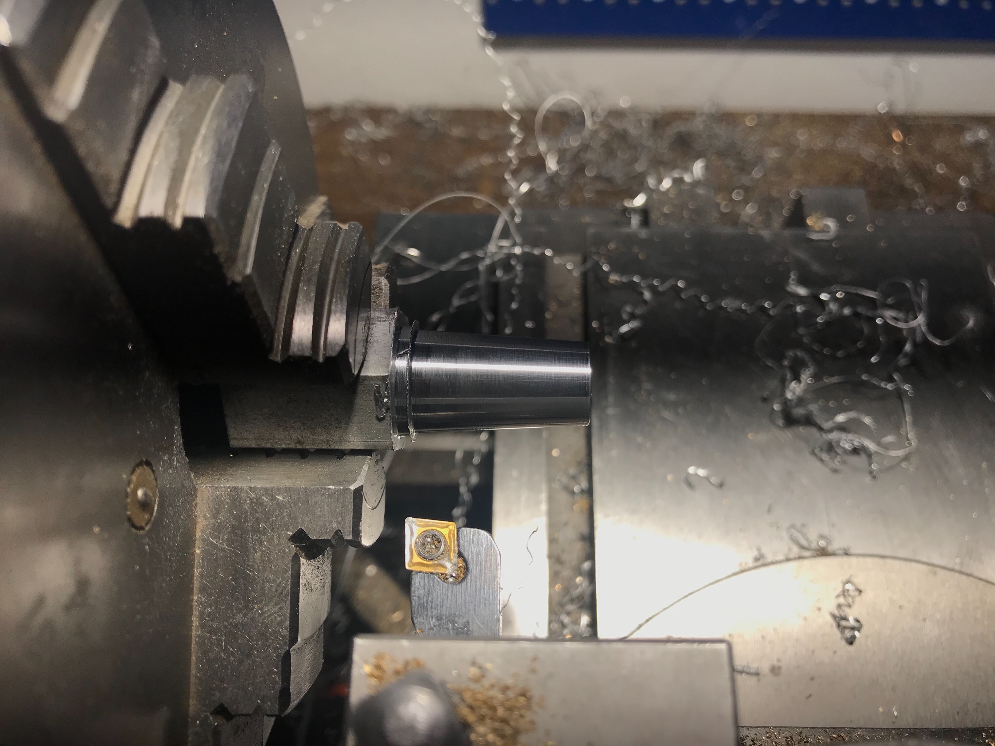

21 Nov 2017 16:37 - 21 Nov 2017 16:53 #102145 by vmihalca
Hi Fern,
I have played a bit more with nativecam and noticed a few issues:
1. I've switched to G95 to use feed per revolution so I've noticed I cannot enter 0.05 for example...when I type the 5, it trims the zeros and remains 5. However I was able to overcome this by typing 0.1 / 2
2. The calculator screen, remains orphaned, you can see in the image below, I have one on each space/desktop..I don't know how to call those boxes in the upper right corner. Those can't be closed..can you at least add a close button to it so that I can close it when its ignoring outside click events.
3. When turning Taper ODL for example, the values for X Begin and X End (when turning a taper with the smaller diameter towards the tailstock) seem to be reversed. I had to enter 14 for X begin and 11 for X end in order to get a taper that grows towards Z- . Are these really reversed or I'm not interpreting them correctly. Alternatively they could be renamed to something more meaningful.
Regarding multi start threading, I've done an attempt, it didn't came out as expected, but I will do some more experiments and then come back with some conclusions.
Begin X is the position where it starts cutting and End X where it stops. Maybe it should renamed with Large and Small but is it Diameter or Radius ? It think most of the time it would be diameter even if someone it working in radius mode. I will make it diameter
What I'm saying is that these are reversed, in order to work as you say I have to reverse the values between these two.
You can see in these images: photos.app.goo.gl/tPb2gAxxZvUcb2j83
