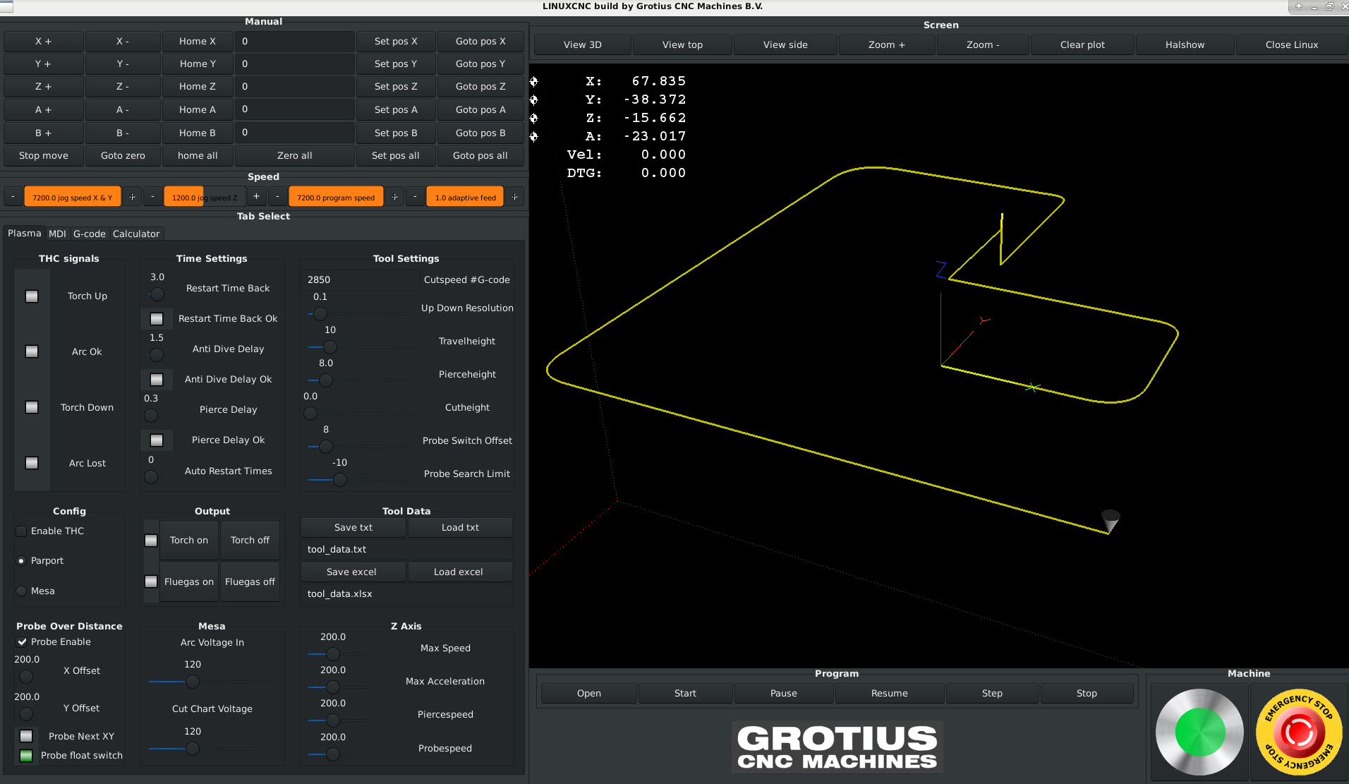

Hi Scuba,
I did a new install on clean pc.
It works without problems. I had to change the parport adres, because of different parport adres to get the machine out of
emergency brake.
Here the procedure, also available at the end of the github install readme file.
github.com/michelwijnja/external_offsets...lob/master/README.md
I will let this reprository what is is now, starred reprository
I will clone to new one and make my update's there. When update's are ready i will give a signal.
emergency brake.
Burn and install the iso cd debian stretch 64 bit : http://www.linuxcnc.org/testing-stretch-rtpreempt/linuxcnc-stretch-uspace-amd64-r11.iso
terminal :
1. sudo apt-get install git
2. git install https://github.com/michelwijnja/external_offsets_adaptive_feed.git linux_grotius
3. sudo apt-get install debhelper tcl8.6-dev tk8.6-dev libreadline-gplv2-dev asciidoc
4. sudo apt-get install dblatex docbook-xsl dvipng graphviz groff inkscape python-lxml source-highlight texlive-extra-utils
5. sudo apt-get install texlive-font-utils texlive-fonts-recommended texlive-lang-cyrillic texlive-lang-french texlive-lang-german
6. sudo apt-get install texlive-lang-polish texlive-lang-spanish texlive-latex-recommended w3c-linkchecker xsltproc asciidoc-dblatex
7. sudo apt-get install python-dev libxmu-dev libglu1-mesa-dev libgl1-mesa-dev libgtk2.0-dev gettext intltool
8. sudo apt-get install autoconf libboost-python-dev netcat libmodbus-dev libusb-1.0-0-dev
9. sudo apt-get install python-xlsxwriter
Make file in linux_grotius, bin folder, grotius => executable.
10. cd src
11. ./autogen.sh
12. ./configure
13. make -j2
14. sudo make setuid
15. cd ..
16. cd scripts
17. . ./rip-environment
19. linuxcnc
20. select grotius and make desktop shortcut
21. grotius desktop shortcut, select run in terminal
22. Look for parport adres : type in terminal : dmesg | grep par
23. Change the grotius.hal file with the correct parport adres, in my case : 0xe050
24. The complete line in grotius.hal = loadrt hal_parport cfg="0x1110 out 0x1120 out" (second parport is not used but has not to be deleted)
25. Ready.
Last edit: 15 Sep 2018 10:29 by Grotius.
