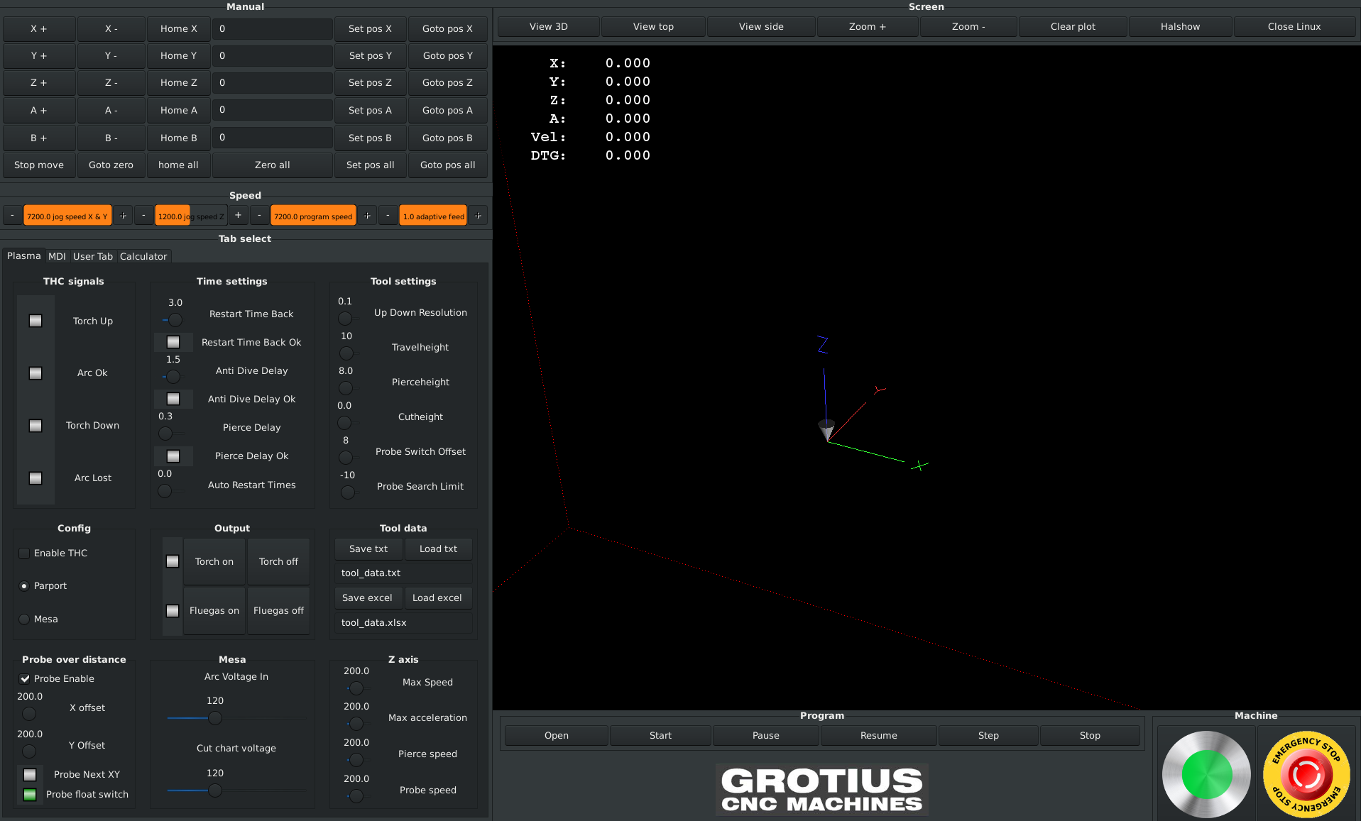

I will work to simplyfy the plasma screen again. Now almost every plasma parameter is implemented in the component.
Using tool list's, it will not longer be a must too see every parameter on the main screen.
So the screen will be simplyfied. This is the current layout.

Today i have started with python code for saving the plasma screen parameters to files that can be saved and load in the program.
It works !

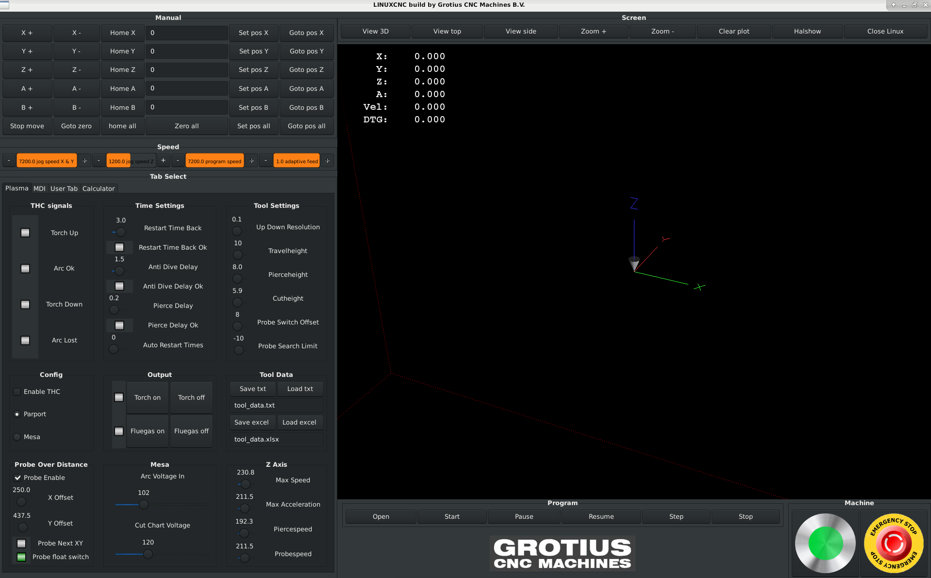

I have added a machine on button with 3 colors next to the emergency brake. Then it is better to see in what senario the machine is.
I have used it, and when it's orange i know it's only the internal emergency stop. So this is nice.
Color external emergency brake : red
Color internal emergency brake : orange
Color machine on : green
Maybe i add a blue color too, incicator for running program in auto mode.

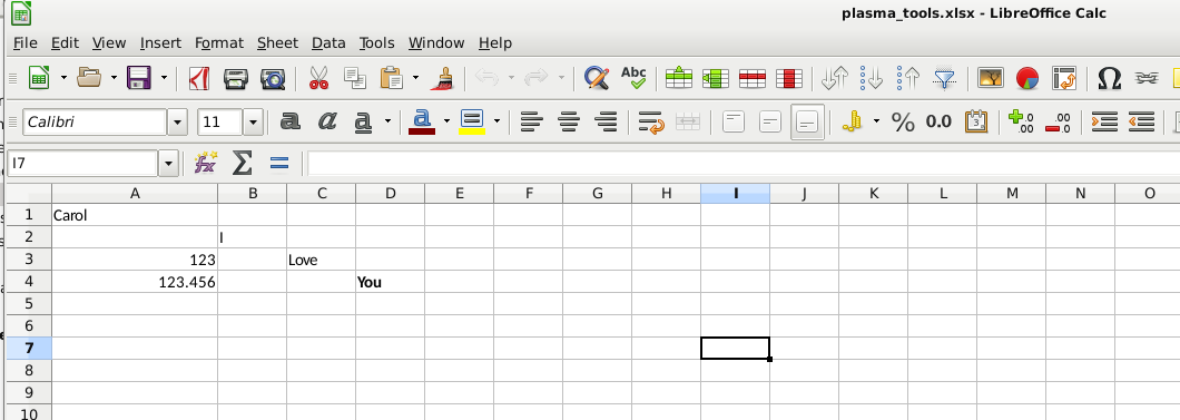

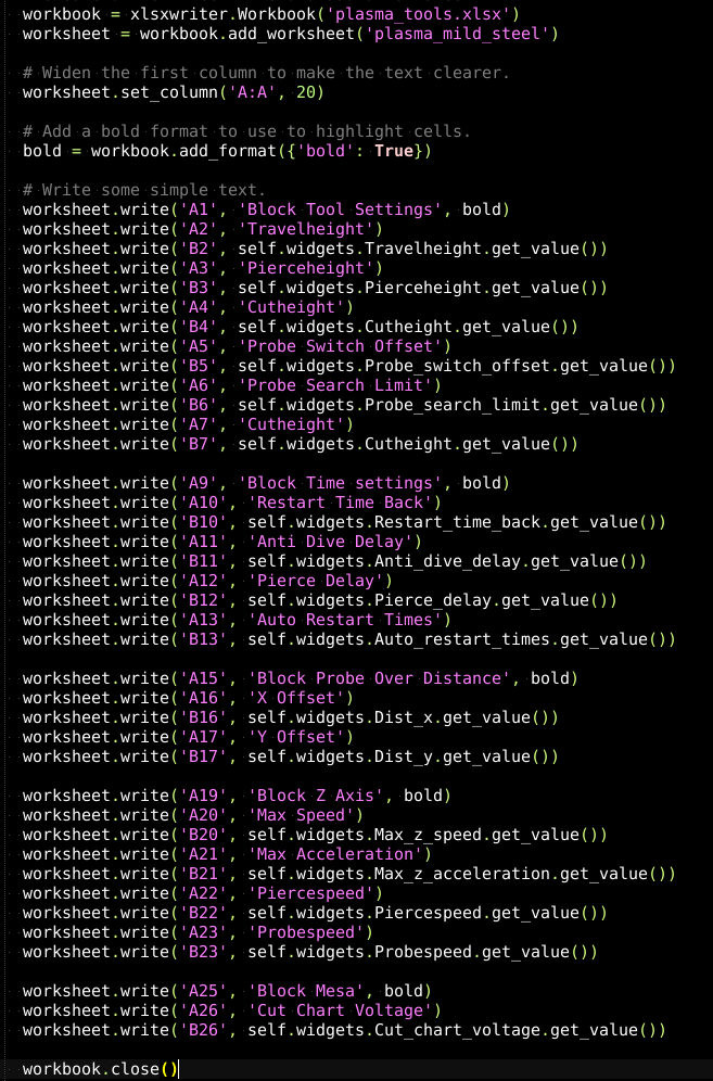

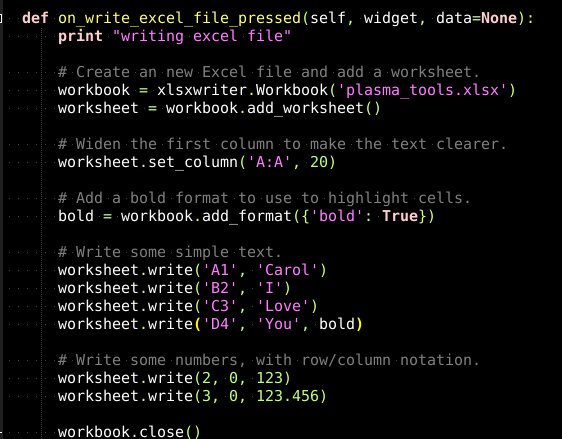

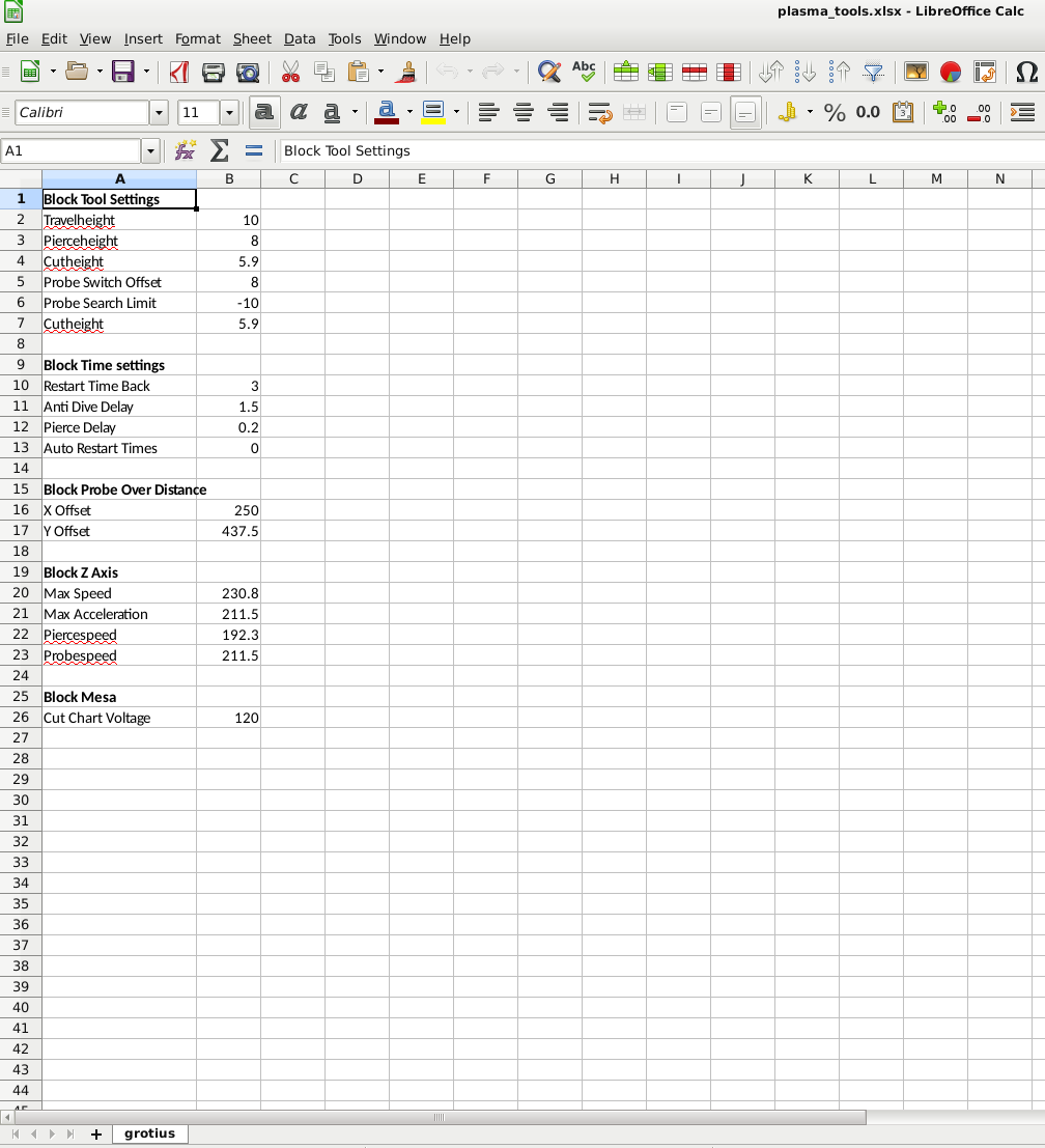

I asked Rod for advise earler today about saving the plasma tools and parameters in textfile or in excel file.
We do it in Excel for now. I just made a working code thanks to a online example in just 2 minutes.
The python code behind the glade screen :
The output file after clicking a screen button :
So we now can make beautiful torch and cutting chart's data files, load them into the program, save them and share them.
xlsxwriter.readthedocs.io/example_demo.html#ex-demo
For new forum readers who are thinking what is happening here and how ?
Linuxcnc

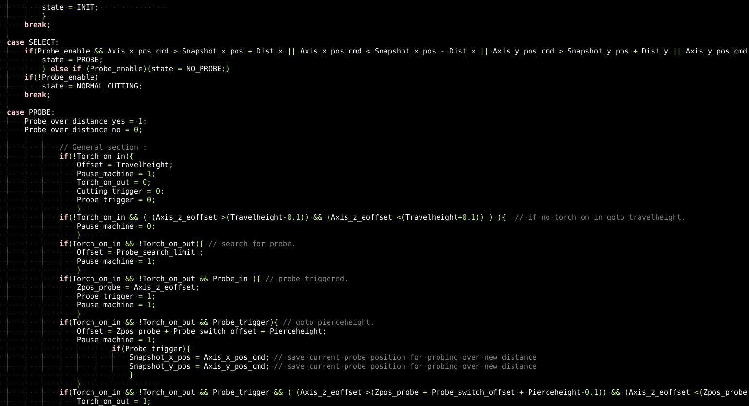

1. a file, C coded, compiled and real time component for torch height movement is loaded in linuxcnc. This file has many i / o.
2. a python coded linuxcnc user interface screen.
3. a excel sheet to store and load data.
The excel data is readed and writed by the python file (linuxcnc screen code) and passed to the real time component.
A short example of the c code :

Looks great Grotius. That is a weakness in Gmcappy I think. Whilst it resizes between 4:3 and 16:9 screens, the 16:9 version I think is far to spread out and is not intuitive to use. Yours looks better as the buttons are kept together.
- Grotius

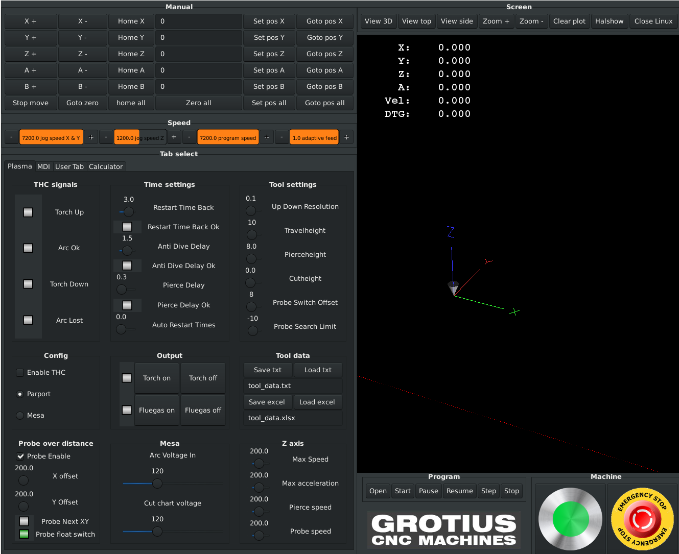

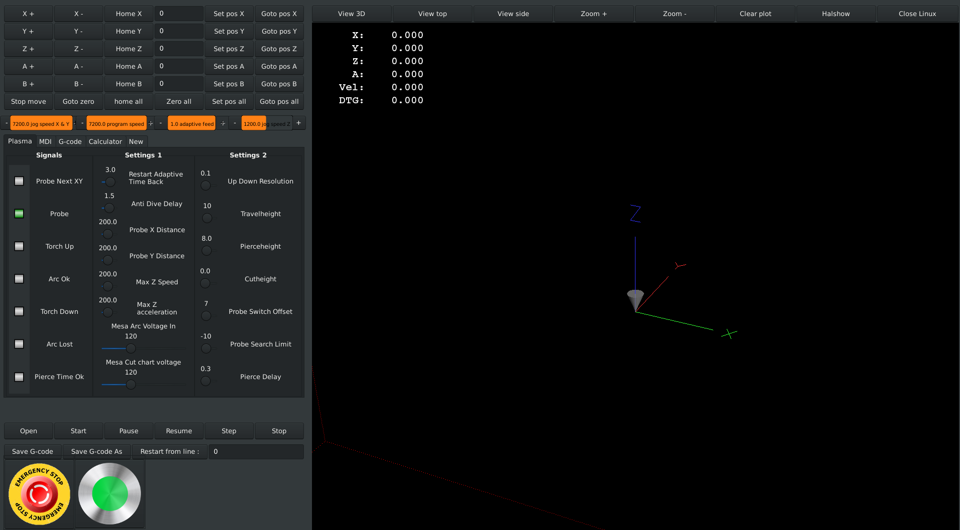

It's hard to make a screen that is clean and simple. I think the screen is a little bit to difficult to use at this moment.
But all parameters are used and important.
Now i am finished making a python tool list code in excel for writing data.
See, it works !
Tommorow i will expand the c code first with a few tiny things. Must add pierceheight_speed and probe_speed.
And a few more tiny things. Not very hard to do.
Last Saturday cutted several hours with this configuration. I was impressed.
One time the machine was probing where no material was. But it stopped probing at probe limit -10mm.
So i was happy. The travelheight is also the maximum value the thc can go up during cutting.
See, it works !

At this moment only the torch cutting data can be saved and loaded, so kerf width (plasma kerf) i will adapt in the saving file,
good mentioned. Better adapt now for later on. I will also adapt the kerf widht, cuttings speed etc to the screen.
Cutting speed i must test first with the variable g-code output later on this week. I want to see when the variable g-code
is loaded, and reloading.. After seeing that i can write the c code easely.
But i need to do some homework to also implement this kerf width. Later on i will study the inkscape python code.
In linux my previous tests with tool offset's where not so good. Maybe you know the trick? Program's like dxf2gcode i have
already studied and used, but are not good enough to use. Reason, if you have a dxf dwawing 2000x1000mm full of figures,
dxf2gcode can't handle it.
