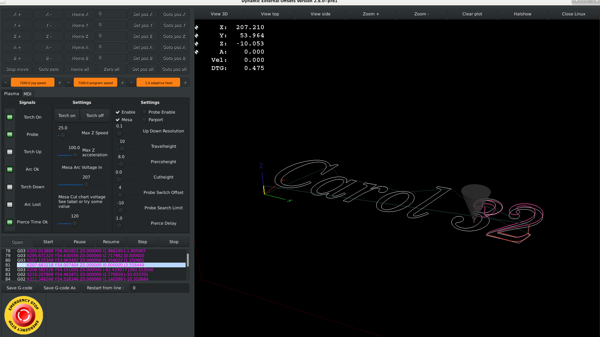

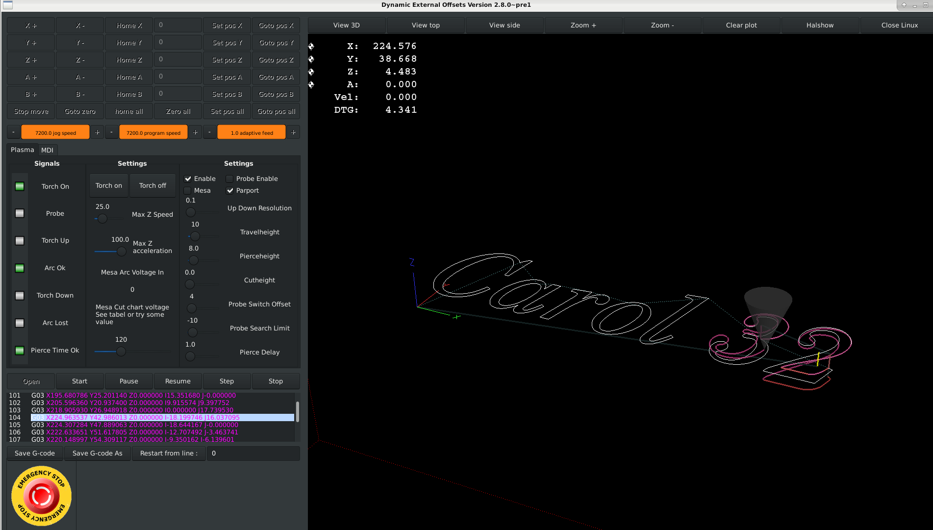

Dear Mesa users,
The test screen works without a fysical connection to your mesa equipment.
So you can test this function, and connect your mesa later on in the postgui.hal file.
It is now connected from the THC2.comp to the Glade file like this :
So replace the grotius.gui input for your mesa encoder input ((grotius_gui.Mesa_raw_voltage) replace with your Mesa encoder input) , and you are ready to go !
This feature is already updated on my git channel.
The picture is showing the Mesa feature. It works !
Now i tested the Mesa config a few times. It's a masterpiece code.
It's based for flat g-code. Only need m3 and m5. And a G21 at the begin for mm.
The rest is just like the Professor Toma did years ago, this is only programmed in C and Python.
Thanks to Github, our forum members, specially Rodw !
51 min. Forum is too old to add start time

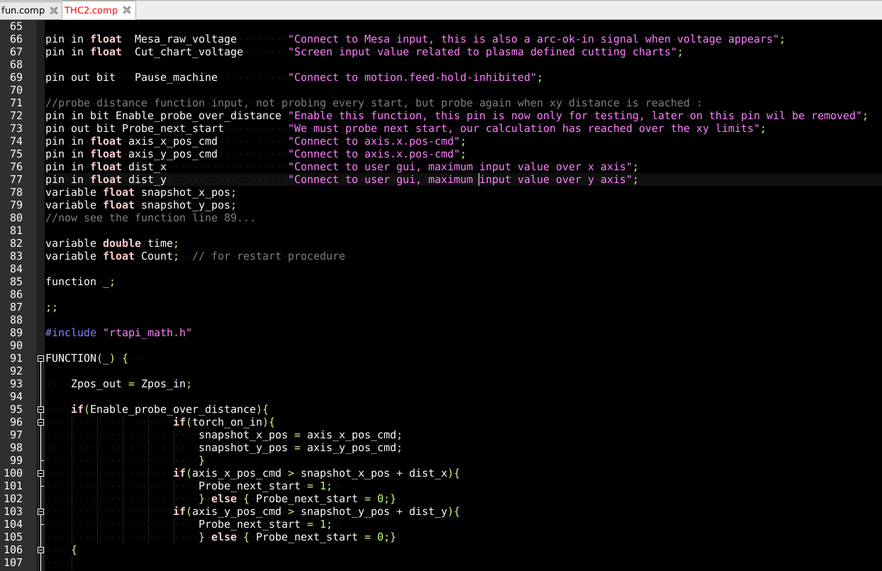

Okey now i want to write the code for the probe function, to give a x and y axis offset, instead of probing every start.
Rod has give some code information about this in circuliar formula. I write this in rectangular way because steel plates are
mostly bended over the short lenght. So in my case the Y-axis. So here a example the c code i am writing at the moment to
do make this happen.

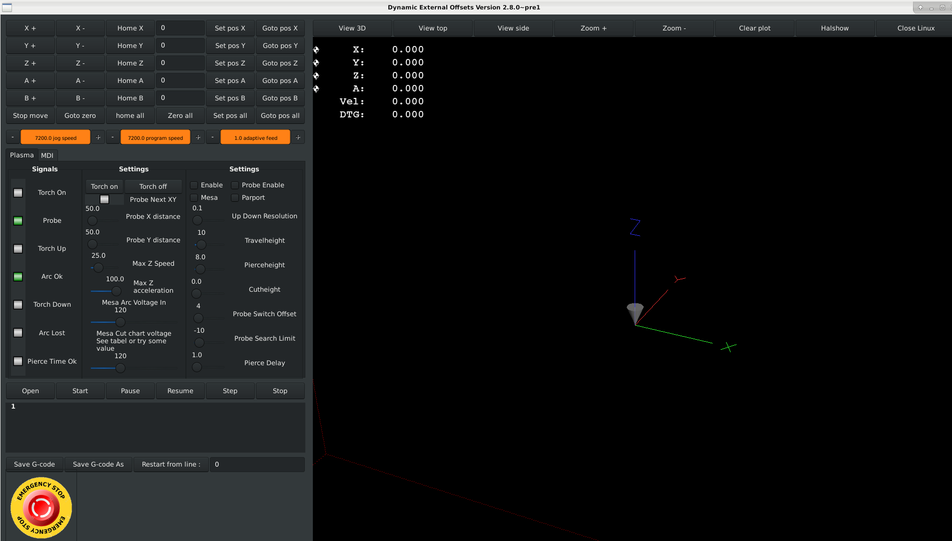

I have now learned how to use switch case in c programming.
The probe function over a certian x-y distance is now working. When this mode is on by selecting Probe Enable on the screen,
the probe is only probing when the screen input limit's are reached over x and y axis, the led is also indicating if the limits are reached.
When no probing is needed, the next start wil be on the last probe height.
When Probe Enable is off, the machine uses the cutheight input. I updated this to github.
The next item will be the auto restart procedure i think.
github.com/michelwijnja/external_offsets...components/THC2.comp
Last edit: 21 Aug 2018 15:27 by Grotius.
- Posts: 12176
- Thank you received: 4155
21 Aug 2018 16:41 - 21 Aug 2018 16:42 #116427
Replied by rodw on topic Useful Plasma Thread
Your code is starting to look good, you can streamline a lot of the conditionals which will speed execution. eg
where you do this:
you can skip a whole block if you do it like this:doing it this way will skip whole blocks of code and avoid multiple tests of the same condition. THe same applies for these repeated conditionals
When I get a moment, I'll see if I can edit what you've done.

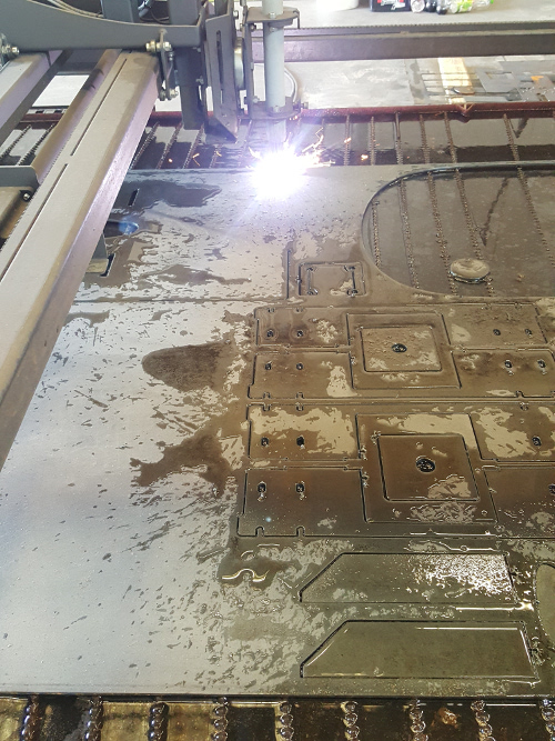

I have cutted several steel plates with linuxcnc.
The probe function over distance works great ! And also normal cutting without probe go's good. I prefer to use the probe function
with a xy distance of 200mm.
If there is a start fault, restart at certain line is a bit of a problem. I also tried this in the Gmocappy screen, same issue.
The error is "arc radius differs from ...." So restart at certain line was not possible for me, only restart from line 1 worked.
But i have a nice solution. Doing some adaptive feed negative, we start where we want at the current cutting path and restart is done by clicking enable off and on. Later in the code i will make a restart button and do this automaticly with adaptive feed negative for about 2 second's. The the machine wil move a little back and fires the torch again. So this is nice.
After loading a new ngc file i want to make a automatic clear plot command in the python code. The old ngc remains in the screen.
After clicking clear plot it is gone.
Proma has the D-t value. this is now 1.5 seconds at my machine. With a value of 0 second's the machine is diving at start a
little bit. So for Mesa and Proma users i will make anti dive button with a timer function.
I have to check the glade auto screen resize option's for different monitor resolution's.
I tried to make a startup ngc code in the ini file, for Macro code's M52 P1, this is not working. Adapting this code as mdi code
in the c code is the solution then i think.
What i am missing also is a feed overide control on my screen, and a control to manage the z axis speed seperatly from x and y axis.
For the rest i coded the component in case's. But with to many cases i mentioned problem's. So what i am using at the moment,
a component with 3 or 4 cases, this is going perfectos.
Almost forgot. Between the M5 and M3, when traveling at travelheight i need to check the arc ok signal / torch volts in. One time the torch stayed on. So when monitoring that, there will be no second time.
