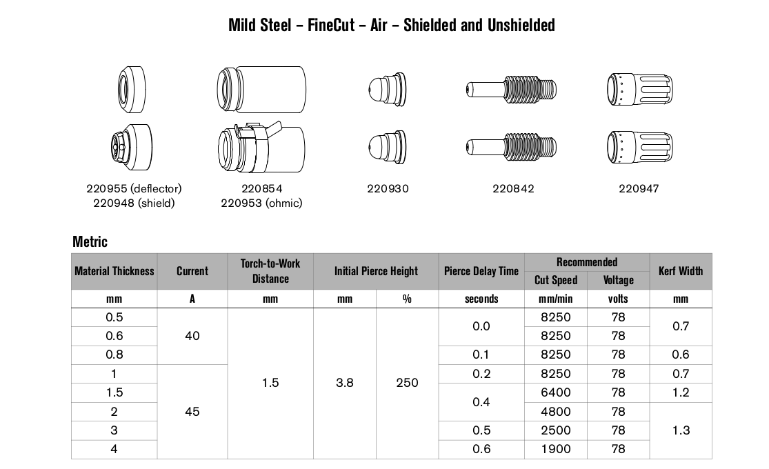

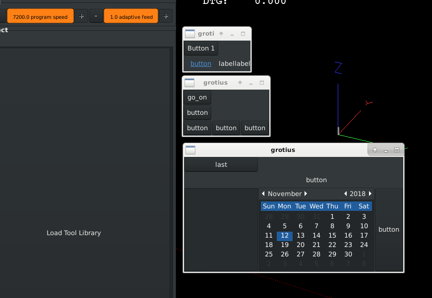

Hi Scuba,
Nice you have some time to finish your linuxcnc machine.
I am trying to building some dynamic input tap's for future plasma tool librarie's. In python it is tricky. Now it's working.
Trying to make some databases on advice of Rod, but i think custom excel file's are the most easy way to use in combination with dynamic user gui input taps.
I have to write the output to : Modbuss (plasma inverter), Linuxcnc THC2 plasma component, To hal section ( gcode variable ), and other important tool related stuff. So next thing to do is make the first excel cutting chart for the 45 amp's.
Don't look at the text, it's just for testing. First tap is above, then next tap is loaded, then thirt tap is loaded and first can be closed etc.
So now i must start in excel to map everything ....
If i can upload 7mb, the 45xp manual was here.
If there was a donate section, i could donate for extra user space.
