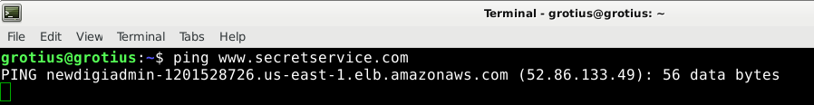

If you ping the secret service, you get this in terminal :
If you type it in google you get no secret service ....
You get this : www.yeah.com
So nothing is what is seems to be. In other words. Write a coded text with Israel and see what happens.
