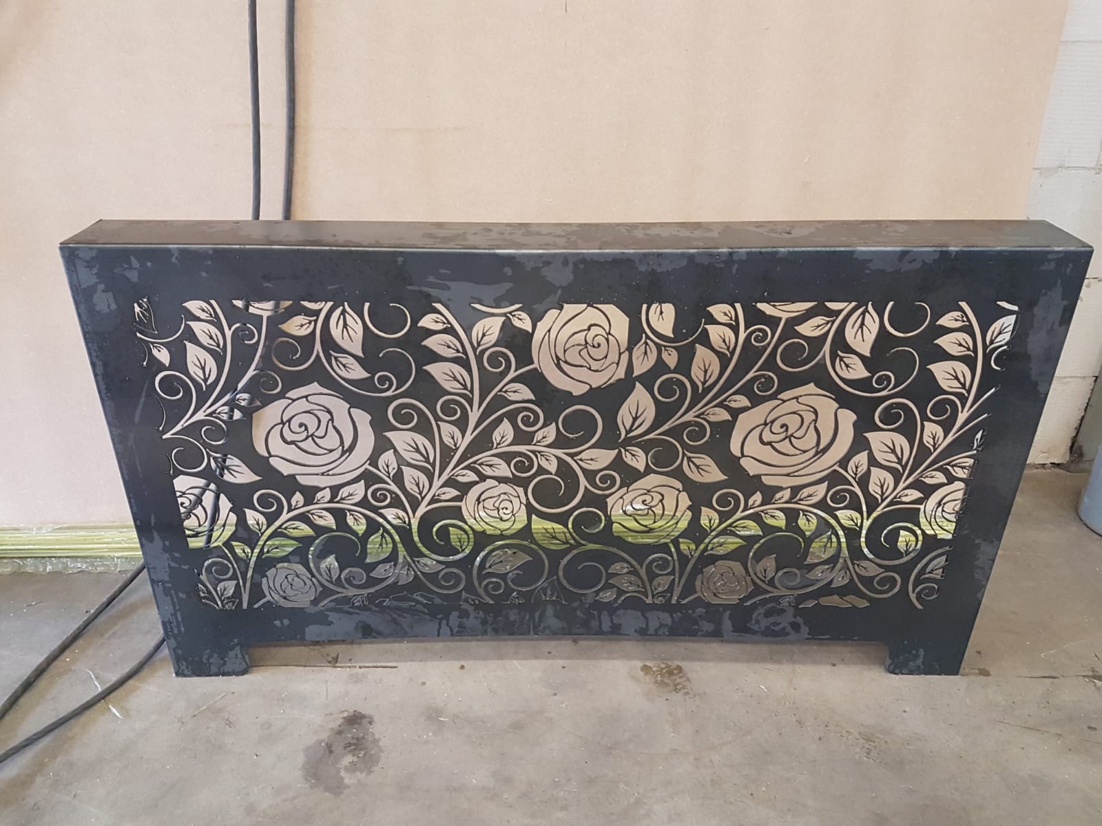

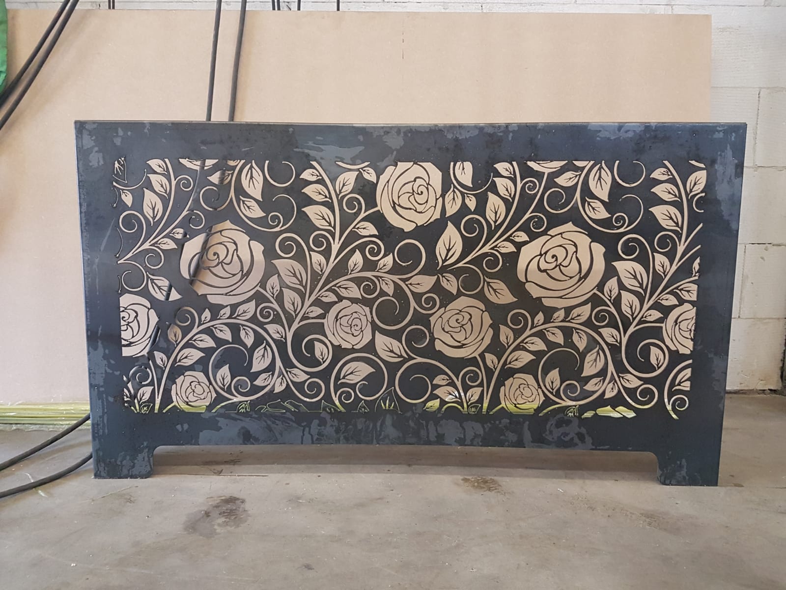

28 Aug 2018 13:48 - 28 Aug 2018 13:48 #116729
by Grotius
Replied by Grotius on topic Useful Plasma Thread
Last edit: 28 Aug 2018 13:48 by Grotius.
- snugglylovemuffin
- Posts: 209
- Thank you received: 11
28 Aug 2018 14:02 #116731
by snugglylovemuffin
Replied by snugglylovemuffin on topic Useful Plasma Thread
That's pretty amazing, how much kerf does your torch have?
- Grotius
- Posts: 2419
- Thank you received: 2349
28 Aug 2018 14:32 - 28 Aug 2018 14:38 #116733
by Grotius
Last edit: 28 Aug 2018 14:38 by Grotius.

28 Aug 2018 16:35 #116740
Replied by tommylight on topic Useful Plasma Thread
That is niceeeeeeeeeeeeeeeee !!!
