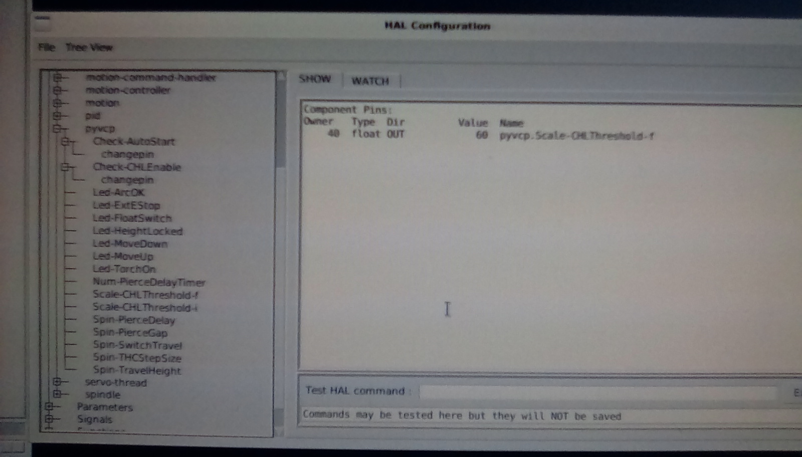

If you look in your ini file your POST_GUI file is defined as being THC_7i92_7i77_vcp.hal (Remember everything in Linuxcnc is configurable)
So now lets focus on the error you reported. It said that there was an error on this line in THC_7i92_7i77_vcp.hal
I had a look in your THC_7i92_7i77_vcp.xml file and I think all you will have to do is to change this line to refer to a pin that does exist. eg.
# A file to hook pyvcp to hal signals
POSTGUI_HALFILE = THC_7i92_7i77_vcp.halSo now lets focus on the error you reported. It said that there was an error on this line in THC_7i92_7i77_vcp.hal
net CHLThreshold pyvcp.Scale-CHLThreshold-f => scale.0.inI had a look in your THC_7i92_7i77_vcp.xml file and I think all you will have to do is to change this line to refer to a pin that does exist. eg.
net CHLThreshold pyvcp.Scale-CHLThreshold => scale.0.inPlease Log in or Create an account to join the conversation.

If you're suggestion was to remove the -f from threshold-f, this just threw the same error as before, sans the -f. I suspect, however, that this wasn't what you had in mind. I understand the concept of "wiring" in the context of linuxcnc, however I'm not rightly familiar with the particulars. I'll snag my entire file and post it up here shortly.

Comment out the problem line so your system loads and then use Halshow (which is available from the GUI in Axis and Gmocappy) and explore the pins being exported by pyvcp. If you can't see any, revert to Andy's advice as it might be a post_gui thing.
Your error has told you a pin is missing, so you need to look at what pins exist. sometimes its a simple typo which I thought it was as in the XML the pin ending in -f did not exist.

Issue is solved; however I'm back to where I was last time I tried the TOMA setup:
THC.hal:157:Pin 'joint.3.motor-pos-cmd' was already linked to signal 'z-pos-cmd'
Not sure how to negotiate this particular hurdle.
