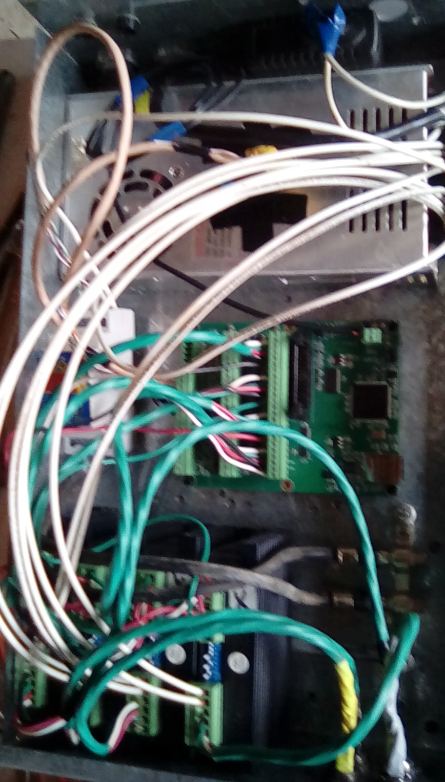

27 Oct 2018 21:14 #119533
by snugglylovemuffin
Replied by snugglylovemuffin on topic Snuggly's Plasma Build
Here's my controller, ready for testing. I'm excited to build a second machine that will be 100x better and address all of this current tables faults.
I'll start posting my machine HAL here soon for you guys.
Oh yeah, the motorcycle is an '82 Yamaha Virago XV920
- Grotius
- Posts: 2419
- Thank you received: 2349
28 Oct 2018 15:05 #119565
by Grotius
Replied by Grotius on topic Snuggly's Plasma Build
Hi Snuggly,
Nice video. You have a nice voice also, it sound's relaxing.
Okey, if you have your machine working xyz and plasma start, you could do some test without a torch height control.
I prefer you start with this. After some test cutting, you post a video. And we will go on to the next level.
