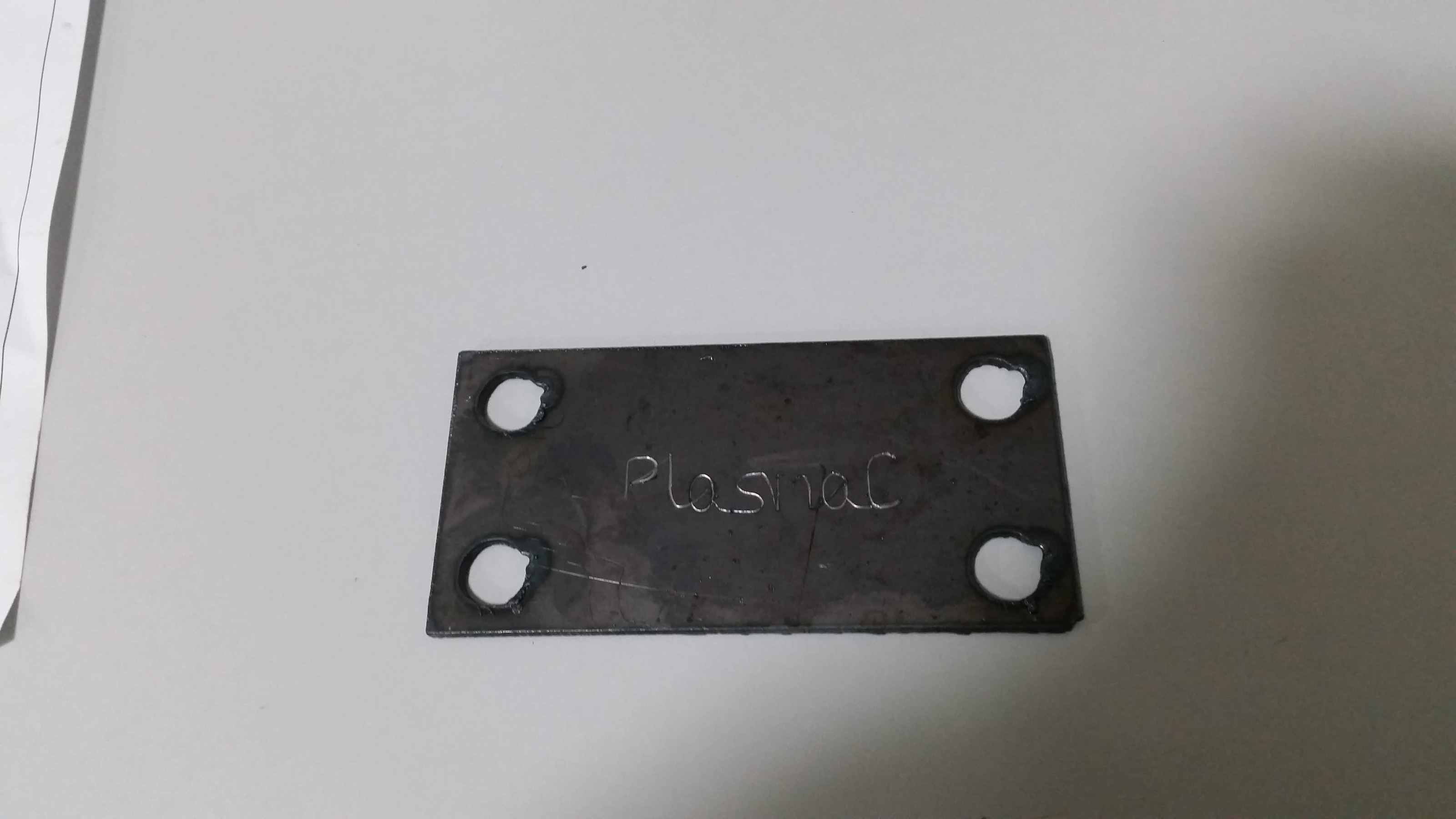

Make sure that the DXF is saved in R12 format.

Well today was not a total waste Phill,
I had a similar problem, I solved it by exploding the text into its segments.
I have attached the DXF to this post.

Edit: It seemed to work on your dxf file. Well it did up until the limit imposed by the 'free' version of SheetCam.

I have not played much with text in DXF files but: the terminology changes from program to program but putting my old printers hat on (eg. using Adobe Illustrator teminology) you would need to convert your text to curves so the fonts are no longer required. This process replaces the vectors defined in the font with vectors embedded in the drawing, The other tricky thing is you need a single point font. When converted to curves, fonts usually end up with an outline and a fill. Its easy to delete the fill, but then you end up with two seperate lines to engrave, Stefan's font only comprises a single line...

What CAD program are you using Phill,
With that file, when I imported it into Sheetcam this morning, The first S was not showing up in sheetcam, I selected it and exploded the polyline then reimported it and it showed up.
I use Autocad 2016 LT.

I use QCad and I worked out I had to explode the text before SheetCam liked it.
Did you try the latest post I sent?
