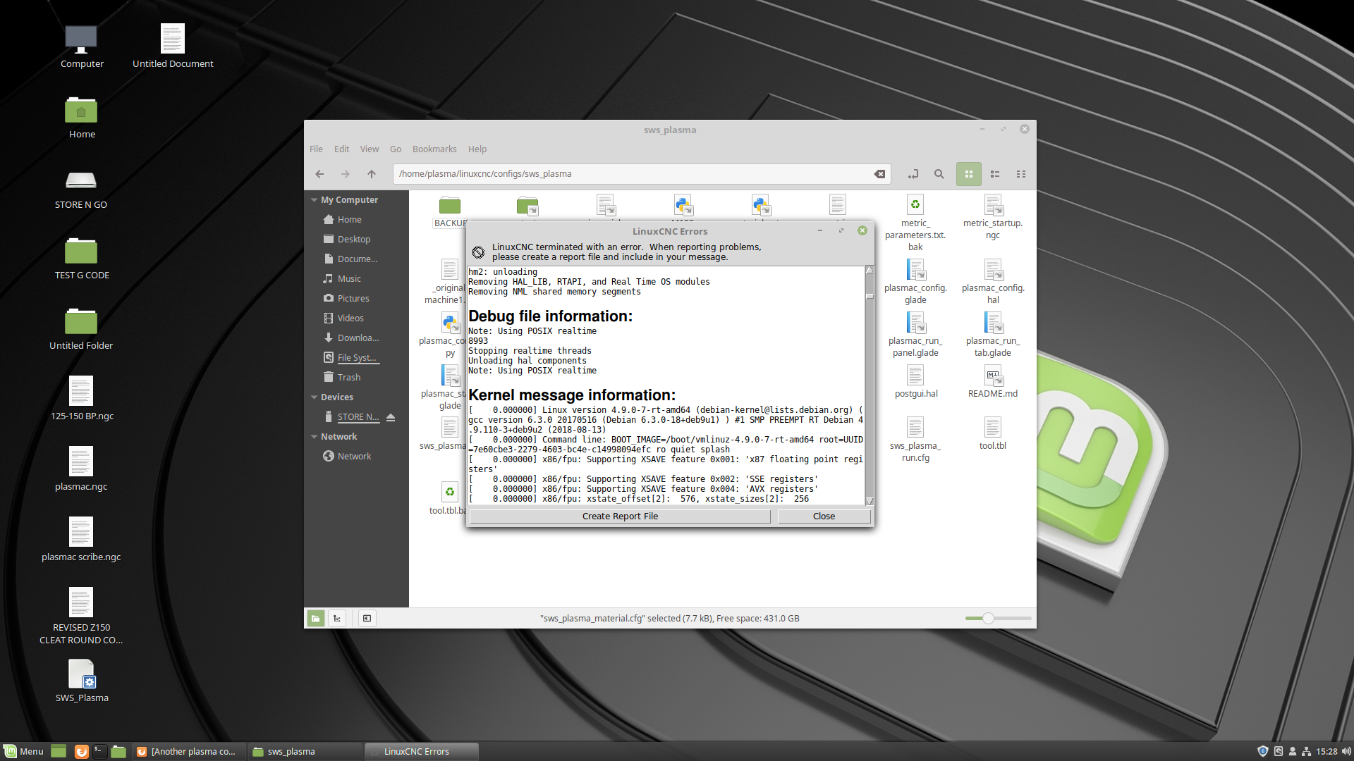

Did you reload the LinuxCNC tool table after you edited it?

Can't see anything there that helps, can you run from a terminal and paste all the output.

twopass: Error in file ./sws_plasma_connections.hal:
Pin 'plasmac.air-scribe-arm' does not exist

22 Aug 2019 05:37 #142780
by phillc54
Did you run make?
- phillc54
- Posts: 5711
- Thank you received: 2100
22 Aug 2019 05:40 #142781
by phillc54
OK, I see what I did, renamed something I shouldn't have...
Give me a few minutes and I'll update again.
- thefabricator03
- Visitor
22 Aug 2019 05:41 #142782
by thefabricator03
Replied by thefabricator03 on topic Another plasma component...
Yes and Sudo make setuid.

22 Aug 2019 05:51 #142783
by phillc54
Give it a try now.
- thefabricator03
- Visitor
22 Aug 2019 05:53 #142784
by thefabricator03
Working again, Thanks.

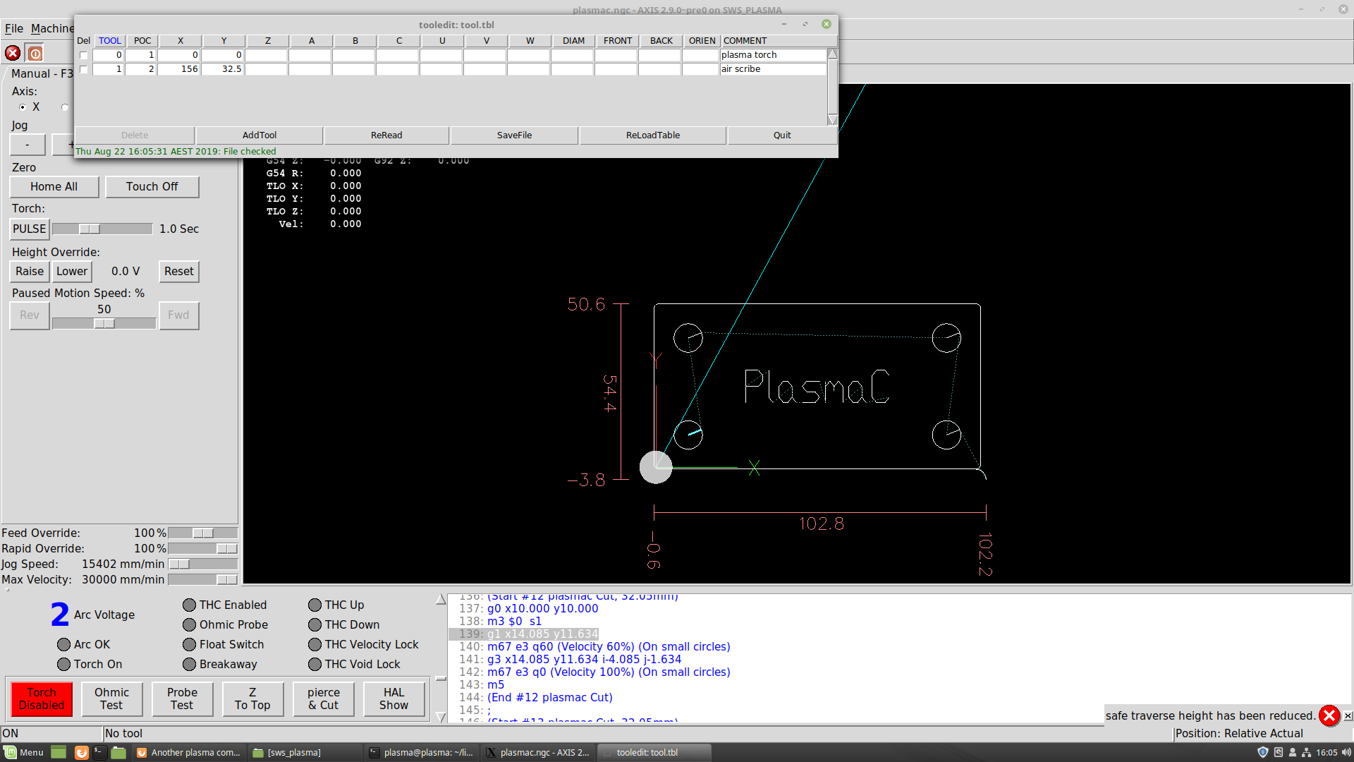

- thefabricator03
- Visitor
22 Aug 2019 06:06 - 22 Aug 2019 06:12 #142789
by thefabricator03
Now for the offset,
I have set the tool table as per below, Is that correct?
