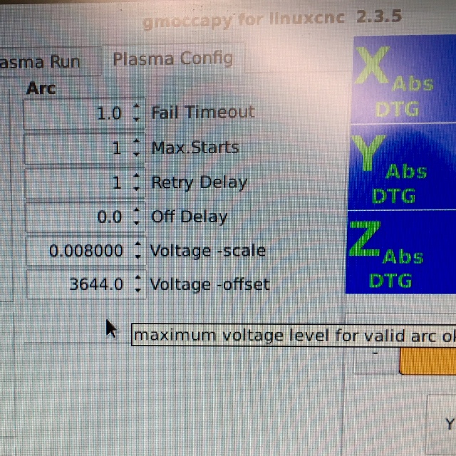

How are you guys tricking the arc ok. I have been trying to cut for the last few hrs and all I do is pop a hole and it alarms out saying no arc detected. My voltage looks good on the THCAD10. Is there a way to just delete that function?

21 May 2019 20:16 #134525
by JTknives
Replied by JTknives on topic Another plasma component...
- Posts: 12161
- Thank you received: 4151
21 May 2019 20:23 #134527
I suspect that is hidden becasue of the Plasmac mode you have selected. Check the notes in the ini file. That might have been a bit my fault becasue I probably assumed you have an arcOK signal when I wrote my how to.
Replied by rodw on topic Another plasma component...
I can see the text from a button that’s not there asking for arc ok voltage. But there is nothing there to click on.
