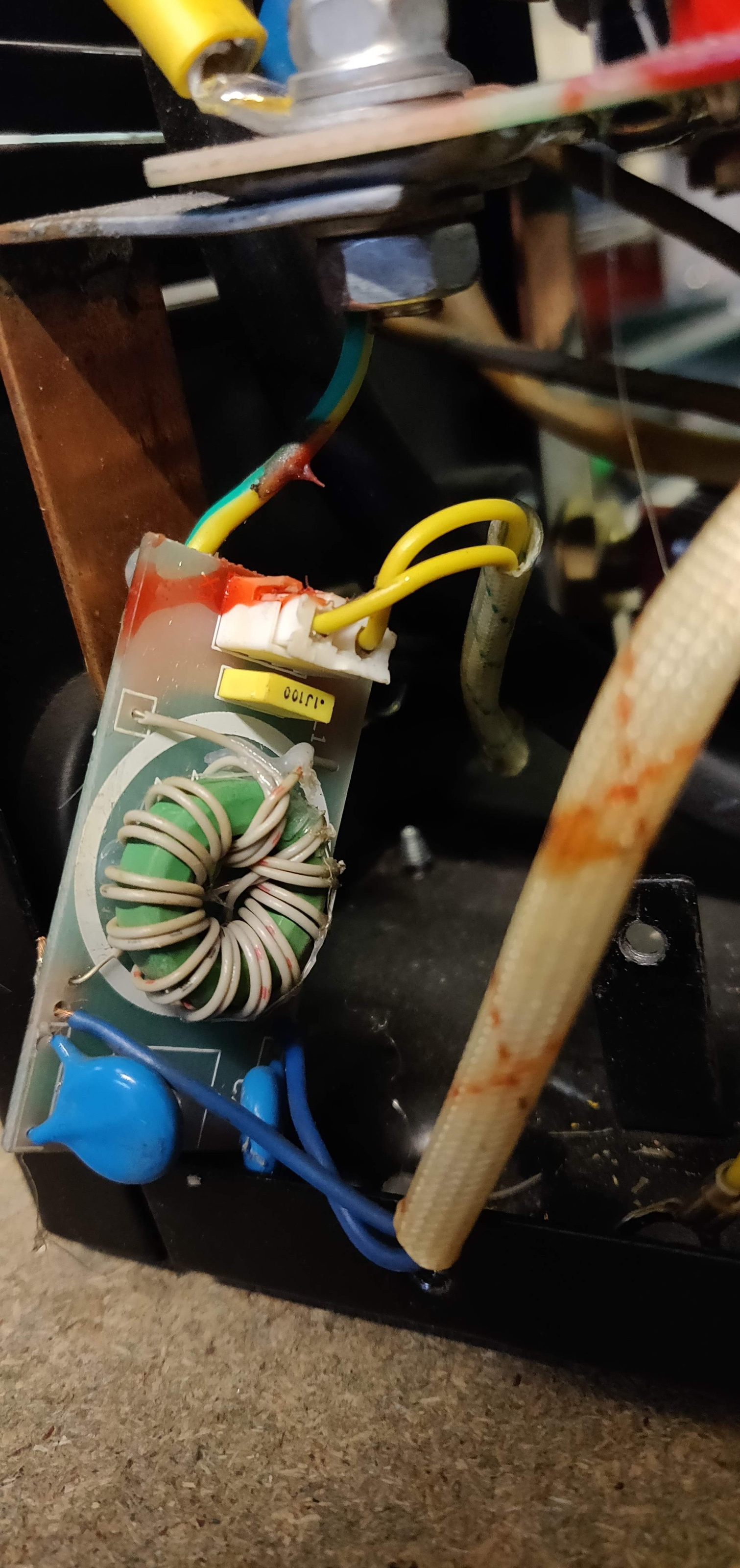

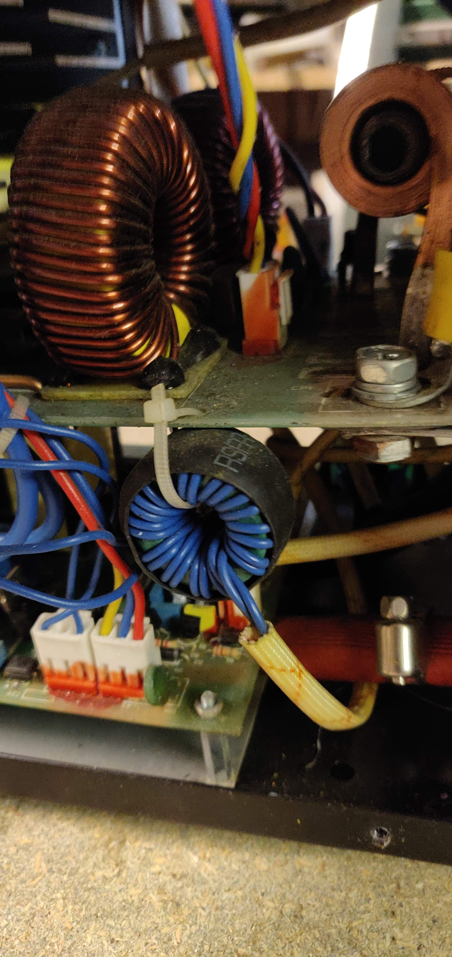

What is the correct way to connect the 7i96 isolated output TB3 pins to my Cut40 plasma for torch start.
The yellow wires in the first pic go to the toroidal are the start wires that went to the hand torch then the blue wires from the toroidal
go to the second toroidal as in the second pic.
I am not sure how it works but I suspect the switch makes a shorted turn on the toroidal to activate the torch start.

That might take a relay since its a AC signal you are switching
Can you measure the open circuit AC voltage on the yellow wires?
You can switch AC signals with the 7I96 outputs by using 2 outputs in series
( AC1 ==> OUT0+ ==> OUT0- ==> OUT1- ==> OUT1+ ==> AC2 )
_BUT_ only up to 24VAC
Edit
Note that without measurements, I cannot be sure that the switch signal is AC.
(I was assuming the toroid connected to the yellow wires was a transformer,
but it could wired as a common mode choke.) So the signal needs to be measured
to determine the voltage whether its AC or DC, and perhaps the current that's switched
Edit
Last edit: 28 Sep 2019 14:39 by PCW.

28 Sep 2019 16:47 #146495
by Clive S
Peter. I have measured it open circuit it shows 25.4vDC and about 0.9v AC current is about 1.6mA when torch on.
Replied by Clive S on topic New Plasma build question
Edit

28 Sep 2019 23:26 #146513
by islander261
Replied by islander261 on topic New Plasma build question
I would shoot for complete galvanic isolation using a relay to be totaly safe The few ms of delay introduced by the relay will be short compared to the inverter control.
John
John
- Posts: 21980
- Thank you received: 7480
28 Sep 2019 23:46 #146519
Replied by tommylight on topic New Plasma build question
I wholly agree. Use a relay. Please !I would shoot for complete galvanic isolation using a relay to be totaly safe The few ms of delay introduced by the relay will be short compared to the inverter control.

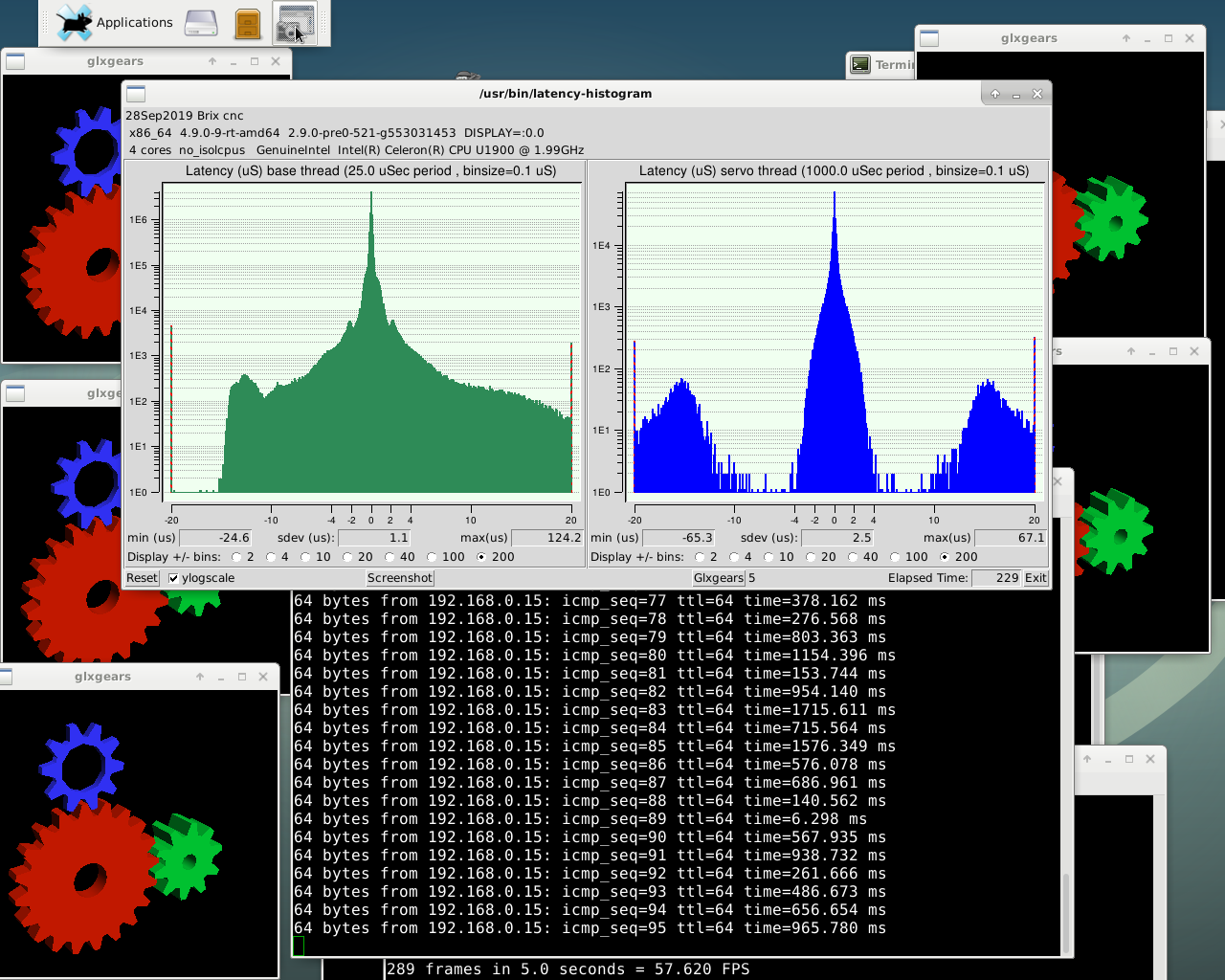

29 Sep 2019 10:21 - 29 Sep 2019 10:23 #146550
by Clive S
Ok back to my Brix pc problem. Using the same SSD in the Brix the machine motors run rough and give a lot of errors but when Iswap the ssd to another pc it runs fine and smooth.
Does this give any clues, This was running for about 10 mins. I have tried disabling all what I can in the bios.
Edit: I have also used isoicpus to disable cores 2,3 and tried it with disabling 0,1 to no avail.
Last edit: 29 Sep 2019 10:23 by Clive S.
- Posts: 21980
29 Sep 2019 12:31 #146552
Is it connected directly to the PC?
The reply time on the ping is way off and all over the place.
The below was suggested by PCW and it does work.
sudo ethtool -C [your_ethernet_device-name] rx-usecs 0

29 Sep 2019 12:38 - 29 Sep 2019 12:39 #146553
by Clive S
Yes it is connected dirrct I was trying to stress it ,the lp was my router through a USB dongle
Last edit: 29 Sep 2019 12:39 by Clive S.
- Posts: 21980
29 Sep 2019 12:58 #146555
Ping the Mesa board.
