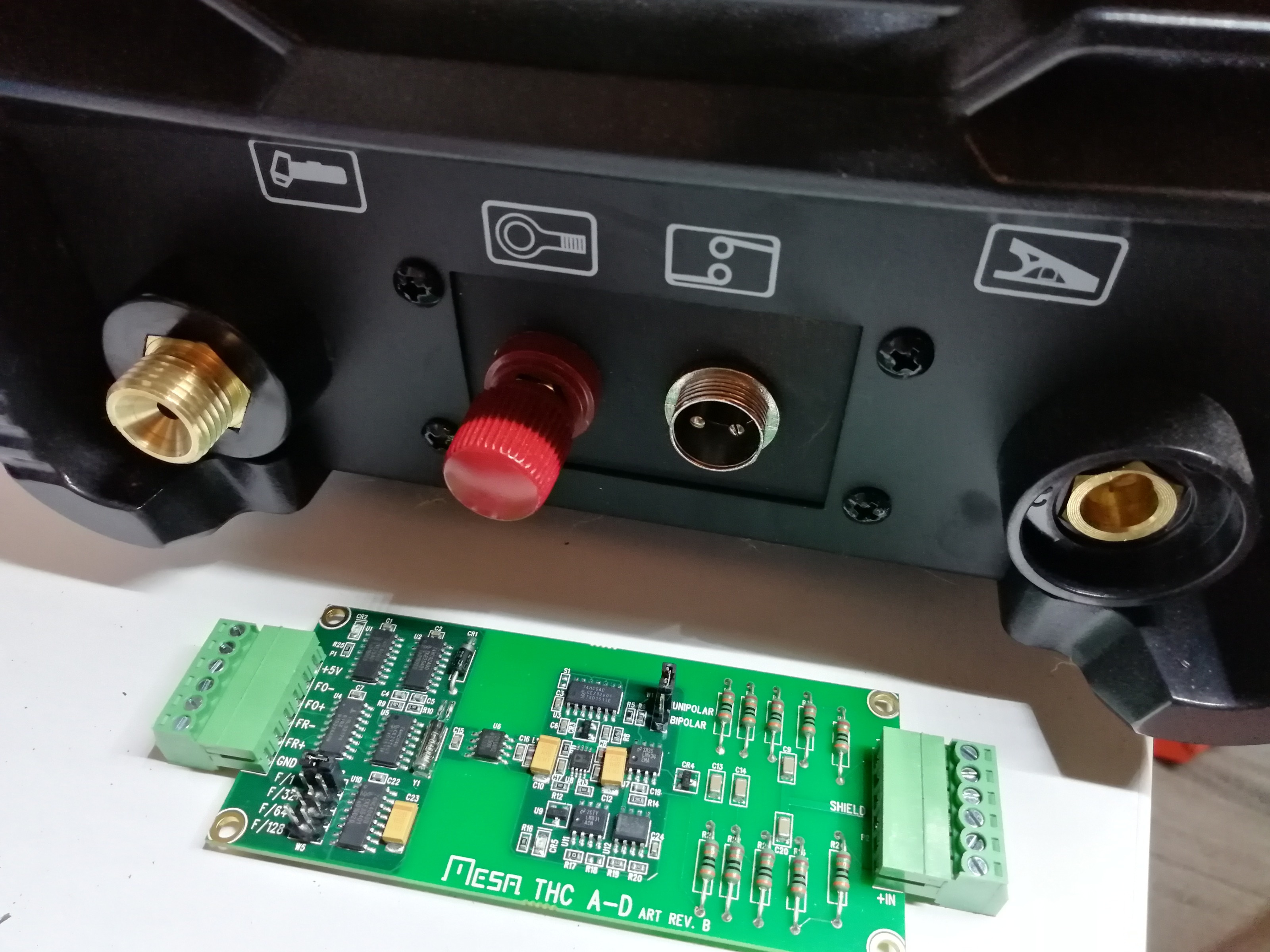

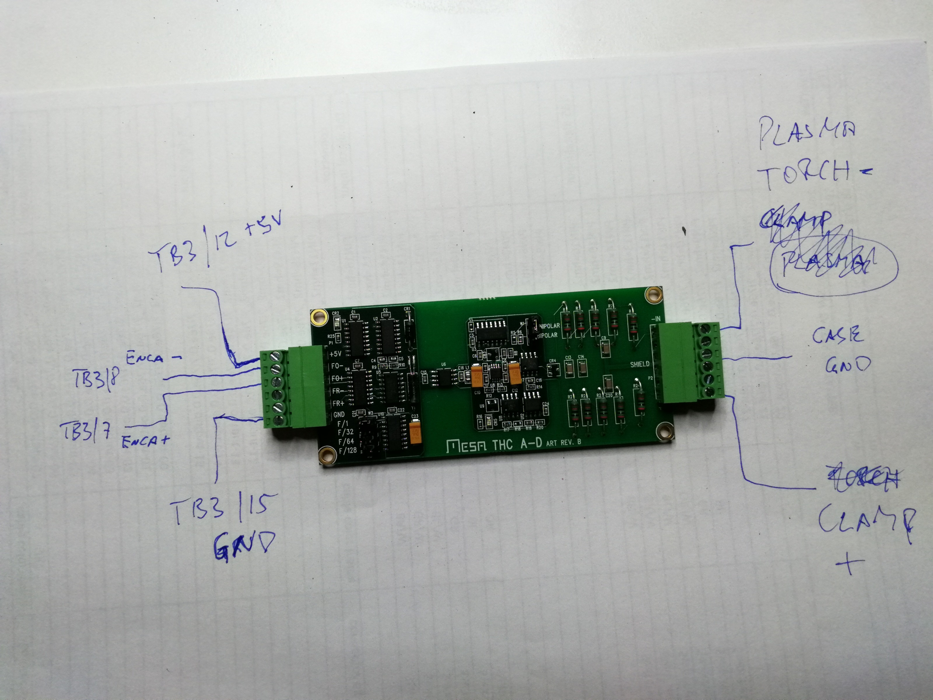

Still haven't had the guts to switch on the replacement 7i76e since mine burnt.
I continue cabling and documenting which is fun too.
Next step the installation of the thcad 300
Please check following and correct if wrong.
Don't know what the Red screw terminal connector in the middle is..
Left torch - , unknown, torch relais input, clamp+
Guess I take it directly from here...
Thank you!

If it helps I put a 1M resistor in each leg. But I used a THC-10
photos.app.goo.gl/PdDUHF2uHGWHWLPw7
Last edit: 18 Feb 2020 22:39 by Clive S.
18 Feb 2020 23:09 #157779 by rodw
Replied by rodw on topic New Plasma build question
Not necessary on the thcad-300

18 Feb 2020 23:49 #157780 by thefabricator03
Replied by thefabricator03 on topic New Plasma build question
Admiring the CAD skills. That THCAD looks so lifelike :)

19 Feb 2020 05:17 - 19 Feb 2020 08:00 #157811 by CNCFred
Replied by CNCFred on topic New Plasma build question
Thank you for recognizing the effort I put into my drawings. :-)
So no correction means go ahead.
And my 7i76e still runs......

19 Feb 2020 06:01 #157813 by rodw
Yes, I'm sure you read the plasma primer! its all in there (without the amazing CAD work)!
The following user(s) said Thank You: CNCFred
19 Feb 2020 08:00 #157815 by CNCFred
Read it some time ago, but couldn't remember it was in there!
Pitty I chose thcad 300 since I thought it is the only way to connect to high V. Didn't know about the 1Mohm solution for thcad 10.
If I get finally a Hypertherm got to change that too.
