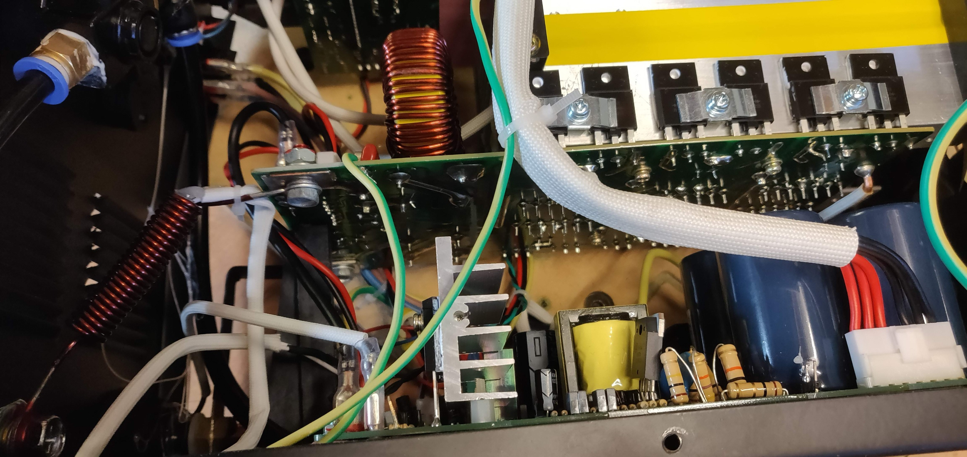

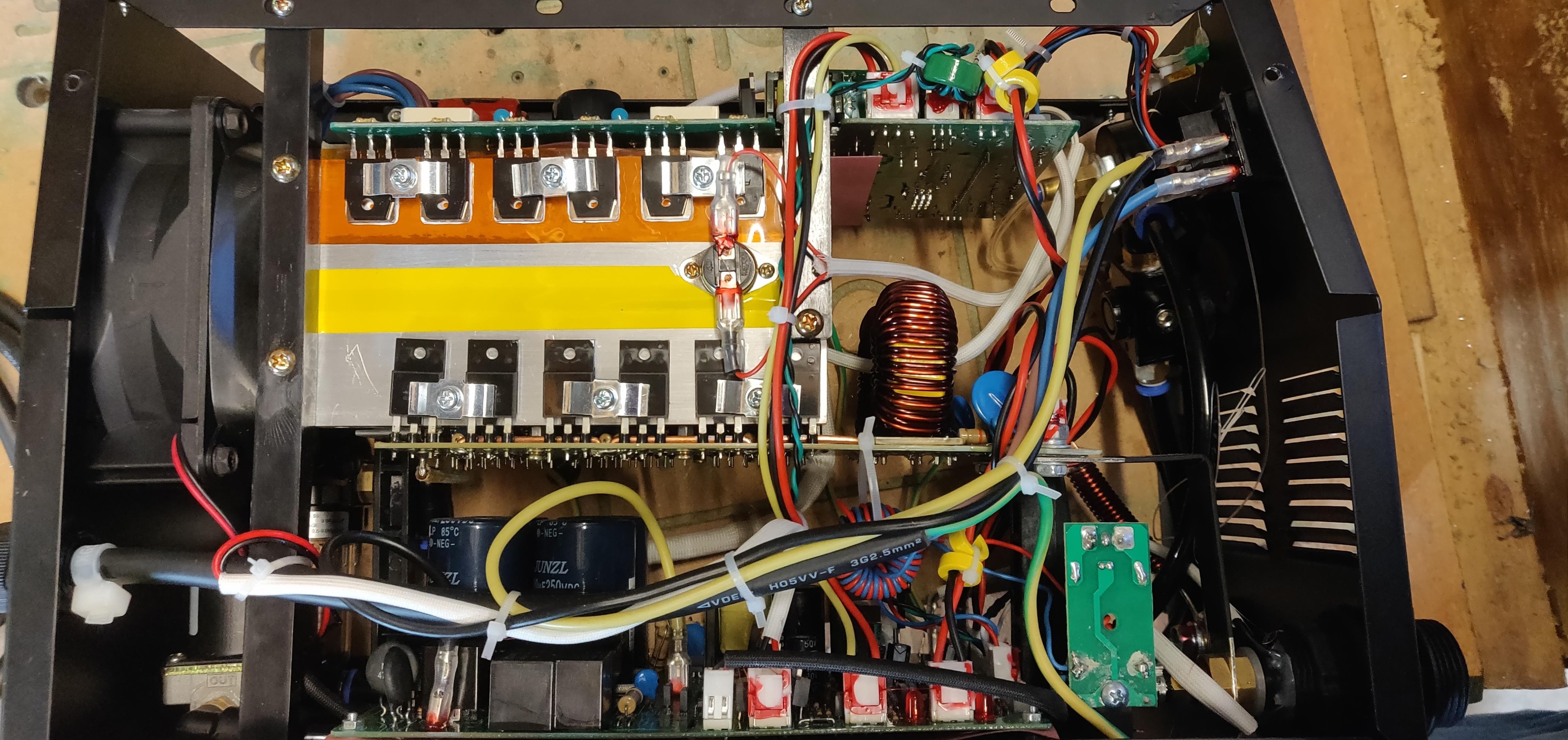

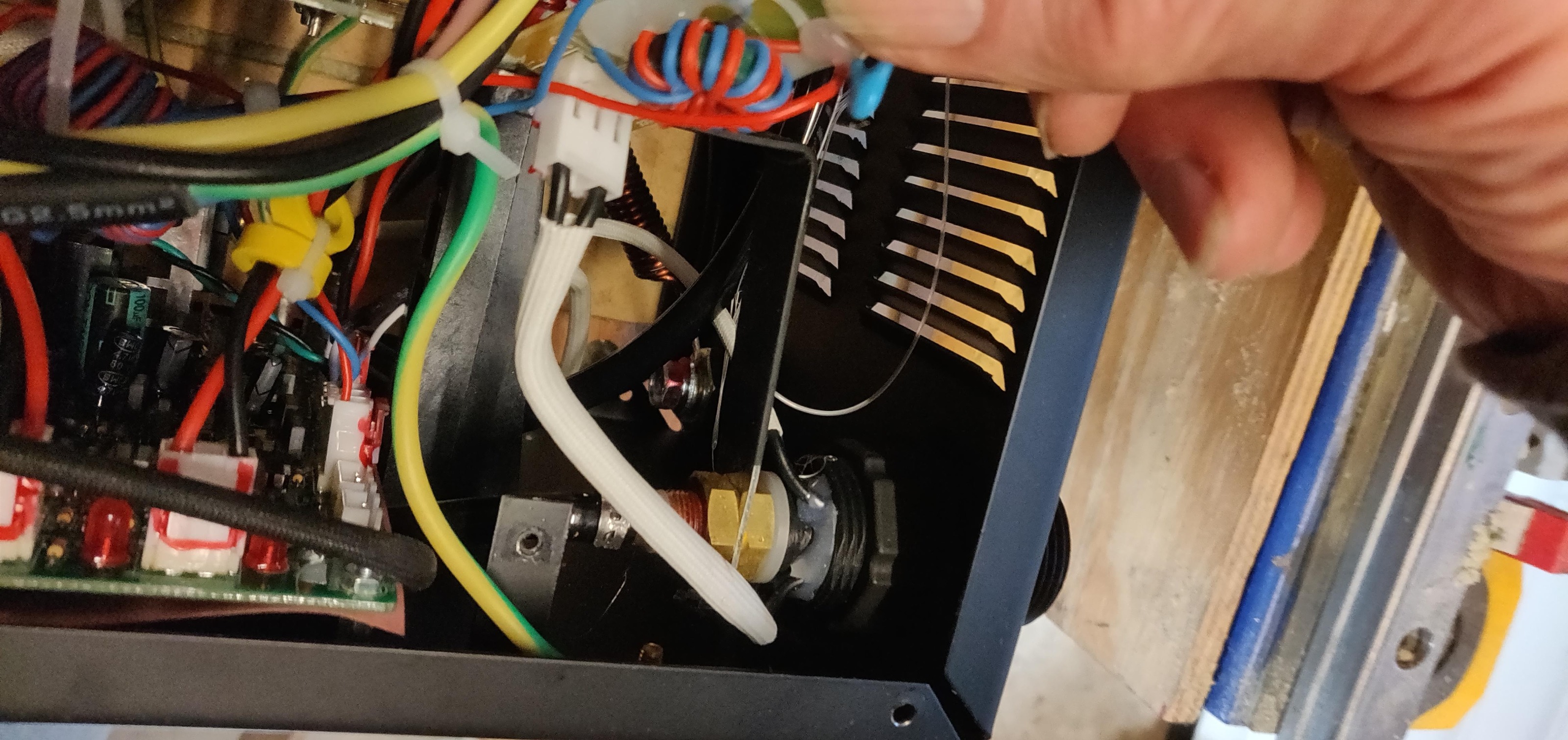

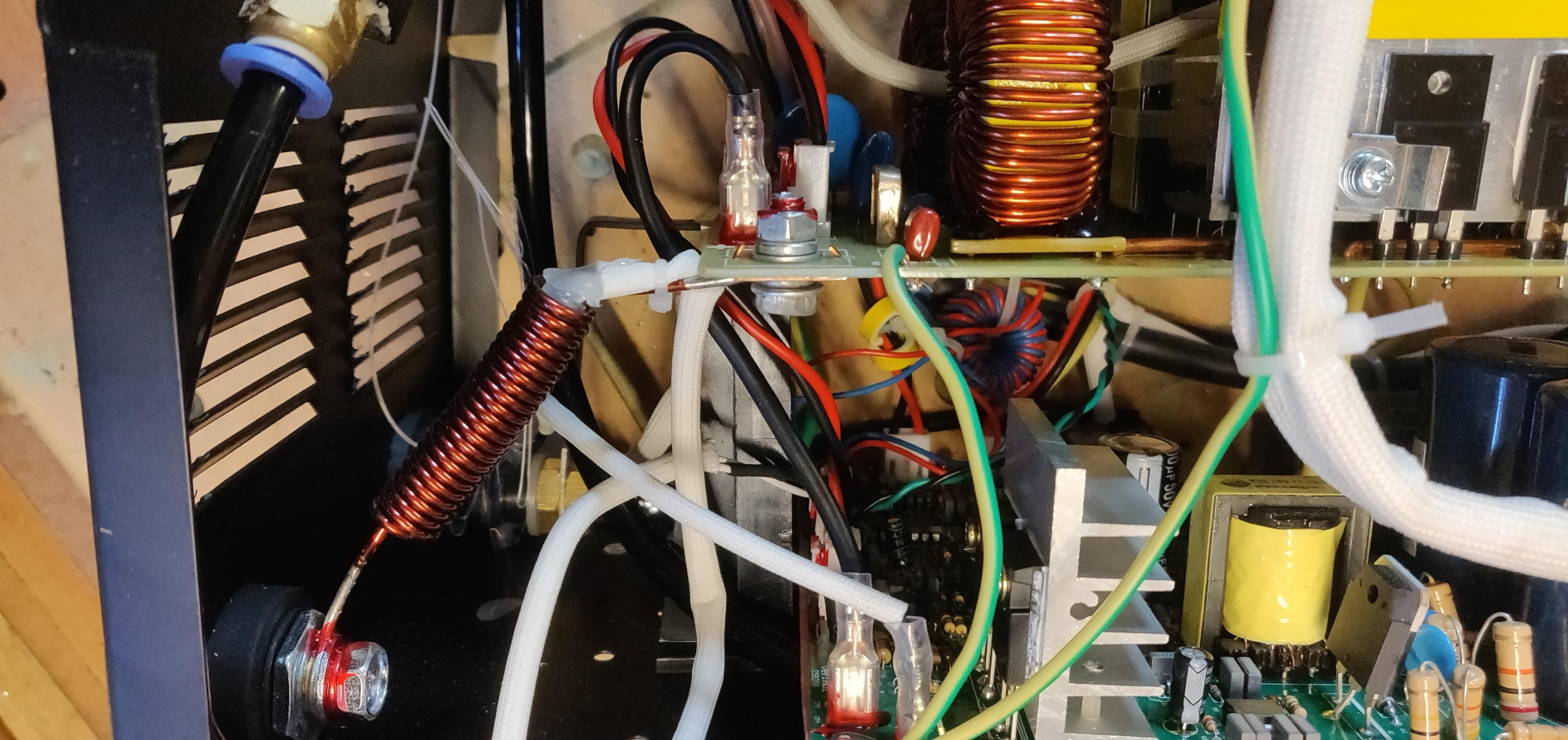

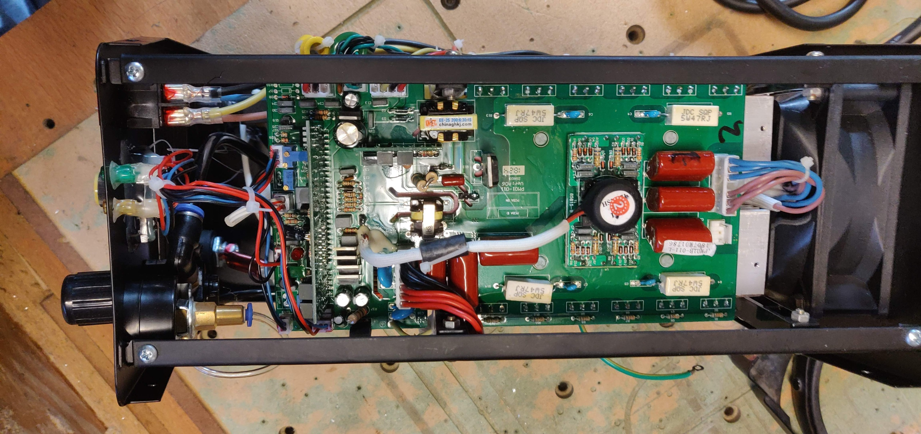

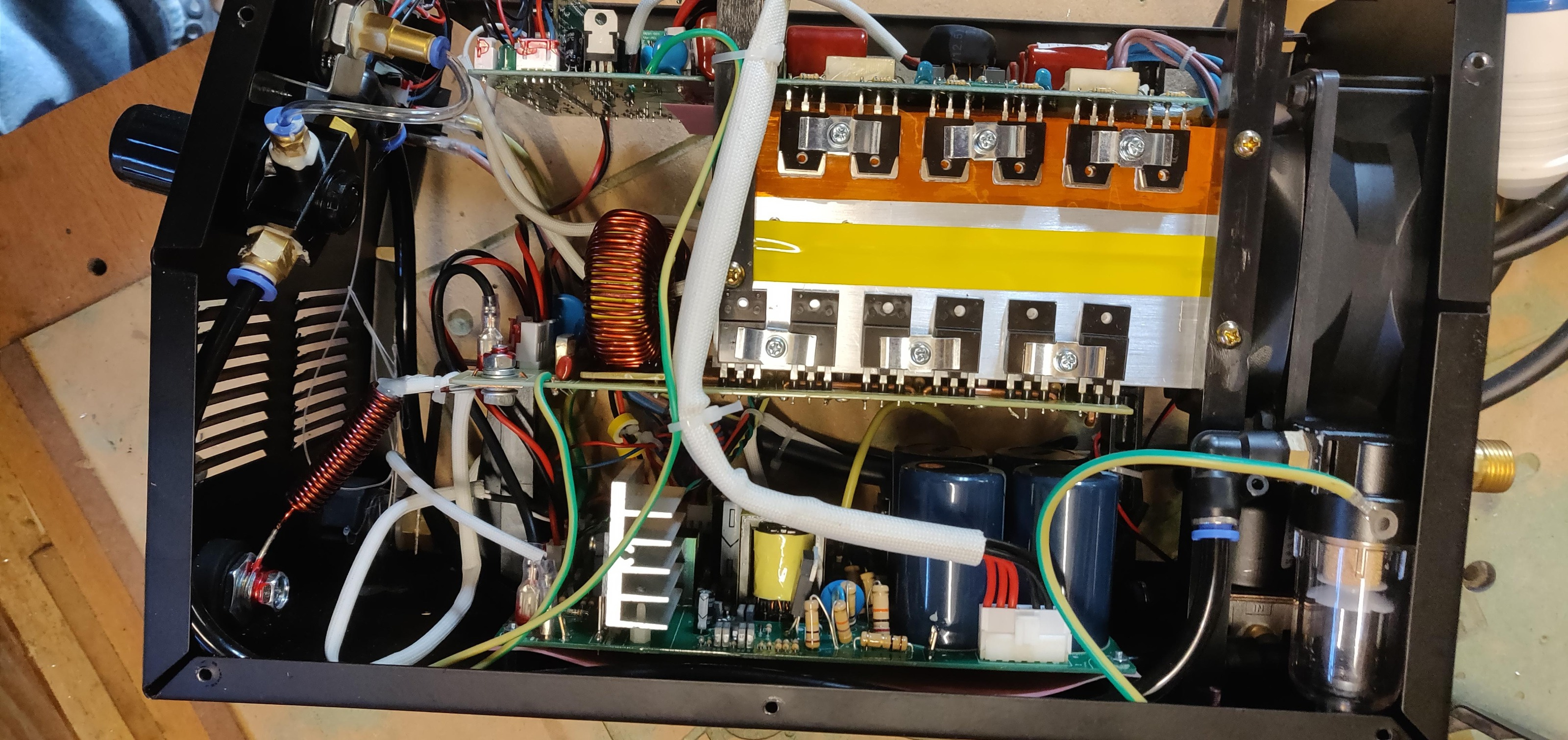

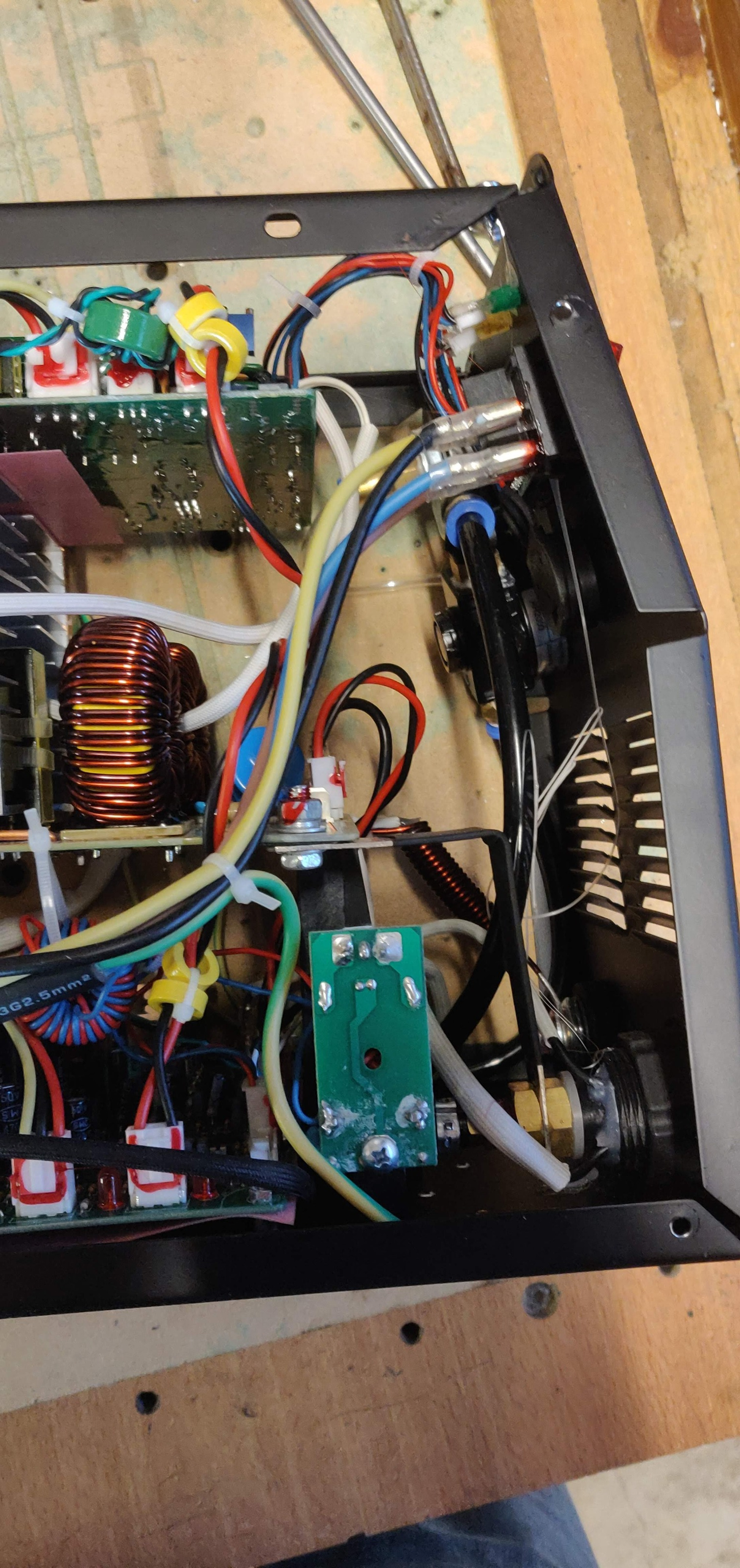

Ok New plasma arrived with pilot arc Cross-Arc www.thewelderswarehouse.com/Welding-Supp...s-Arc-Plasma-40.html .With machine torch
For the THC am I ok to connect on the left side with a 1M R. staight of the terminal on the board with a red mark.
And on the right side with a 1M R to the terminal or the board above the coil marked red on the screw

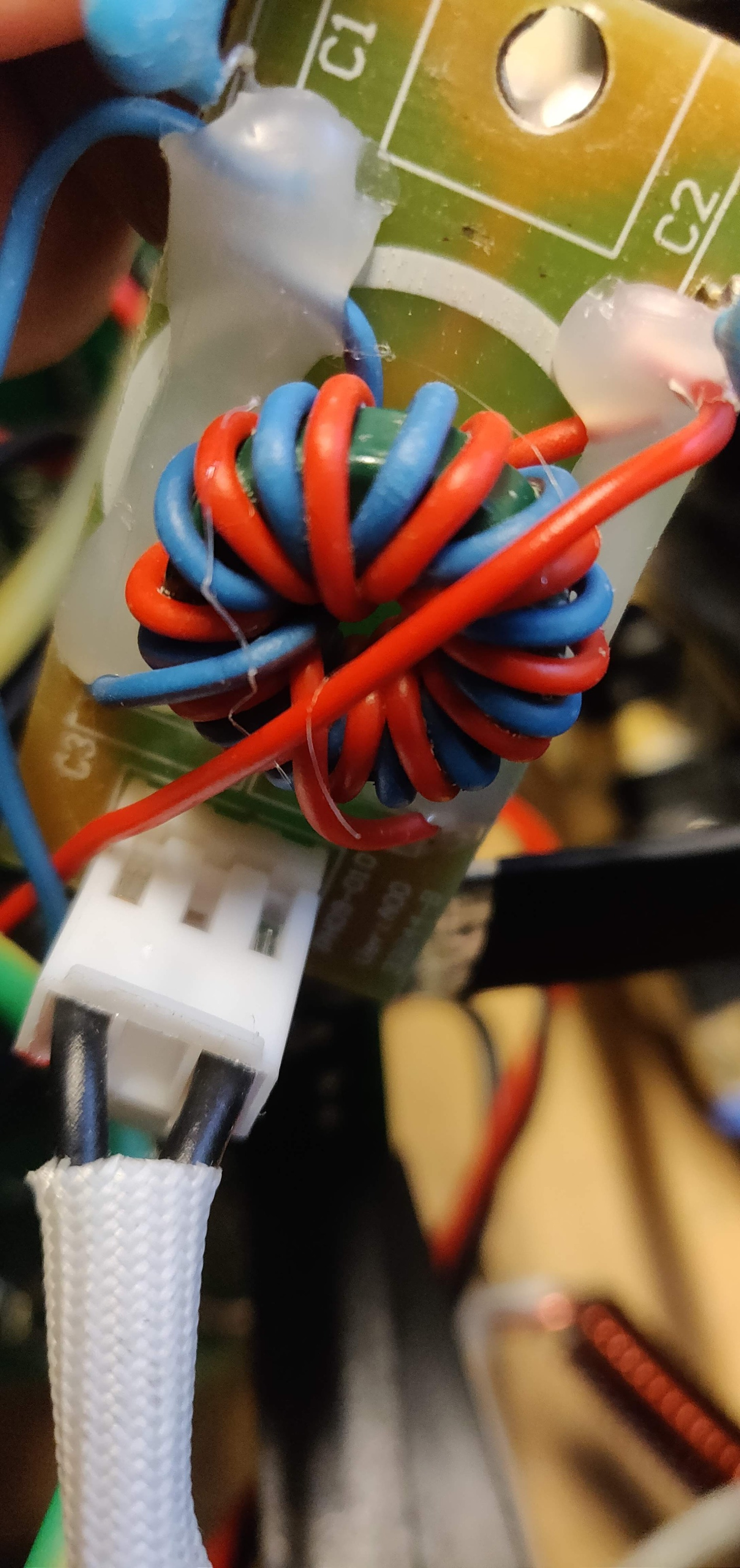

On the "left side 2" picture there is a connector on the left bottom side with red and black wires, can you check with DVM if they are connected to the output terminals ?
that would be best place to take the THC voltage as it has some filtering and make wiring easier.
The small board with a toroidal filter looks like the torch on switch filtering, so that should also make wiring easier.

Thanks for the feedback.
Unfortunately that connector goes from the bottom board to the middle board Right_side.jpg next to the blue cap. but does not connect to the output terminals.
Replied by Clive S on topic New Plasma build question
