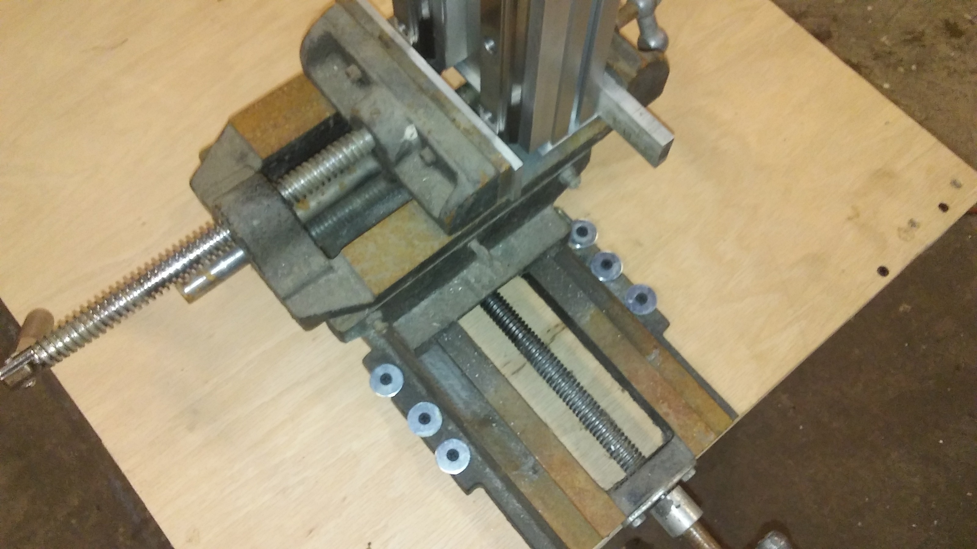

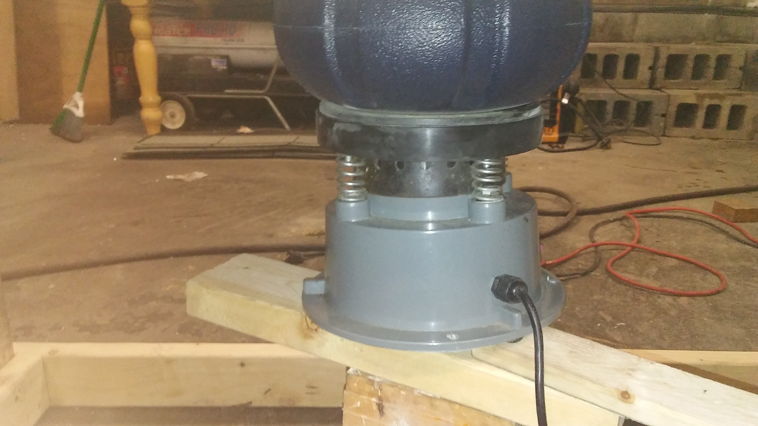

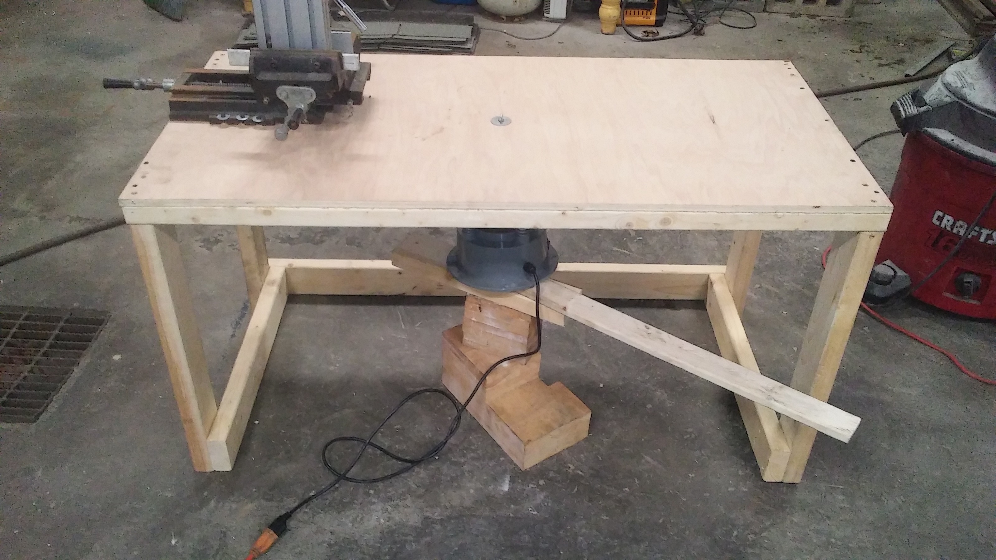

i used a vibrating dry tumbler for a vibration source and built a quick table out of some left over lumber i had laying around. take note of the state of the art anti rotation mounting under the tumbler
much needed to keep the cord from getting wrapped around the tumbler
the sliding vise i just screwed into the table top to hold the extrusion up right and i just used a bubble level to adjust things. with out it you would have to stand around and hold things and that's not something i care to do since it takes a long time before the air gets vibrated out of the mix.

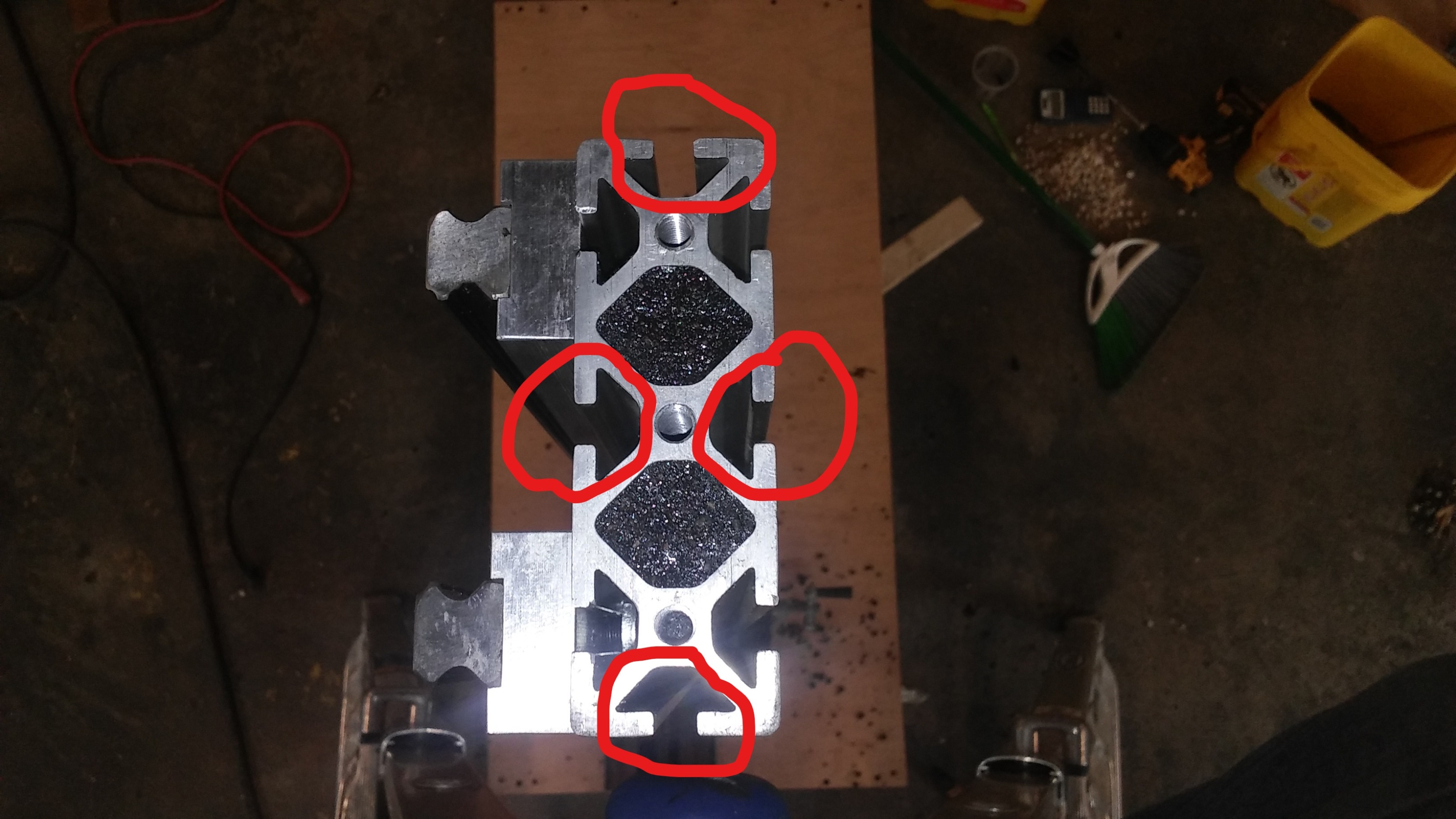

every time i play around with this stuff i am amazed by what it does to dampen vibration. i think i might go a step further and fill in the T slots that i have no need for and block off the ends of the ones i do use and fill the center section that is not used.
i tapped a unfilled section with something metallic and it rang like a tuning fork i did the same on this section i filled the center voids on and taking a educated guess i would say it got reduced by 75% possibly.
if it does as good with deflection i will be a happy camper

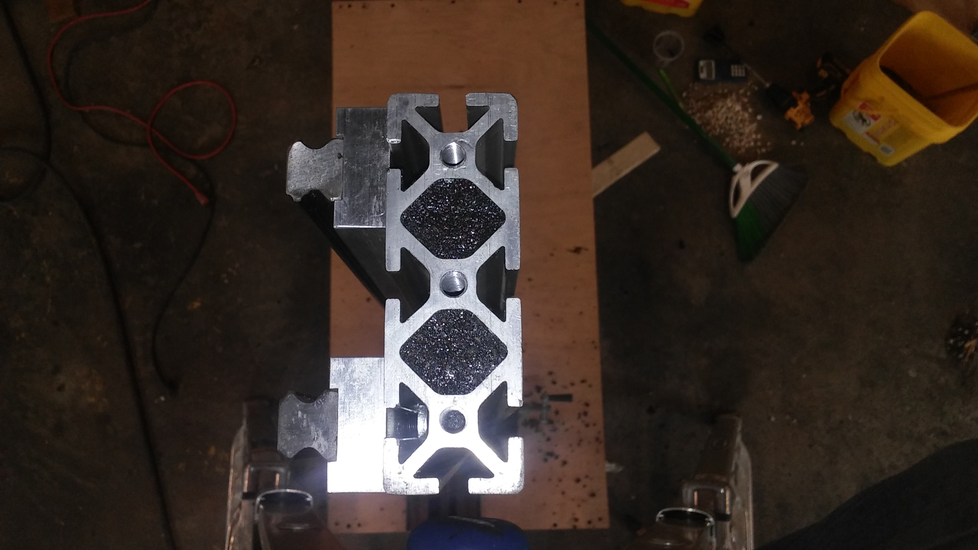

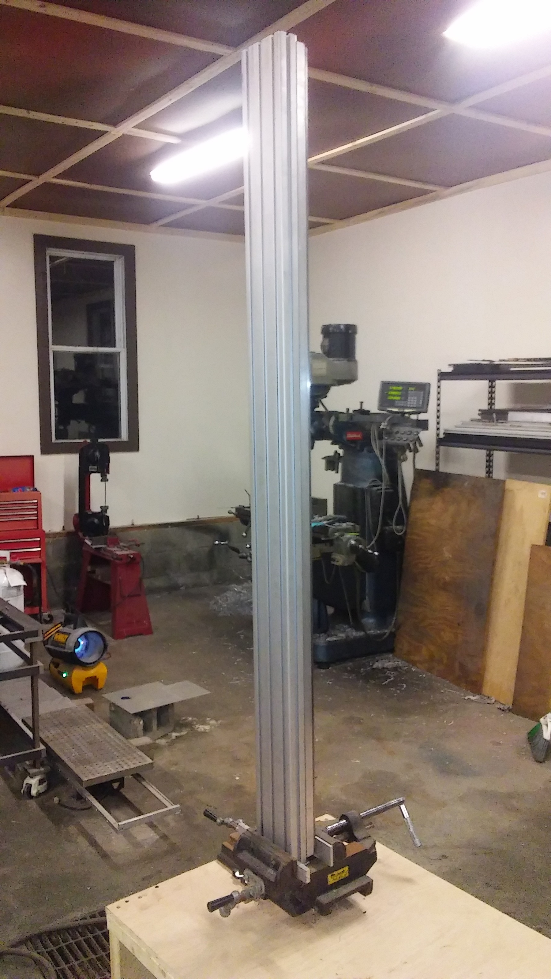

i did some testing with an indicator and it would appear like the deflection is getting smaller by a decent amount but things were off the machine and on the bridgeport for some quick testing. the problem with the extrusion is more of a twisting kind of deflection so i think filling the t slots in the same way will help deal with this.
the down side is every side has to be done and you can only do one at a time and have to wait 24 hours for it to cure and i would be doing 4 sides so this could take some time to nail down for sure.
i was looking at the pictures at work had seen some places i can draw the spindle in closer to the frame and made the one change last night but did not have time to see if that helped any? but at the very least i got back almost an inch of travel
the closer the spindle gets to the rails and blocks takes away some of the mechanical advantage that is aiding in the twisting deflection
the methods i used payed off in the accuracy department as well. over about 6.5 inches i had the squareness stay within .0005 imperial with zero flex where everything was in the vise.

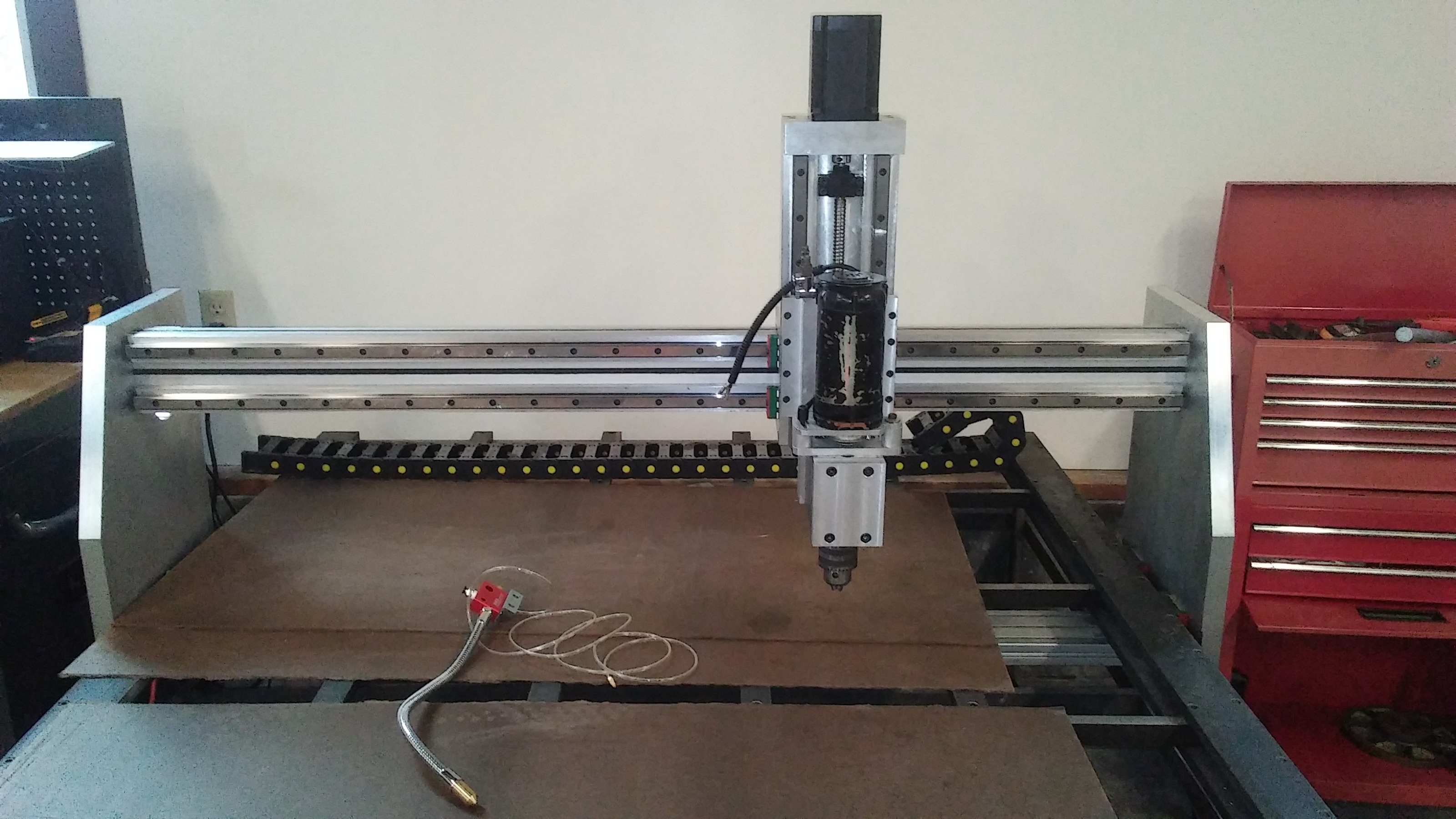

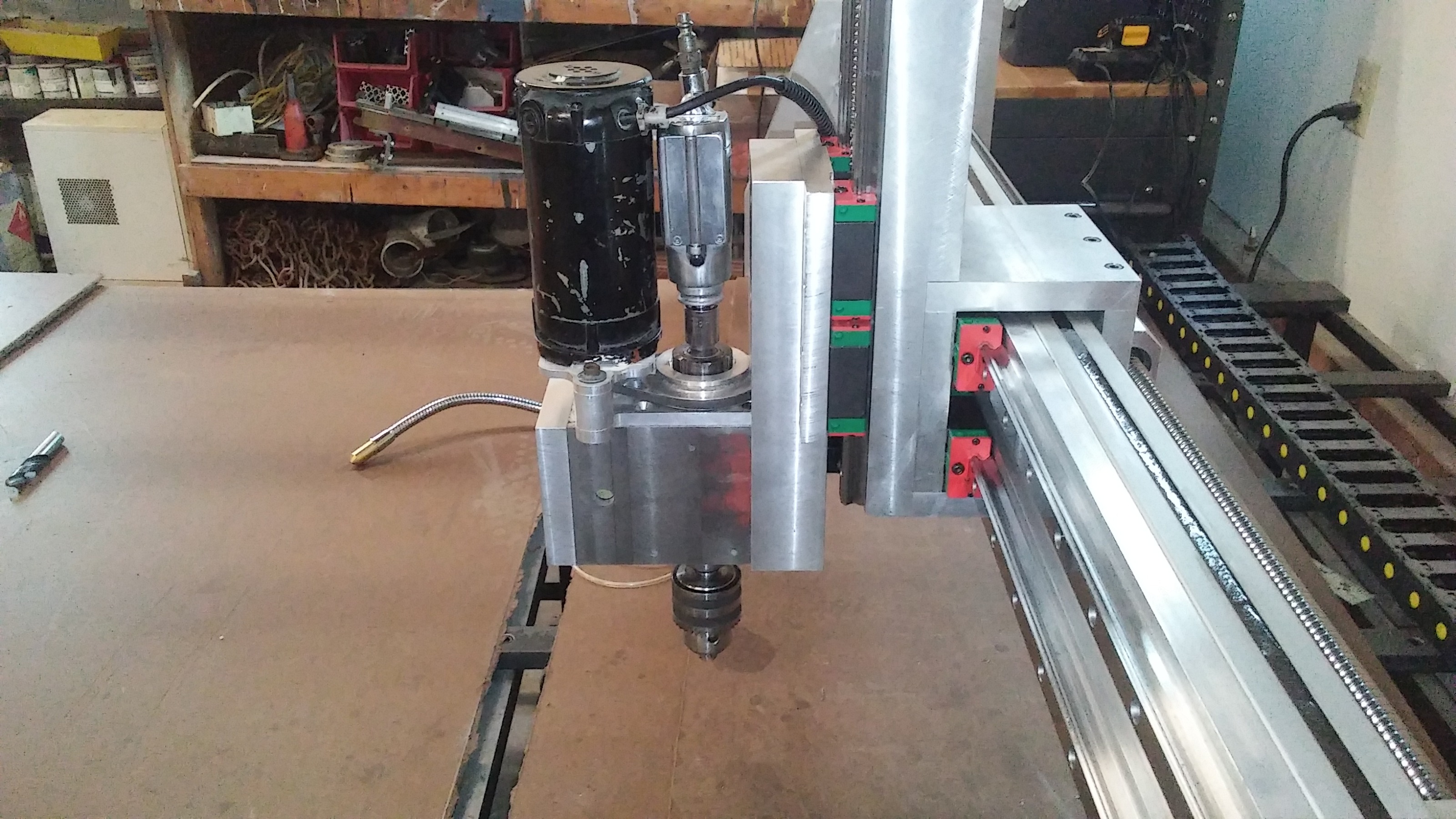

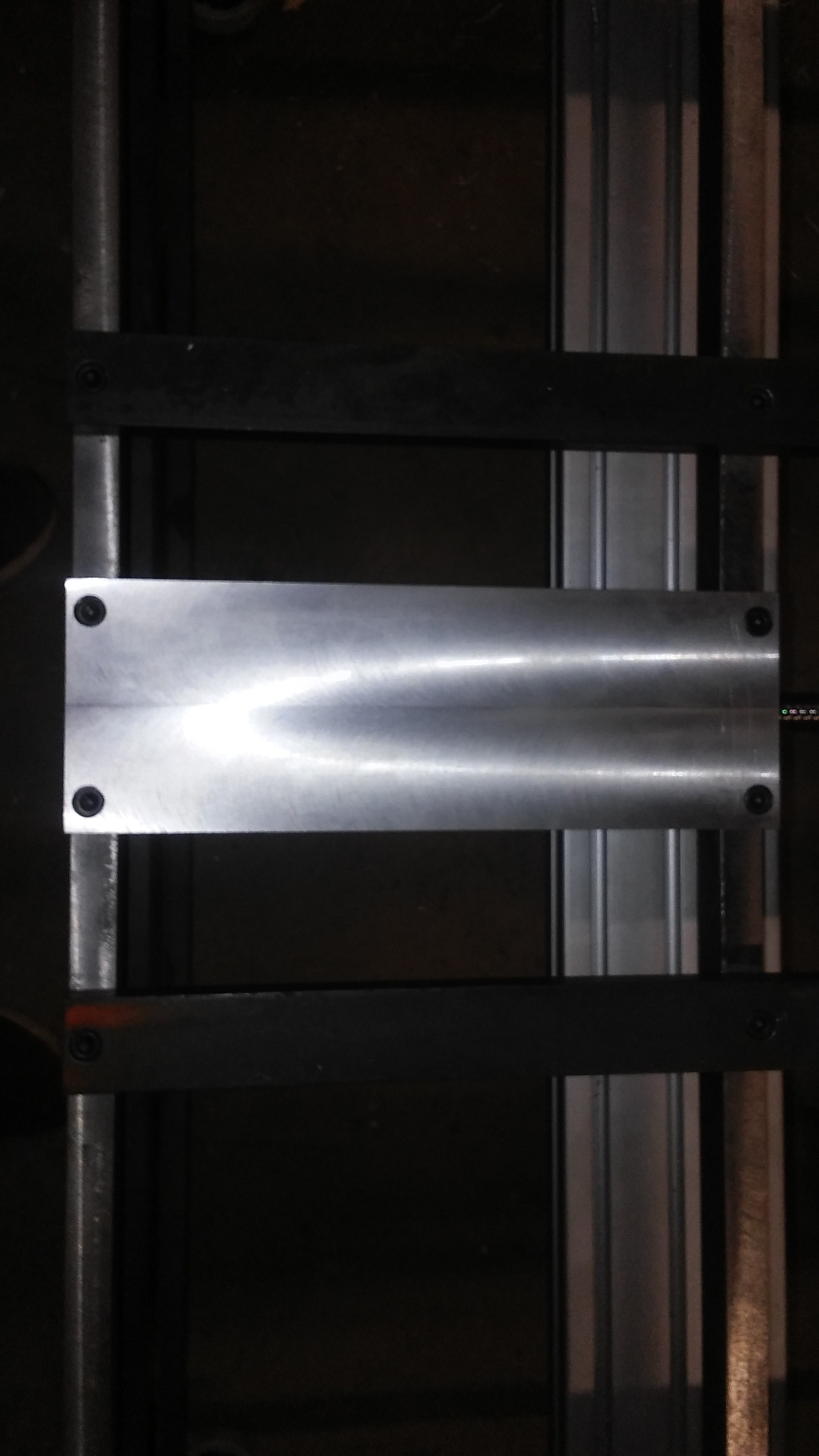

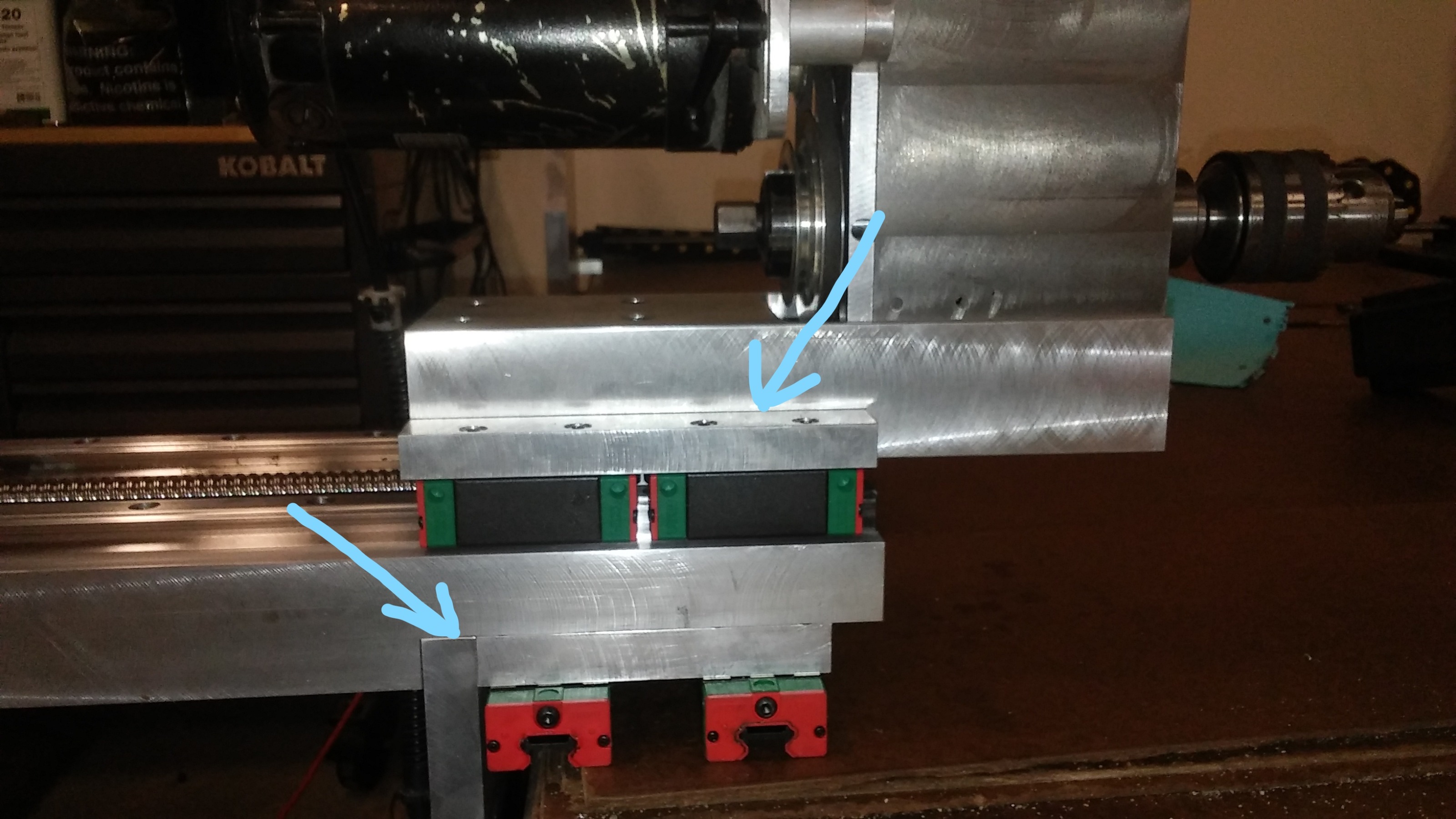

was going to fill a side of the extrusion but the battery in my scale died so i did the other modification on the gantry and Z axis instead. these two changes brought the spindle center line back 1.5 inches in total. so at the very least a gain in travel by that much.
i think i got all i can get now. the plates that mount to the bearing blocks is .750 thick so i was able to cut away that thickness on two parts to bring everything back. since i bolted the plates to the sections i cut away i did not really loose anything by doing so. it just looks more balanced i think.

all this made a big improvement but it still flexes a little bit. i think it's probably around .005 inches at the extreme side of things. i did a check of the same kind on my Bridgeport and got .003 inches on that machine so i'm close to where i need to be i think. only way to see for sure is to get this thing finished and do some test cutting to see how it does? i think with finishing passes it's not going to see the forces needed to move things but that's just my hunch at this point.
i did get up on the gantry in the center and with 200lbs it only moves .005 inched with downward force (downward force being me doing a my best high wire impersonation )
so i think .005 on the push and pull and downward force is probably what to expect on the extreme side of things.

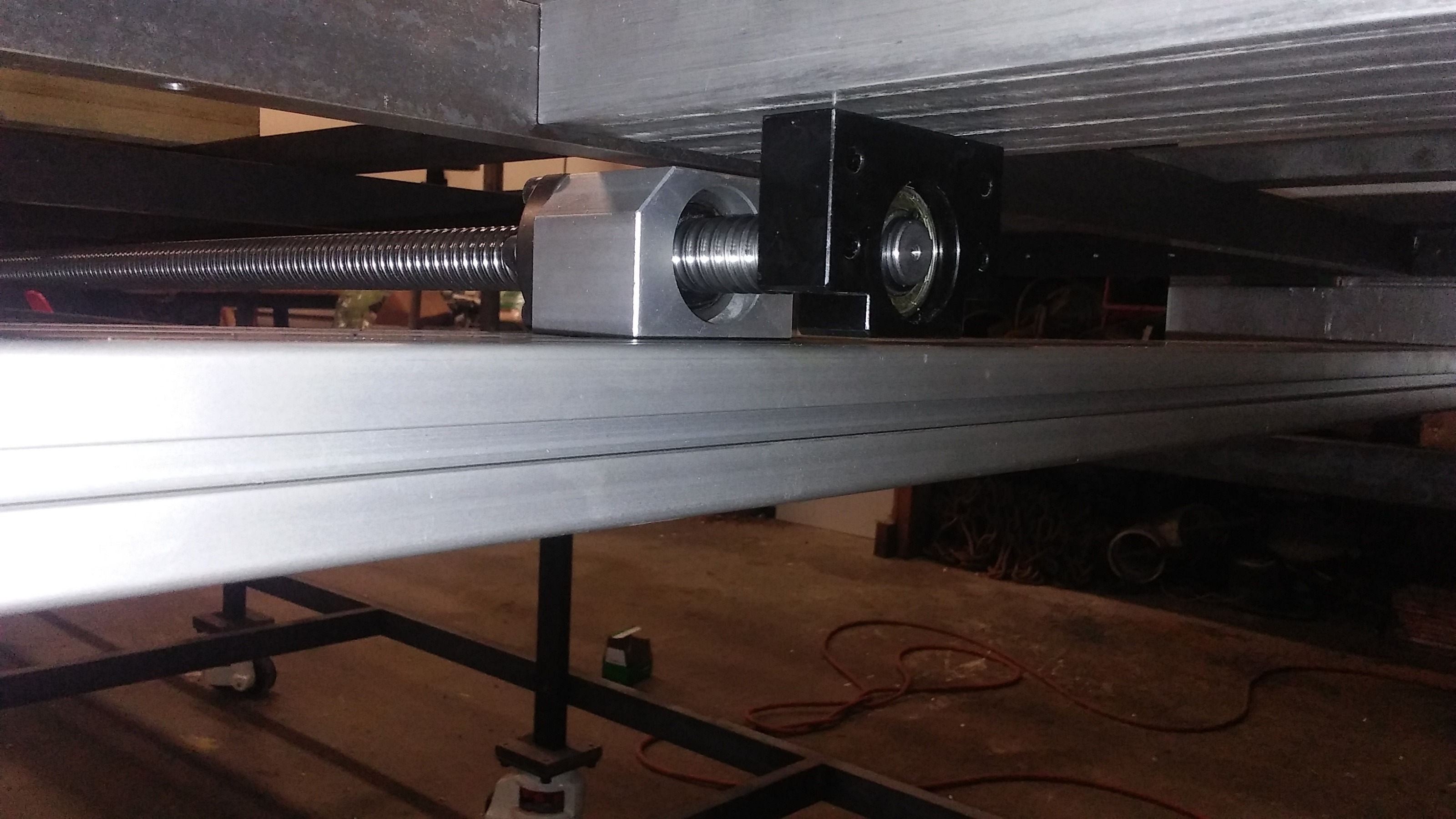

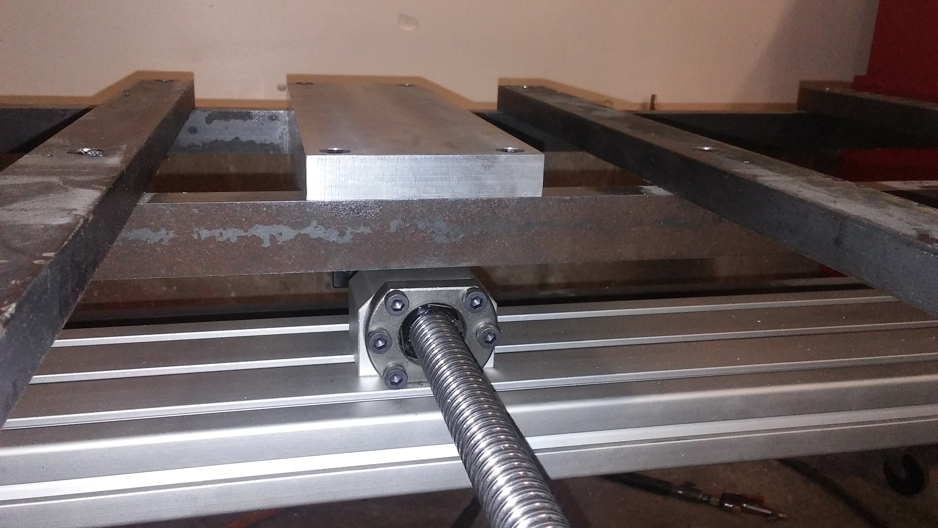

started the ball screw mounting for the 8' axis. i was able to drive the gantry up and down the table with a cordless drill with the clutch set to the lowest setting so you can stop it with your hand super easy. everything works with no troubles. this gantry weighs around 230lbs so not to bad on moving it around.
