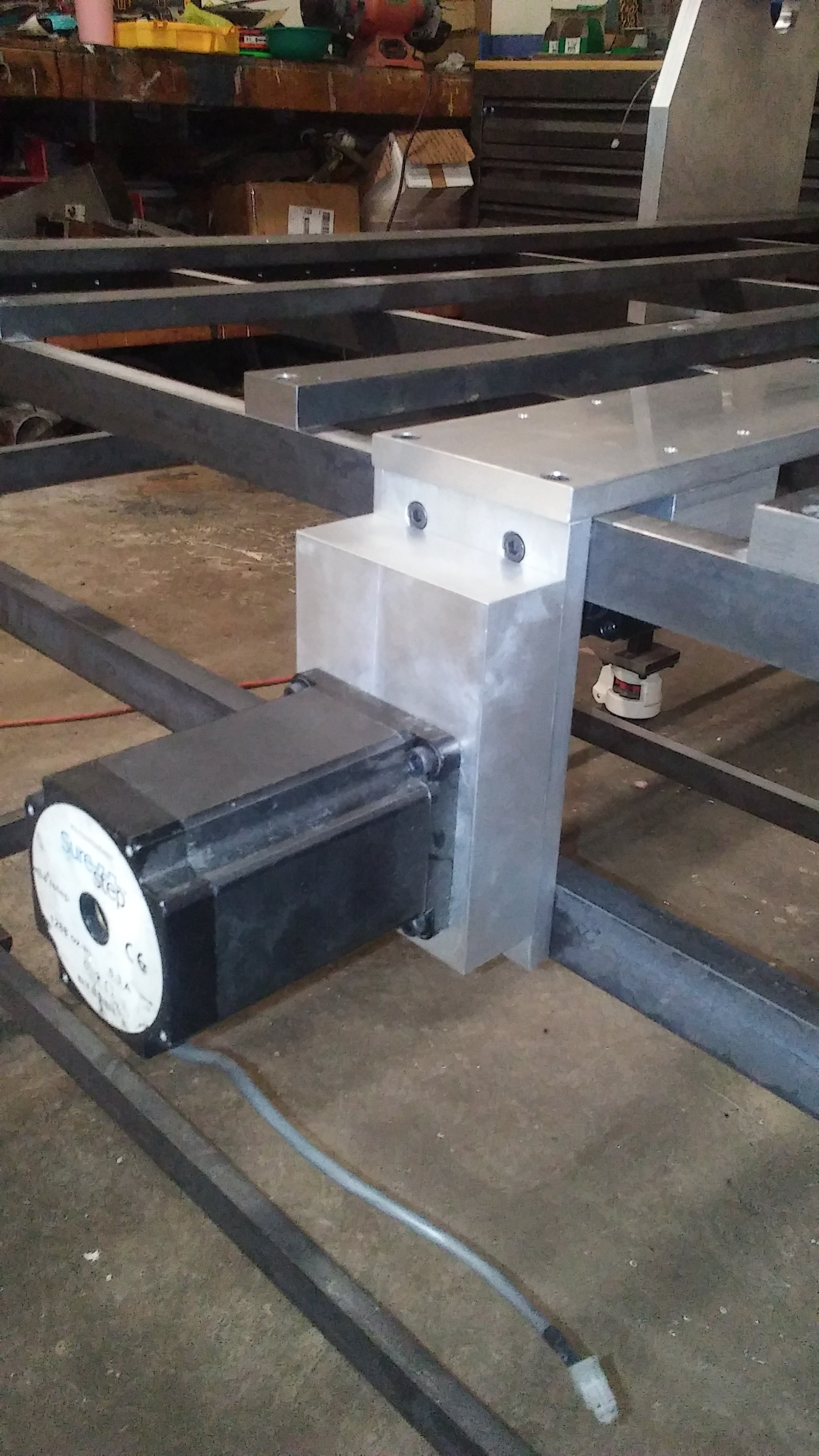

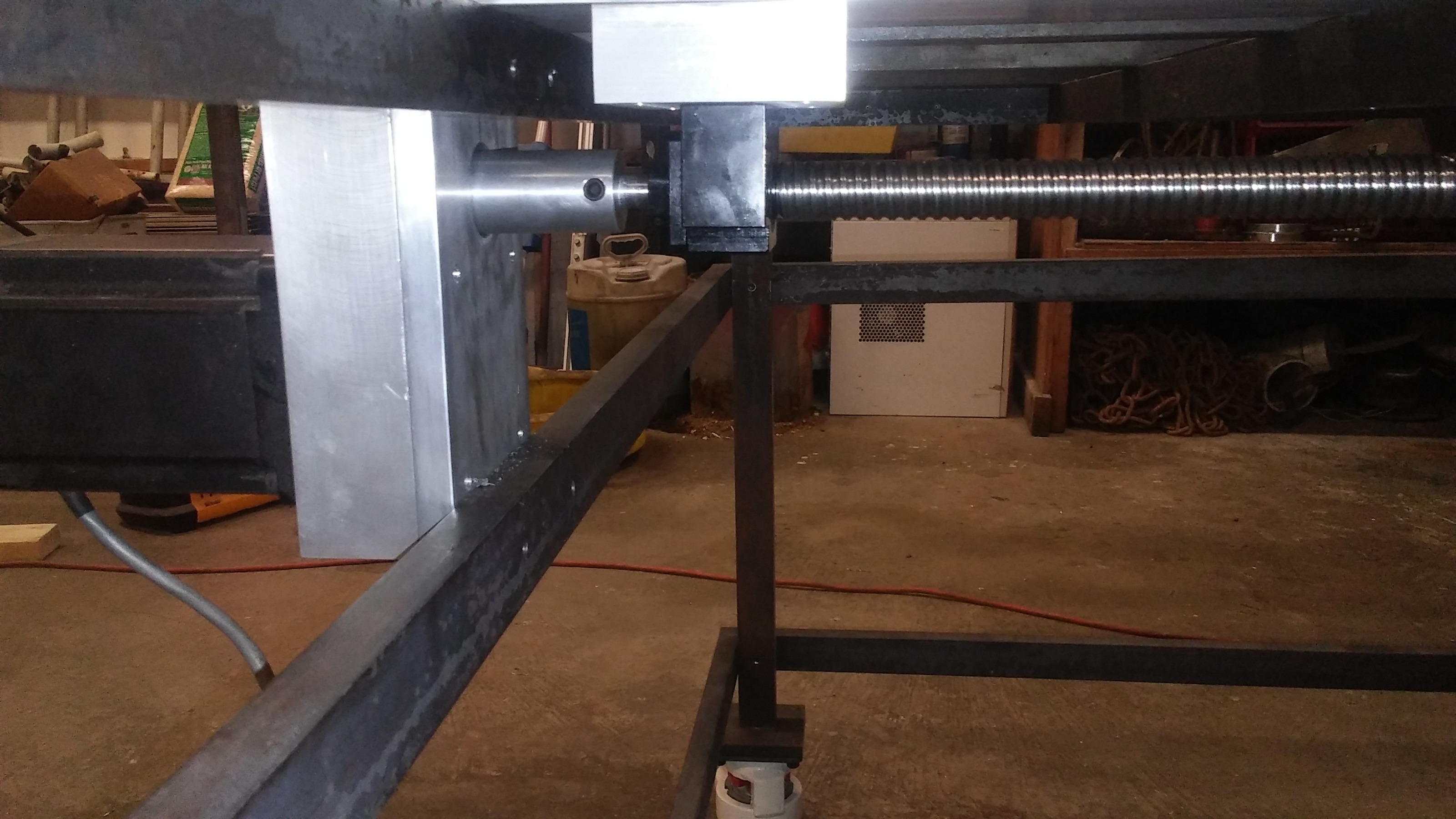

have all the basics finished on all the ball screw drives now so it's back to finish this table skeleton and think about how to frame stuff in so i can do some more Epoxy Granite on the table frame. i just pulled the trigger on a large order of Epoxy for the task. this should make for a good solid machine base. then the last major thing will be the table top. This project is over budget already

i feel like i'm casing after my ultimate build to date
8 months later but starting to see the light at the end of the tunnel at least.
